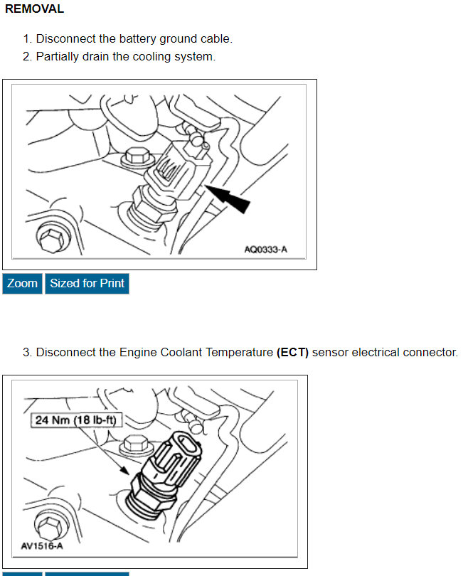

  • 55,694 POSTS
It sounds like you have a problem with the engine coolant temperature sensor which when off a little will cause this problem and not trigger a check engine light. Here is a guide to help you see what you are in for when doing the job:
https://www.2carpros.com/articles/coolant-temperature-sensor-cts-replacement
Here is the location for your car (below). Please let us know what happens.
