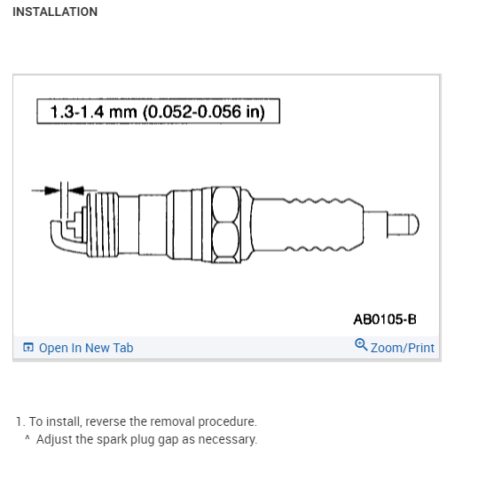

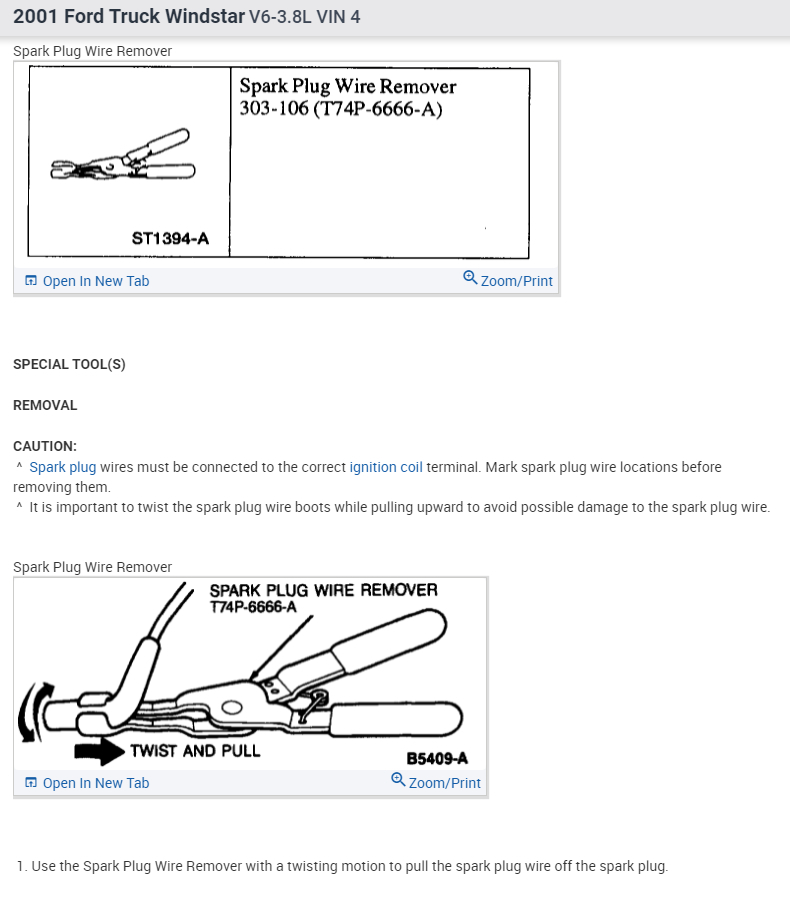

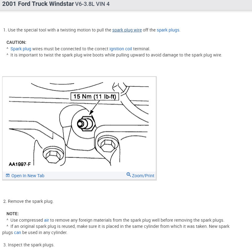

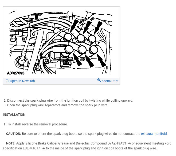

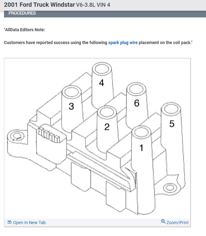

how can i change the spark plugs and cables?? its really hard to reach the back ones!!
Dec 6, 2008 at 8:57 AM
SQM
  • 6,383 POSTS
Replacing the plugs on the back side is challenging.
However, there is no special trick to change those. You will have to use a long enough extension and a U joint.
This will help with reaching the back of the plug.
Also, it is a good idea to use a spark plug wire removal tool.
https://www.2carpros.com/articles/how-to-change-spark-plugs
