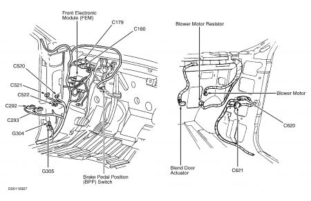

BMRFIXIT
  • 19,053 POSTS
if your engine temp is normal thermostat and all tested ok its a common problem the blend door motor behind right side of dash
https://images.2carpros.com/forum/automotive_pictures/99387_wind_blend_door_1.jpg

BMRFIXIT
  • 19,053 POSTS
[quote:fe2460ed51="cristina"]Thank you very much for your quick response. Is there any way that you can also tell me where to find the blend door so that I can make sure that it is not broken as well. Since everything else seems to be falling apart with the heater.
Thank You, Thank You, Thank You[/quote:fe2460ed51]
check the wiring diagram up
right side of dash
some have it almost behind the radio and ashtray
it has a square plug wires

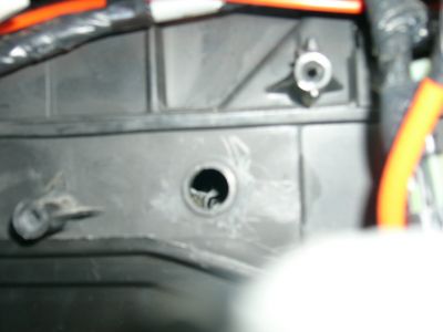

CRISTINA
  • 9 POSTS
Finally able to get a picture of my blend door to show you. I was comparing it to some of the fixes shown for the nail fix but mine doesn't look the same.

BMRFIXIT
  • 19,053 POSTS
check your PM
i answered you PM
