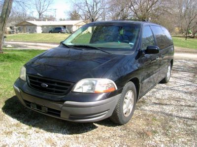

Hi I am a very unhappy owner of a 1999 ford windstar. In the last year since I have owned it, it has had nothing but problems with the speedometer, odometer, transmission, cruise control, and brake system. I am beginning to wonder if this recent recall from oct. 2009 is the blame for it? If you could please let me know what problems could arise if the speed control deactivation switch was to stop working. Any of the problems mentioned could be the result of it? Thank you, any info would be great into considering discussing before I take my van in to have the inspection/repairs of the recall. [img:44742b6f81]http://www.2carpros.com/forum/automotive_pictures/478891_l_4b7debe79d61479a893d9ac473d670ff_1.jpg[/img:44742b6f81]
