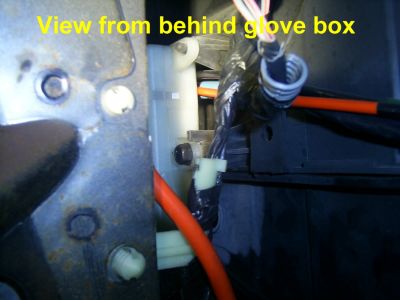

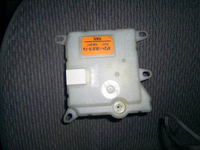

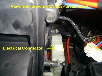

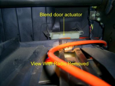

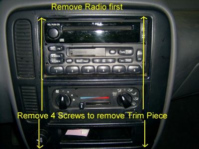

I have done my troubleshooting and have found the actuator motor good but the heater door is broken.
I need to remove the dashboard to get access to the plenum.
I would really appreciate any step by step instructions for dash removal and replacement and special tools needed.
Many thanks!
Feb 1, 2009 at 12:08 AM
KHLOW2008
  • 41,812 POSTS
Hi garyakohl, Thank you for the donation. The faulty blend door actuator seems to be a rather common occurrence and to remove it, there is no necessity to remove the dash board. Concern: No hot air from HVAC. Clicking noise from dash area. Fan Speeds work normal.   Suspect: Electric blend door actuator, Common problem that many techs have seen before.   Repair: Remove radio ( special U shaped tool required Part # Unknown) Or other techs have used metal shirt hangers. Remove radio and A/C Heater Control head. (4 screws 2 at top of radio 2 at either side of ashtray) If van has aftermarket radio and you can not get the radio out easily, you can remove by swinging down glove box and removing 1 screw there and the 2 others screws from drives side brake and gas pedal area. See attached pictures. Remove 3 screws securing   Blend door actuator.
