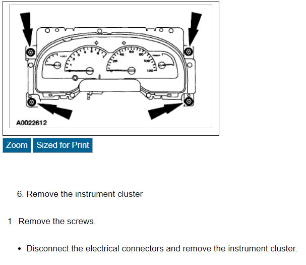

The dash gauges (speedometer, tachometer, temperature and gas) in my van have suddenly started going crazy crazy. I have owned it for two years and it had happened once or twice in that time. They would all "top out" and then quickly return to normal. I did not give it much thought after that. Recently they have started doing it constantly but now they will "stick" in different positions (i.E. 0, 40 or 120+ mph gas full, empty or half etc.) And they continue to bounce around. Usually the tachometer and speedometer together and the temperature and fuel together, sometimes all four. Can you please give me some indication where to start or am I looking at a more serious problem that I should not be doing myself?

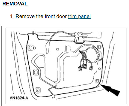

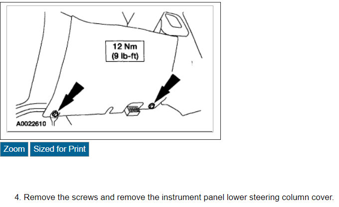

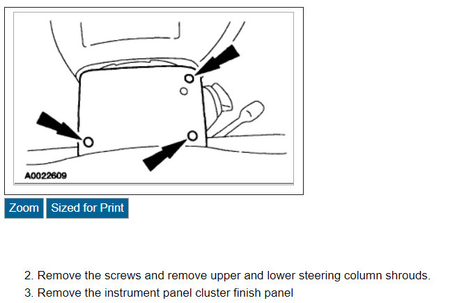

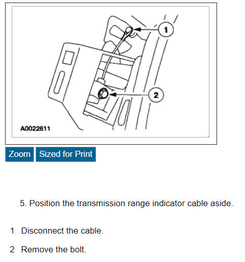

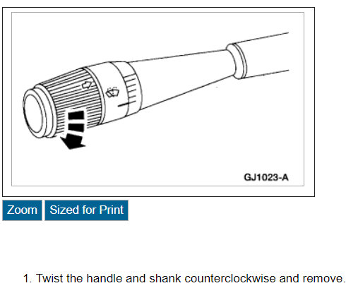

It sounds like there is bad/loose solder joints inside the cluster. I would remove the cluster and replace it with a used or new one. Here is a video of the job being done with diagrams below to help you with your car.
https://youtu.be/_HEC44xENxw
Here is how it is done on your car.
Cheers

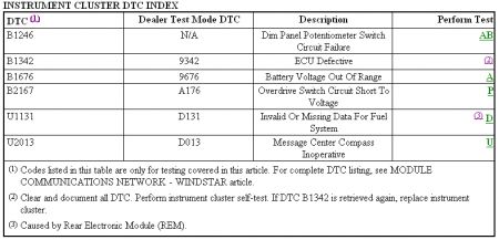

I performed the dealer test on the instrument cluster as described (this is spot on by the way) and I pulled five DTC codes from the instrument cluster. They do not correspond to the "normal" DTC codes (Pxxxx, Bxxxx, Cxxxx or Uxxxx) Can anyone help?
Here are the codes that I pulled from the dash:
dtc 9249
dtc 9676
dtc 9470
dtcd262
dtc 9246
Thanks,

The only one I can find is 9676= Battery voltage out of range. Fix this first and retest, will probably correct the proble, "no communication with cluster"

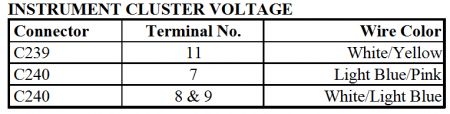

TEST A: NO COMMUNICATION WITH INSTRUMENT CLUSTER 1. Turn ignition switch to OFF position. Disconnect instrument cluster 22-pin harness connector C239, and 20-pin harness connector C240. Turn ignition switch to ON position. Measure voltage between specified instrument cluster harness connector terminals and ground. See INSTRUMENT CLUSTER VOLTAGE table. If all readings are 10 volts or more, go to next step. If any reading is less than 10 volts, repair circuit.

2. Turn ignition switch to OFF position. Measure resistance between instrument cluster harness connector C240 terminal No. 12 (Black wire) and ground. If resistance is less than 5 ohms, repair module communication concern. See MODULE COMMUNICATIONS NETWORK - WINDSTAR article. If resistance is 5 ohms or more, repair open or poor connection in Black wire to ground connector G304, located behind left kick panel.
