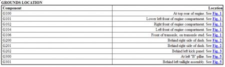

It does have an ignition module, Your engine size is V6 but I need you to get the correct size, 3.0 or 3.8? It's on the engine, and the white lable under the hood. Here's the locations of ALL control Mods, also the grounds in your case are important to check. Especially the PCM ground, front of engine bay Black/white stripe, I think!
https://images.2carpros.com/forum/automotive_pictures/62217_Winstar3_1.jpg
https://images.2carpros.com/forum/automotive_pictures/62217_windstar_Grounds_1.jpg

Drive to autozone, they will read the codes for you, with the speedo problem and ABS lets find out if the VSS(vehicle speed sensor) is bad.
