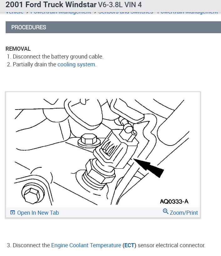

I want to know where the temperature sensor is located on this vehicle. I checked the relays that control the cooling fans and they are okay. The mechanic suggested that it might be the temperature sensor by the top radiator hose that may be the problem. It is a $17.00 part and I want to try to replace it myself. If you think it could be something other than a temperature sensor, your input and expertise would be greatly appreciated.
Mar 6, 2008 at 4:41 AM
  • 75,992 POSTS

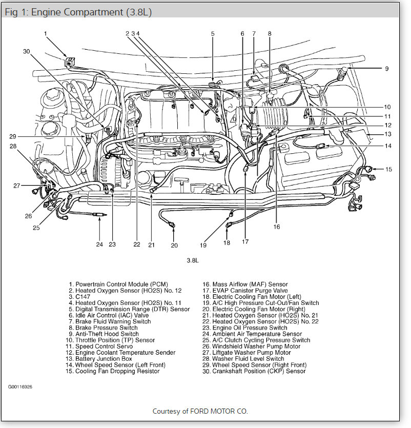

Here is a guide the help you change it out the the coolant sensor location along with engine diagrams to show you where everything is.
https://www.2carpros.com/articles/coolant-temperature-sensor-cts-replacement
The engine coolant temperature sender is located at the no.12 see below
Cheers
Mar 6, 2008 at 5:15 AM
