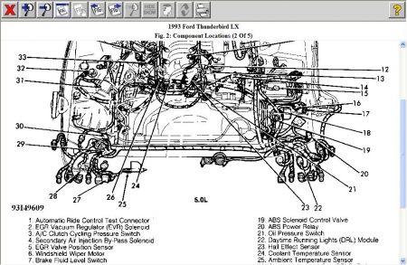

It has an ICM instead of the EDIS located at item no.27 see below
https://images.2carpros.com/forum/automotive_pictures/12900_icm_1.jpg
