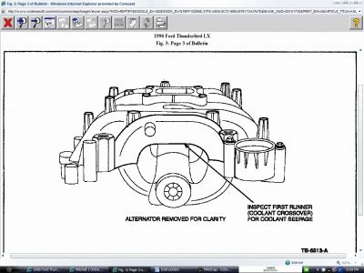

It could also be the area involved in a tech buliten...4.6 2V enginges leak coolant at the crossover of the intake manifolds...
https://images.2carpros.com/forum/automotive_pictures/62217_Location_1.jpg
This shows the weak spot...

If the manifold hasn't been done yet, give it a feel for moisture evey now and then...good luck.
