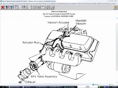

When my car is in park it's pretty loud. When i put it in drive it gets quieter but then louder and faster when i accelerate. It sounds like a pencil being tapped on a desk. From what I can tell, it sounds like the noise is coming from right below the driver seat. It's not from the engine itself. It is a very consistent tick. I had my exhaust system inspected and no leaks were found. Any ideas?
Thanks
Feb 22, 2008 at 4:51 PM
MERLIN2021
  • 17,250 POSTS

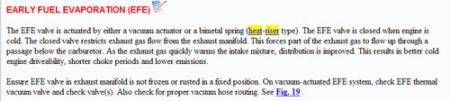

Check the EFE valve, it's between the exhaust manifold, and the Y-pipe, it has a butterlfy in it and it may have rusted so it now flaps inside....
