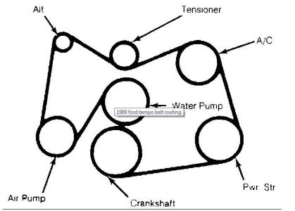

1989 Ford Tempo 4 cyl Automatic
I HAVE A BROKEN SERPENTINE BELT AND NEED A DIAGRAM OF HOW TO PUT IT BACK ON. I AM A PARTIALLY DISABLED WOMAN WHO TRIES TO DO THE REPAIRS MYSELF, IT IS HARD ENOUGH TO PAY FOR THE PARTS, SO IF YOU COULD PLEASE PROVIDE ME WITH A DIAGRAM I WOULD BE ETERNALLY GRATEFUL.
THANK YOU
JOANN

https://www.2carpros.com/forum/automotive_pictures/266999_tempo2_1.jpg
https://www.2carpros.com/forum/automotive_pictures/266999_tempo_1.jpg
If these diagrams do not look like your engine configaration check this link www.2carpros.com/car_repair_information/tec_info/1989/ford/tempo/1989_ford_tempo_drive_belt_routing_diagram.htm
