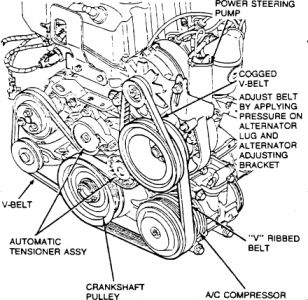

hello, i have a 1990 ford tempo gl and i am currently replacing the power steering pump. it tells me to remove the serpentine drive belt but then it says i need a special tool to release the tensioner. and on top of that i cant even find where i am supposed to release it at. if you could please help i would greatly appreciate it thanx justin alderman

Fig. 15 Serpentine Drive Belt Routing
https://images.2carpros.com/forum/automotive_pictures/12900_belt_8.jpg
Removal Loosen adjustment, pivot and idler pulley bolts on accessories which need belts replaced. Remove old belts. Installation Install new belts over pulleys. For V-ribbed belts, ensure that all V-grooves make proper contact with pulley. Adjust belt tension.

per the picture above the automatic tensioner looks like it pushes down on belt to tighten. there is usually a hole in the arm for a breaker bar to insert so you can pull up on it. you can also use a ratchet wrench as they have the same connecting stud. if no hole is present then you can sometimes use the bolt head on the wheel to put a wrench on and lift. the assembly itself is a spring loaded swing arm with a wheel on the belt end.
