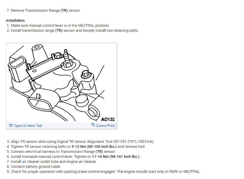

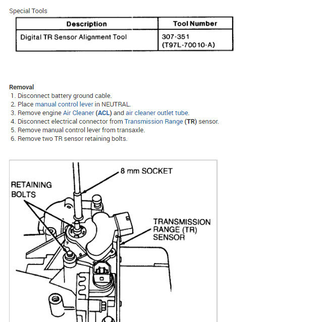

Ok so 3 weeks ago had new tranny put in by my mechanic. Took her home and now my radio sound goes off when I put her in R. Goes right back on in any other gear. Now about 1000 miles later, when I get up to 50-60 mph, my rpms stay at about 4000-5000, then whenever she feels like it will go back down to normal opperating rpms. Next day after this problem started my check engine soon light came on and is staying on. And now today my door ajar light is on, will not go off and my interior light is staying on when doors are shut and car is off. Took out light bulb so the light is off. So my questions are, 1-is all of this realited? 2- how do I go about fixing my door ajar thing?? And 3- by taking the light bulb out from the dome, is the car still gonna draw power and kill my battery until I get it fixed??? Sorry so long. Thanks in advance -Jodi

Put the bulb back in.
The problem with the door ajar is probably easily corrected by spraying a light lubricant into the LATCH of the doors, WD-40 would work. Start on the driver's door if that's what you use most. After spraying it good, open and close the door 10-20 times.
Not sure on the CEL, need to get the codes checked from the pcm to help.
Suggested Repair
Reinstall the dome bulb. Lubricate the door latches, starting with the driver's door, and cycle the door 10-20 times. Have the transmission shop check and adjust the manual lever position switch (neutral safety switch) on top of the transmission, and scan the PCM for codes related to the high-RPM shifting problem.
