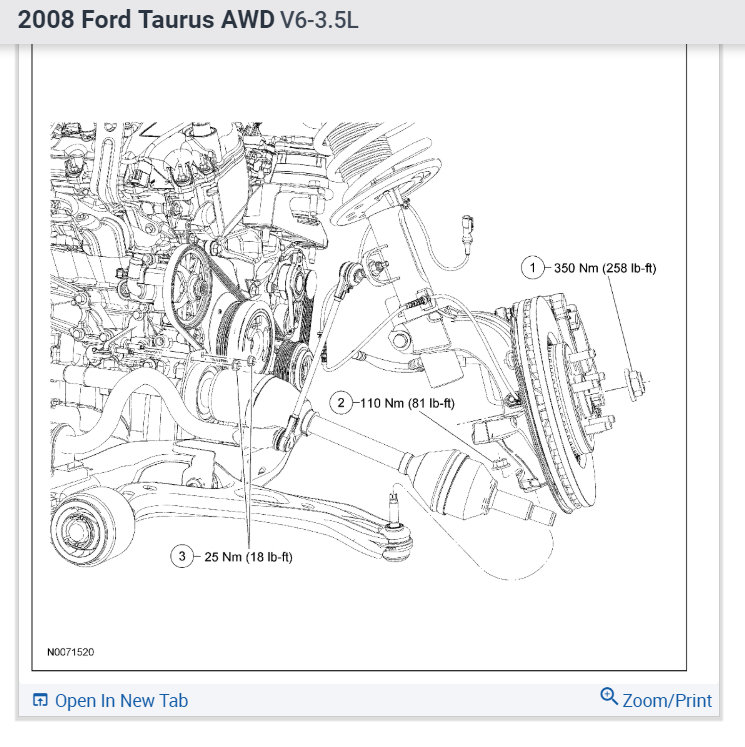

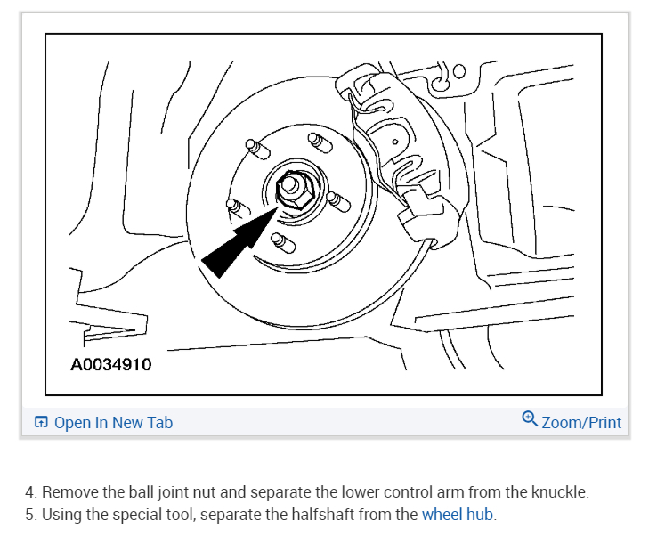

When I turn the steering wheel there is a loud clicking noise. The dealer said "they all do that". Is this repairable?
Jul 14, 2009 at 6:06 AM
MHPAUTOS
  • 31,937 POSTS
Hi

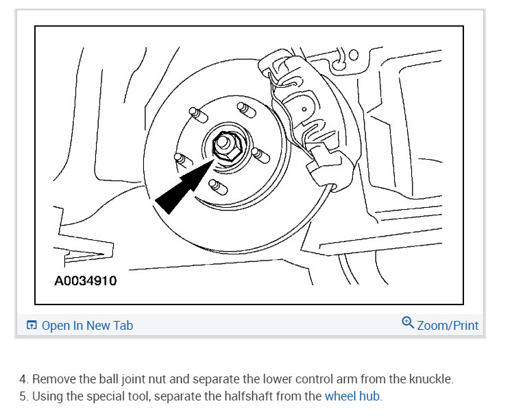

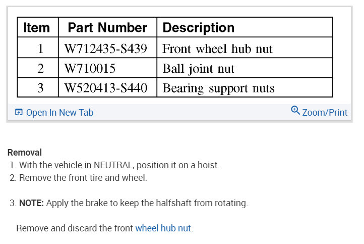

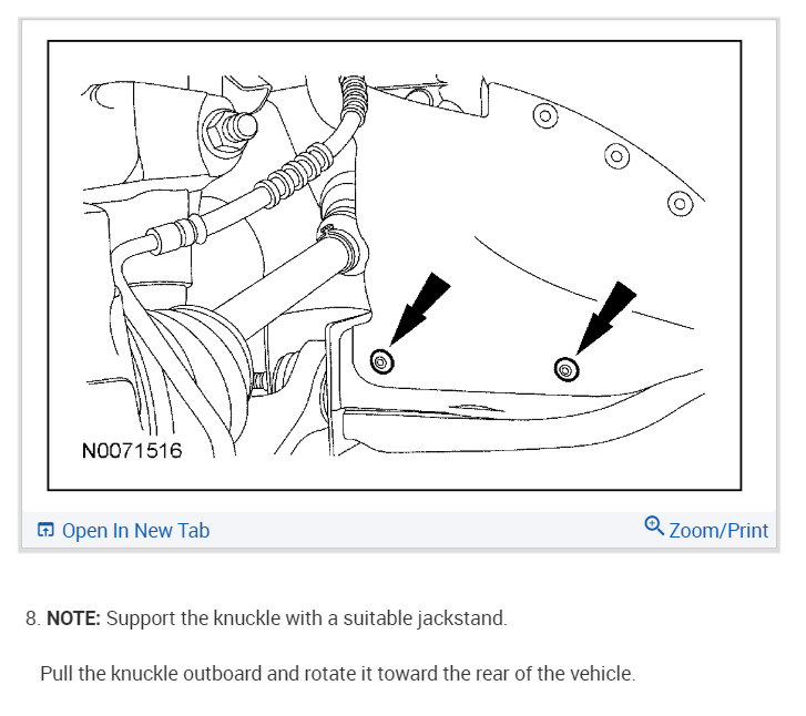

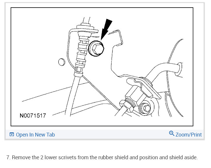

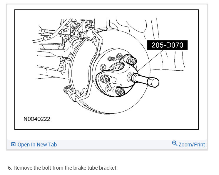

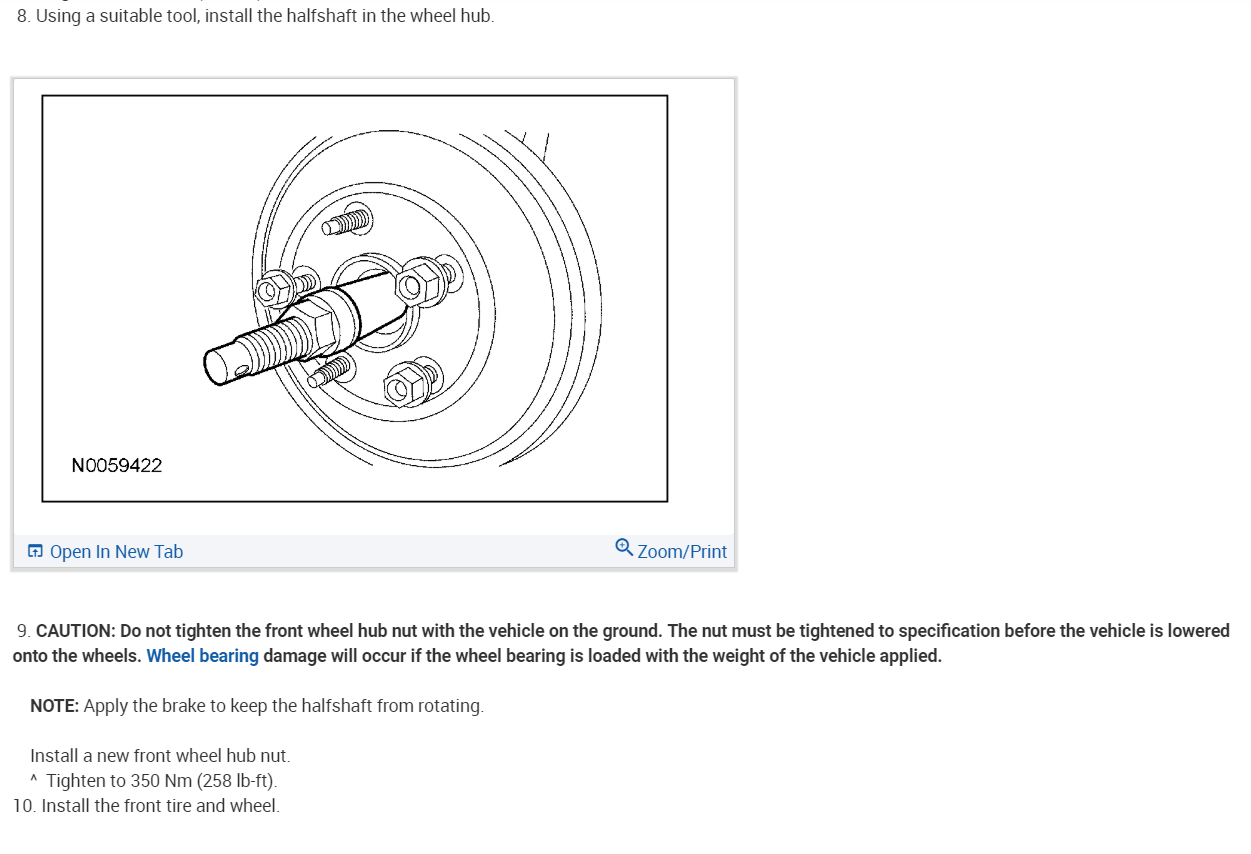

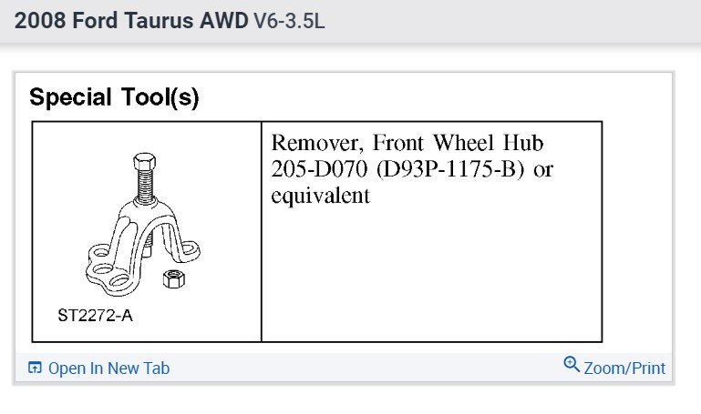

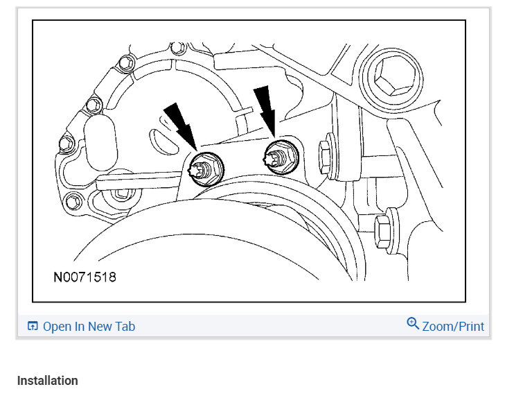

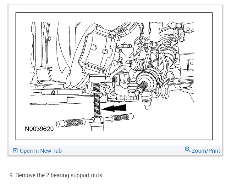

This will be faulty drive shaft CV joints here is a guide to help you see what to do to repair the car with diagrams below to show you how on your car.
https://www.2carpros.com/articles/replace-cv-axle
Check out the diagrams (Below). Please let us know if you need anything else to get the problem fixed. Mark (mhpautos)

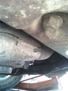

Every time i hit the gas or brakes there is a loud click in the front of my car, almost sounds like im running over a fragile stick. Car shop said not to worry about ig but damn its annoying. Also the car pulses and surges a lot. It stalls. Especially when i go uphill. Ive had the fuel pump replaced, ran fuel injector cleaner through it, changed the fuel filter and spark plugs. Its in the shop getting the coil packs replaced now. What do i do for both of these?

First, does the noise change when making turns? And if the shop said "don't worry about it" did they say what caused it? Like you, it would drive me crazy, and you and I both know it isn't normal. My first guess would be CV joints. Did they check them? You can do it. In a parking area, turn the steering all the way left or right. See if it gets worse, and let me know.

K i got it back from the shop and the coil pack was the stalling prob. The spark plugs were overloading it.
The loud noise is still there. What exactly am i looking for when i check the cv joints? The shop couldnt figure it out. When i turn while parked it doesnt click but grinds a little, like a vacuum. Mainly the only time it acts abnormal is while driving. Ill hit the gas and it sounds kinda like its clickin into place. The same when i hit the brakes. Only its very loud and sounds as if its coming from the front right tire. What are the best ways to check the cv joints?

The easiest way to check is to drive in a circle to see if the sound gets worse. Also, I want you to check the backing plate behind the rotor to see if it is rusted or bent allowing it to rub the rotor.

vhecked the cv joints and that's not it, but we noticed on the undercarriage that one of the bolts holding it up was bent back. it looks like the aframe is pushing it back when accel or decel, causing a clunk. i plan on jacking up the frame to relieve the pressure on it, hammering the bolt lightly back to straight, putting a washer on, and finally tightening the bolt back up. i'll let you know how it goes. thanx for all of this. ive included a pic of the bent one, although it might be difficult to see.

THe picture is fine. However, I can't tell what it is holding. Is that a body mount?

Yes it is and that turned out to be the problem. Thank you for all of the help and ill be back if i need any other assistance. Thank you.
