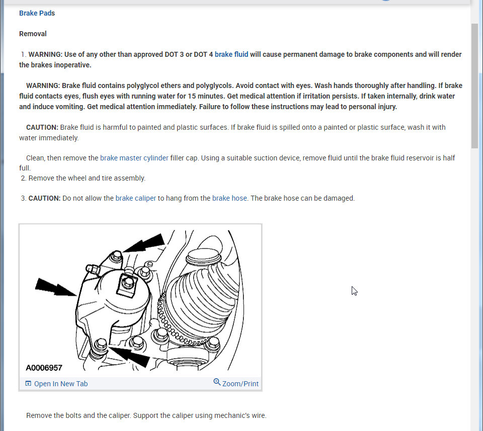

I have tried to read a few posts, but they keep on drifting away from what my exact problems are so I am going to post a question of my own. I bought this car at 60k used from a private owner and the car is in great condition, but I noticed a few problems from the get go. I have driven it 10k miles now and no significant problems, but I would like to replace the front brakes to keep it in good shape.

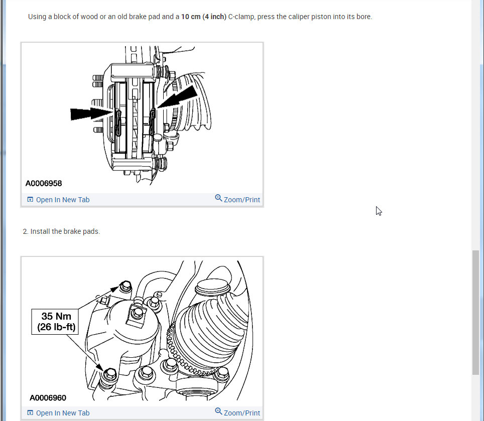

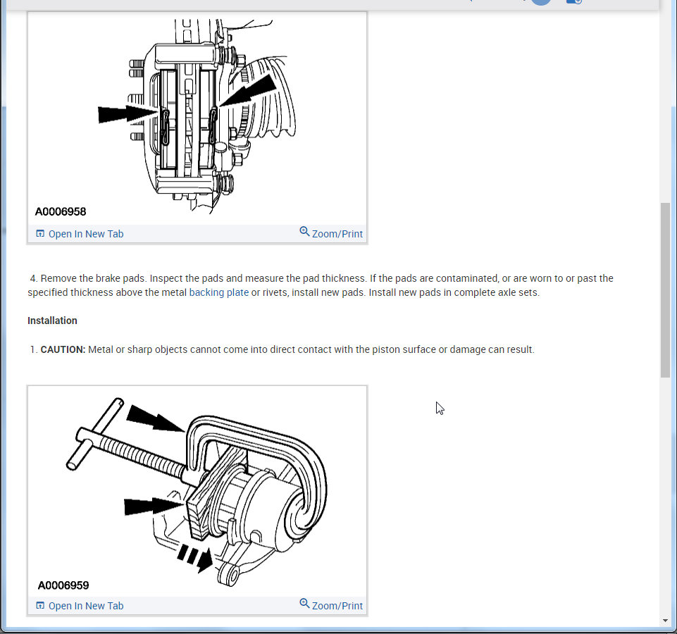

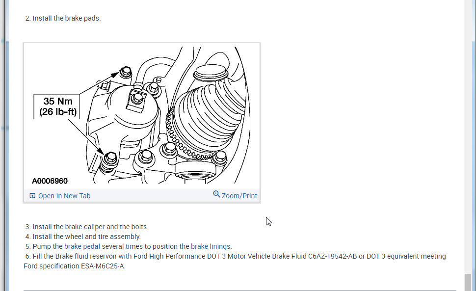

Below is the process on how to replace the brakes from the manual. Let us know if you have other questions. Thanks
