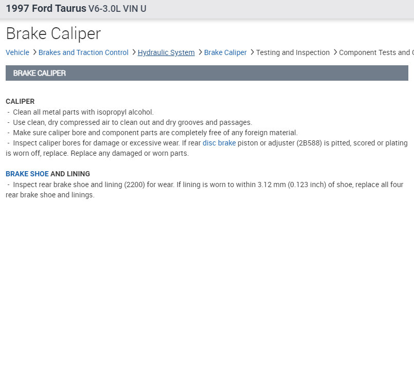

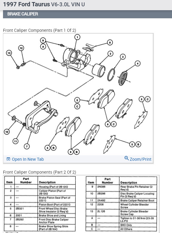

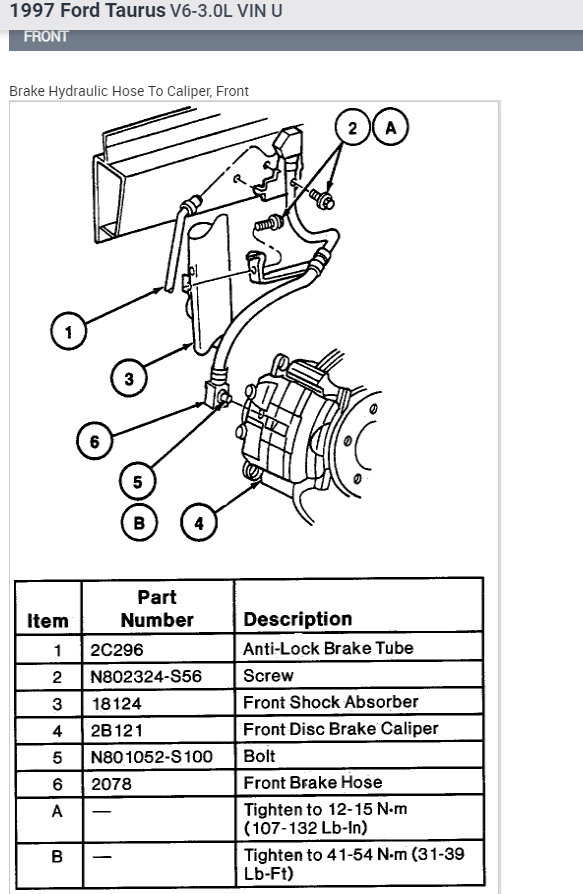

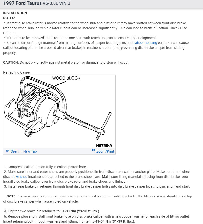

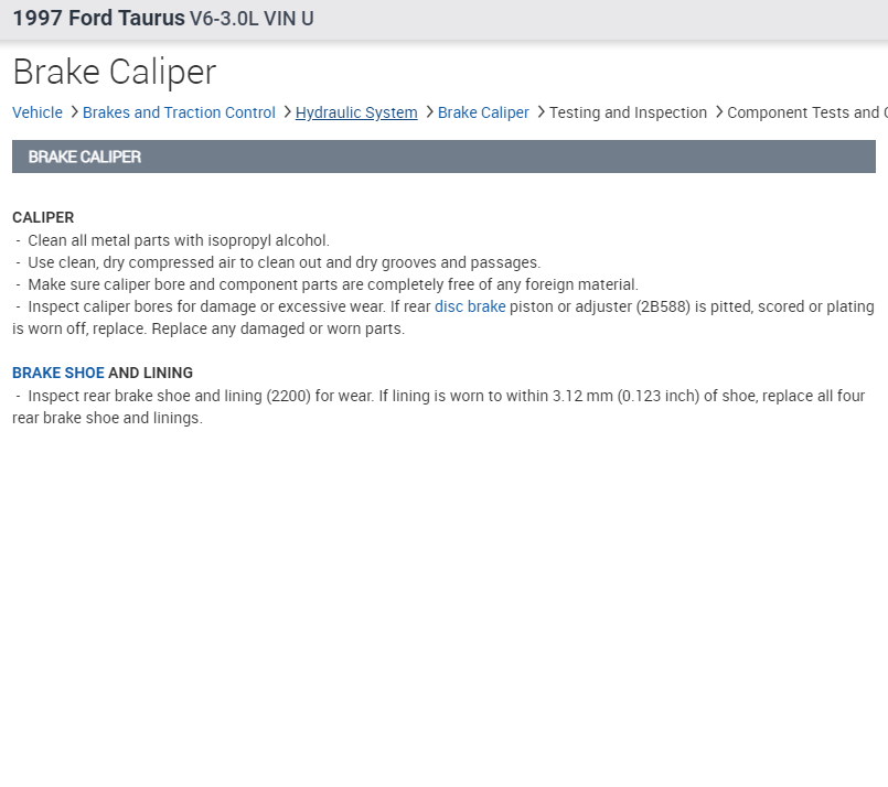

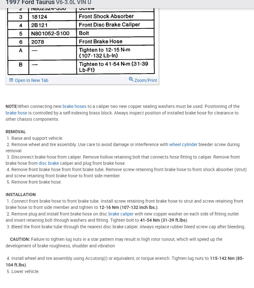

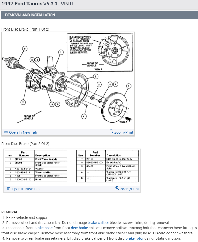

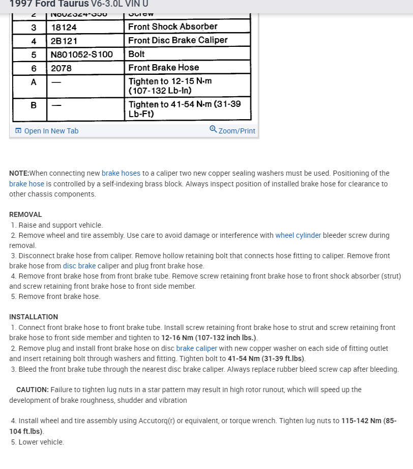

The brake pad will stick to the rotor when the piston of the brake caliper does not retract back. This is typically due to a brake hose which has collapsed on the inside and creating restriction and preventing the brake fluid to flow back through the hose, resulting a sticking brake pad.
In order to get this fixed you will have to replace the brake hose. Any time the brake sticks for a period of time it is also recommended to replace the caliper, as high heat has likely damaged the internals of the caliper.
https://www.2carpros.com/articles/brake-caliper-replacement

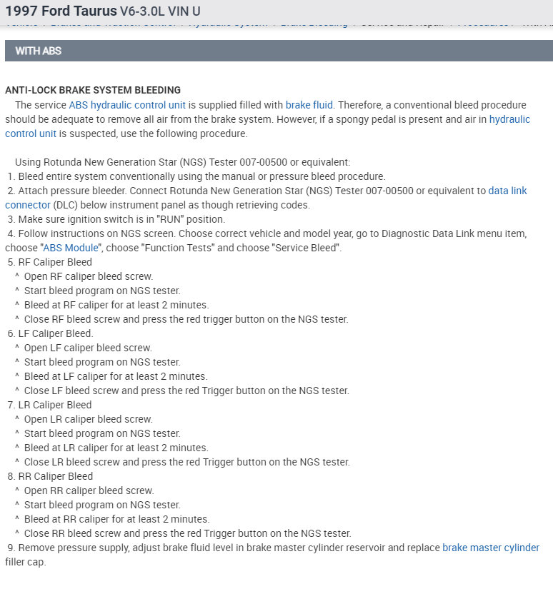

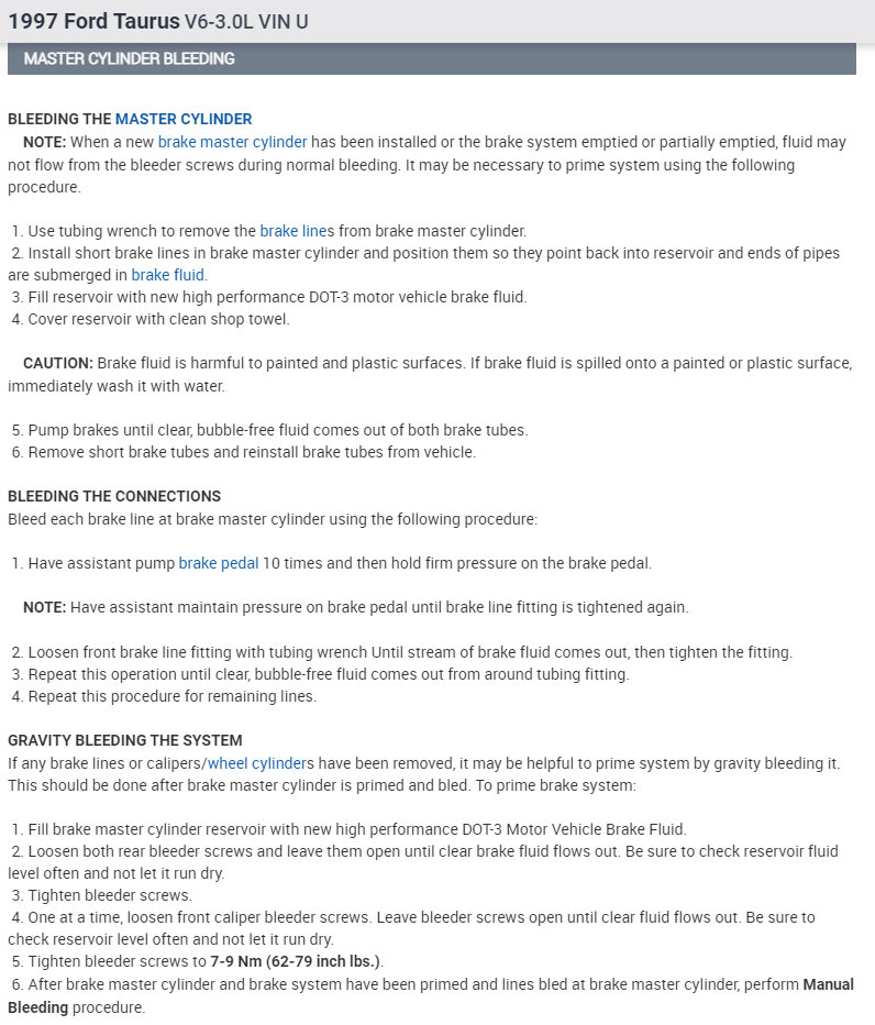

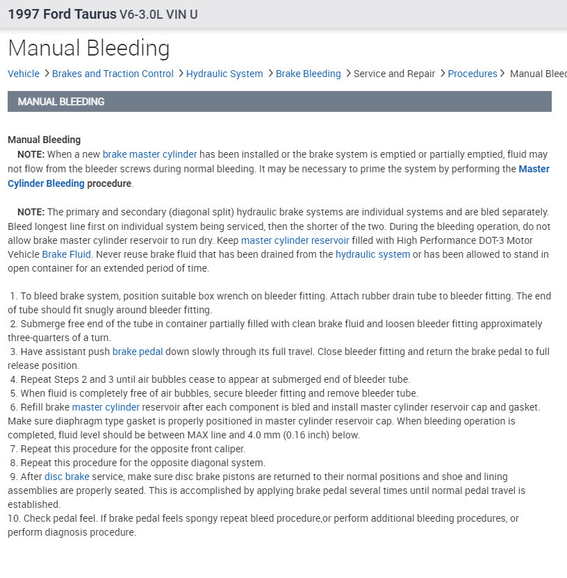

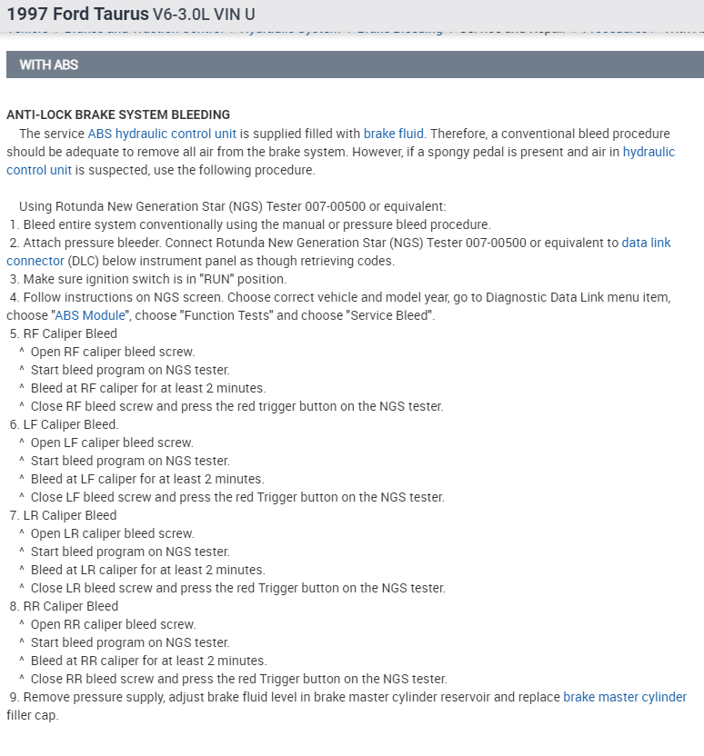

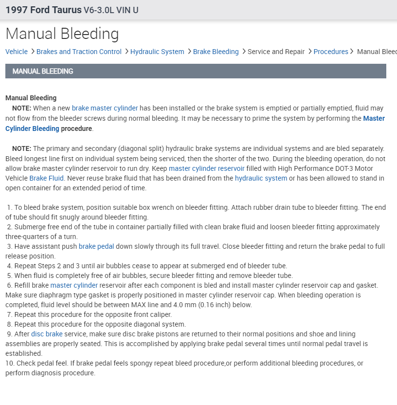

Keep in mind that anytime the caliper or hose gets replaced, the brake system needs to be purged of any air by bleeding the brakes.
https://www.2carpros.com/articles/how-to-bleed-or-flush-a-car-brake-system
I have attached the brake caliper and hose replacement as well as the brake bleeding procedure for your reference.
