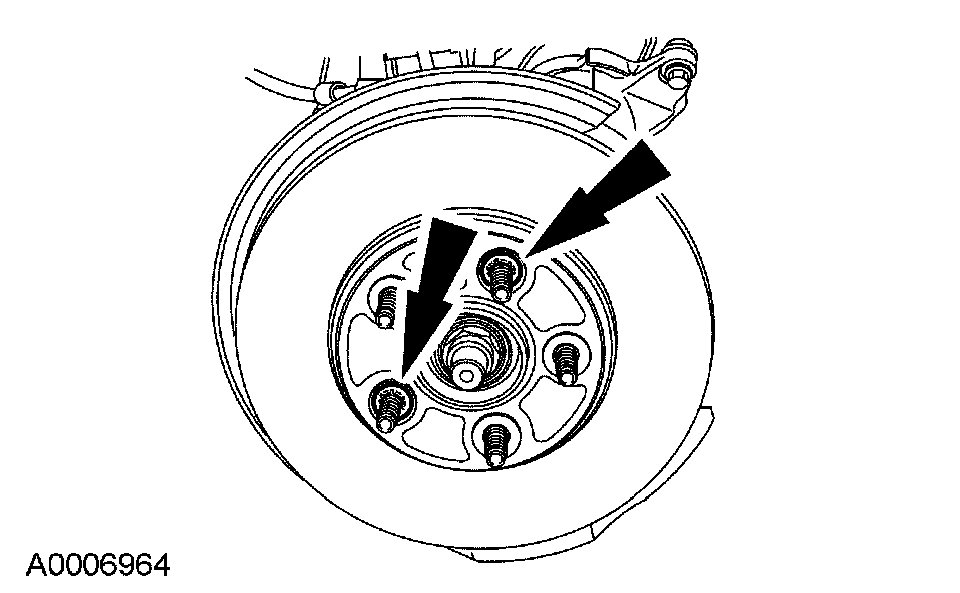

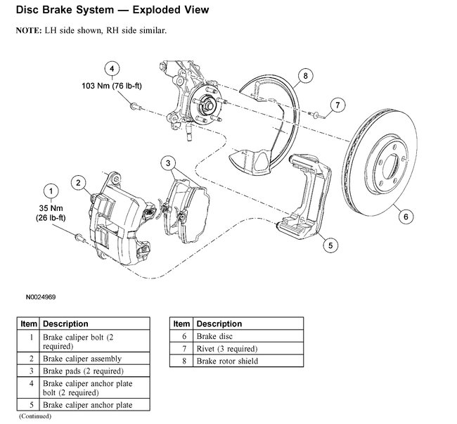

I have replaced front brakes and rotors on several cars in the past. 1997 Ford Contour, 2002 Ford Escape, and 2002 Ford Focus all had the calipers and pads on the back side of the rotor or wheeel. The 2007 Ford Taurus I have now has the caiper and pads on the front of the wheel assembly. Can you help me in what I need to do to remove the pads and caliper to replace?

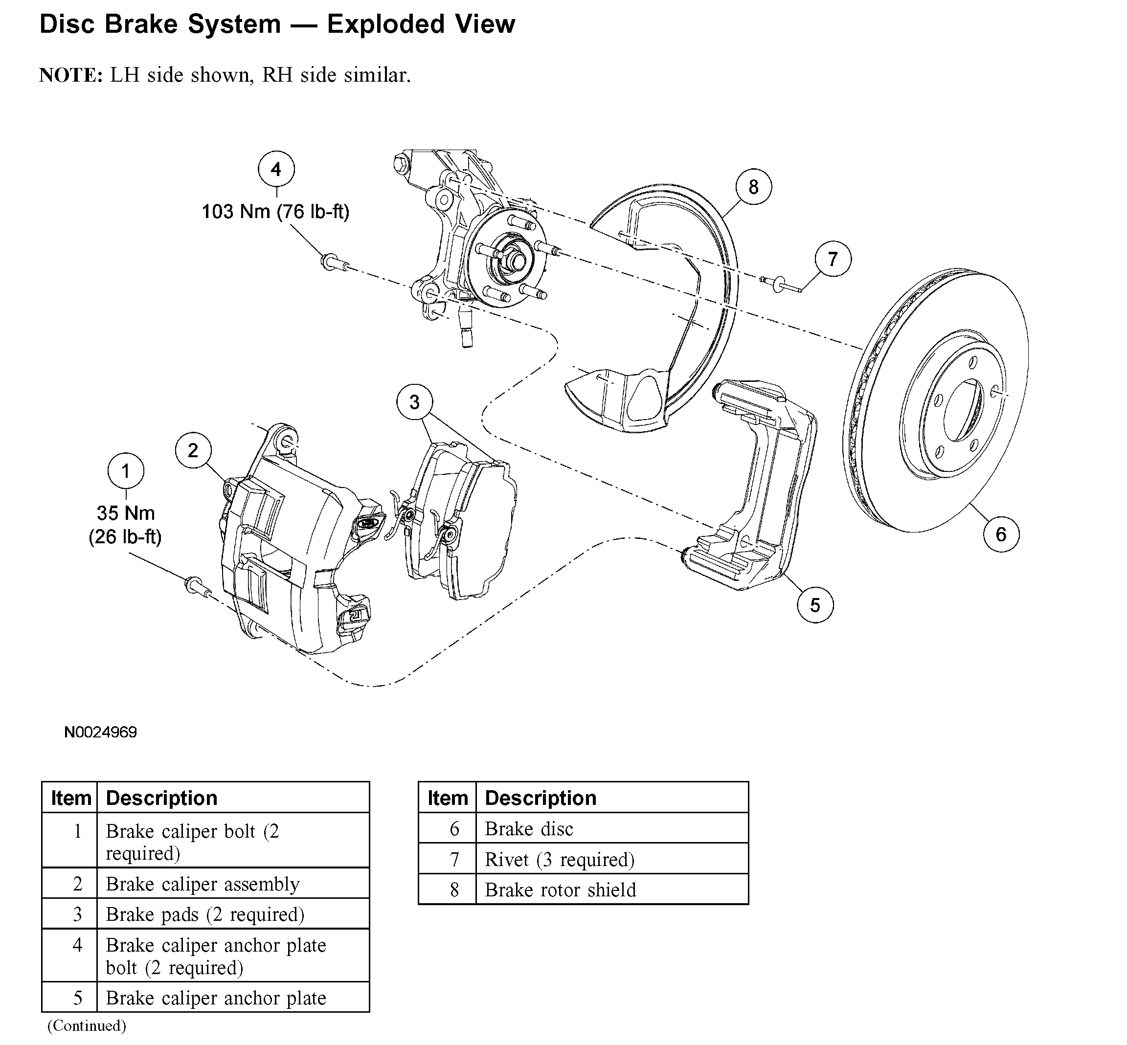

Remove the brake caliper bolts and support the caliper with mechanic's wire.
4. CAUTION: Install new brake pads if they are worn past the specified thickness above the metal backing plate. Install new brake pads in complete axle sets.
Inspect the pads for wear and contamination.
5. Measure the brake disc thickness and install a new front brake disc if it is not within specification.
6. Remove the brake pads.
Installation
1. CAUTION: Do not allow grease, oil, brake fluid or other contaminants to contact the pad lining material. Do not install contaminated pads.
NOTE: One brake disc pad kit contains the pads required for both sides.

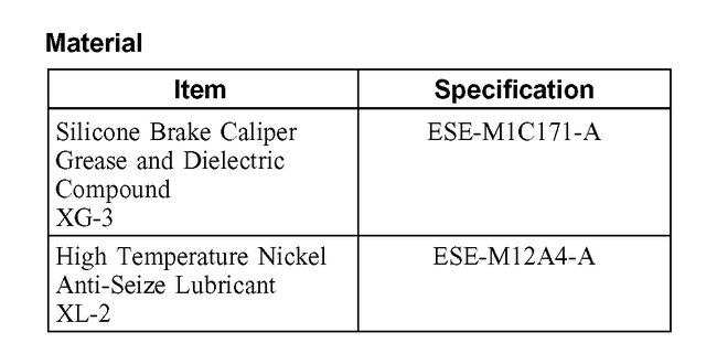

Install the new brake pads.
2. NOTE: Use a suitable tool to protect pistons and boots when pushing the caliper pistons into the bores.
Compress the disc brake caliper pistons into the caliper piston bores.
3. Position the brake caliper and install the caliper bolts.
^ Tighten to 35 Nm (26 ft. lbs.).
