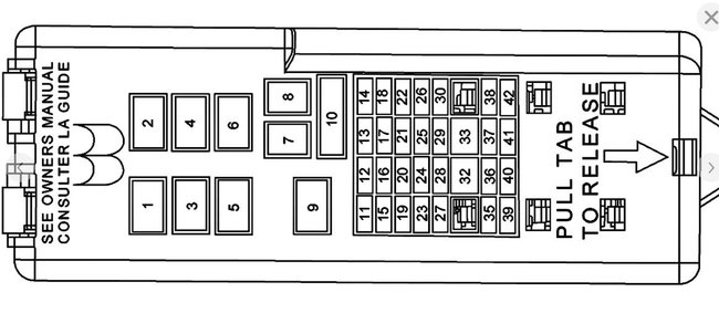

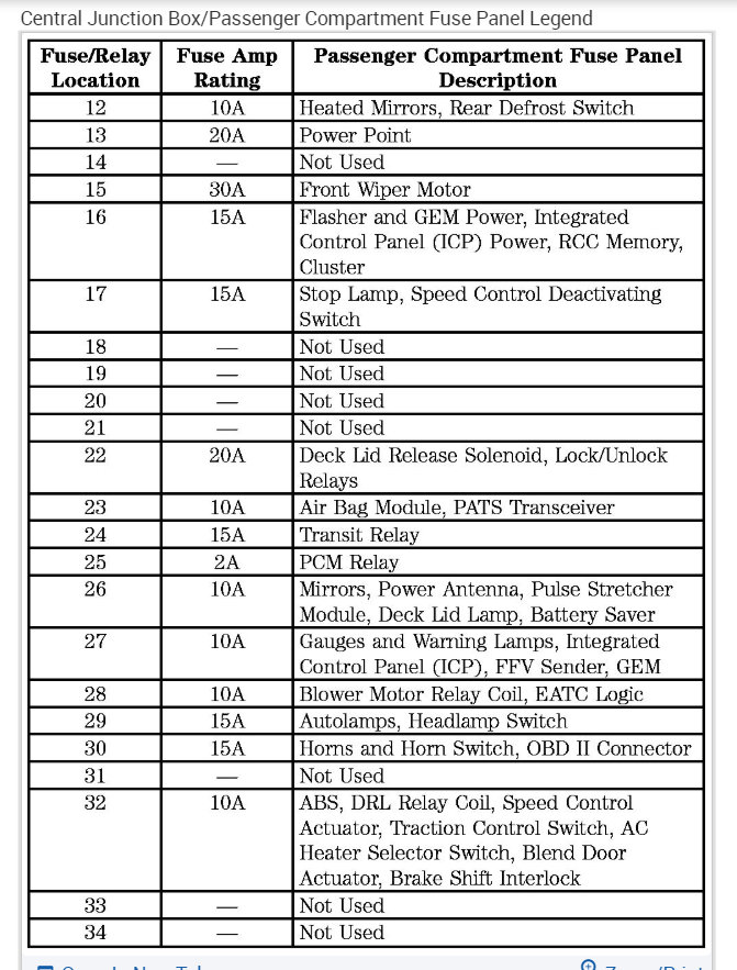

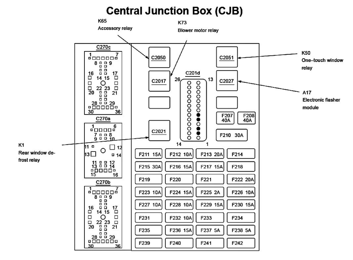

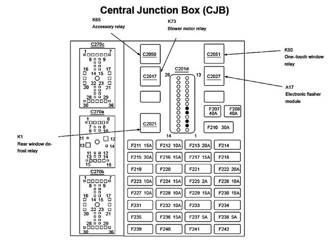

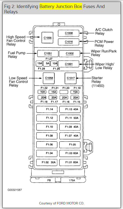

the cigarette lighter and auxiliary outlet do not have power to them. I'm guessing a fuse might be bad. No other signs of electric problems.
Nov 22, 2008 at 9:49 AM
BLUELIGHTNIN6
  • 16,542 POSTS

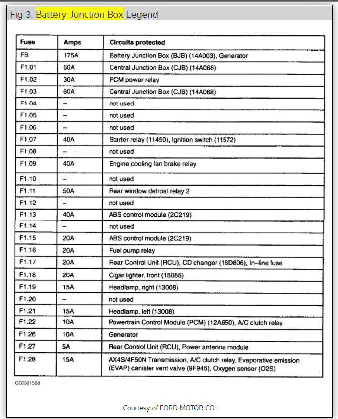

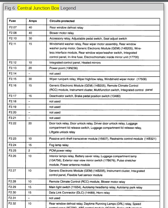

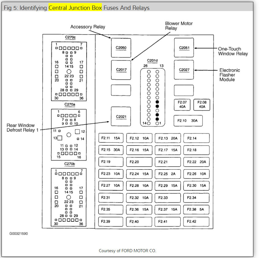

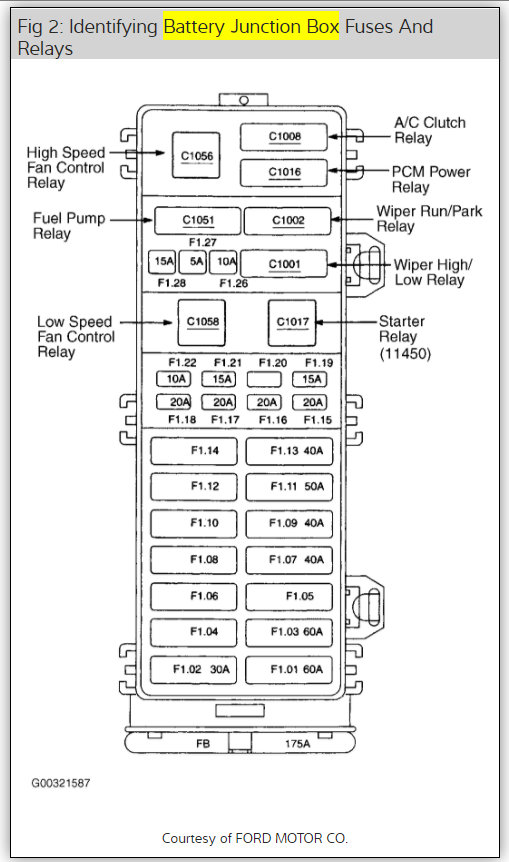

Sounds like a simple "blown" fuse. Here is a guide to help you test for power with the fuse location in the diagrams below.
Check out the diagrams (Below). Please let us know what you find.

Here is a guide to help you test the fuse # f118 and #f213 for the power port. Check for for power and the cigarette lighter fuse location in the diagrams below.

Easiest and fastest way is to turn on the ignition switch, (in case yours has to be on for the lighter to work), then use a test light on each fuse. They have two small holes on top to stick the test light's probe tip. If the fuse is good, the light will light up on both holes. If the light is off on both holes, that circuit is turned off and you don't know for sure if the fuse is okay. You're looking for a fuse where the test light lights up on one hole but not the other one.
A more time-consuming way is to pull each fuse out one at a time and look at them. You'll see a little curved piece of metal inside the plastic. A blown fuse will have a noticeable gap in the middle of that piece of metal and will usually have a big black spot around it.

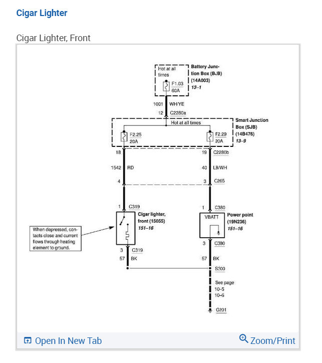

My cigarette lighter keeps blowing fuses and will not work! Can u send me a wiring diagram or a way to solve my problem??
Apr 25, 2020 at 12:18 PM (Merged)
BILLYMAC
  • 2,204 POSTS
hi
the only wireing is a power and a ground.
replace the wire and make sure nothing like a penny is inside of the socket.
if these fail buy a new lighter socket avail at most parts stores

The Cigar Lighter in my 2000 ford Taurus does not work. I have replaced the # 13 fuse (20A) in the fuse box, as it was burned , and still no power.
After replacing the fuse the lighter did not work, i also tried a phone charger, to verify, it did not work as well.
I am thinking maybe the lighter outlet itself is bad.
Any ideas?
Thanks
Jun 6, 2020 at 1:03 PM (Merged)
  • 110,194 POSTS
If the fuse was bad, then there is a short. Did the new fuse blow or is it still good? THis may sound crazy, but make sure a penny or dime didn't slip into the receiver end of the component. I have seen that happen more than once. It causes the fuse will keep blowing.
If the fuse is still good, have you checked to see if there is power to the lighter?

To get started, measure the voltage on both test points on top of the fuse and include the results in your first post. That will tell us which way to start looking.
