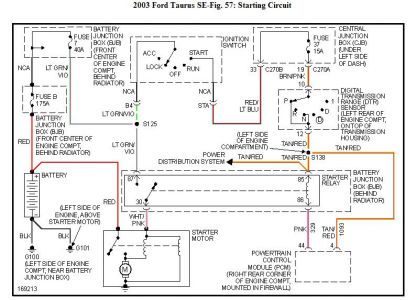

I'm having problem engaging the starter. The problem is intermittent as it usually starts when it cools down and has happened 3-4 times over 4 month.
I suspect a stuck solenoid plunger. Since I don't have a schematic:
1. Could there be anything else?
2. Can you supply me with a schematic?
Thanks in advance
Apr 20, 2009 at 6:49 AM
BLUELIGHTNIN6
  • 16,542 POSTS
Hello Thanks for the donation It does seem to be a faulty solenoid, however an intermittent problem is just that..intermittent. This makes it very difficult to diagnose the culprit because you can test the component one time and it will be good but you may test it again and it will be showing faulty..Below is the circuitry for your vehicle's starting system..hope this helps..
https://images.2carpros.com/forum/automotive_pictures/261618_1_56.jpg
Let me know if you need further assistance.. Thanks for using 2CarPros.com!

Thank you for a prompt response.
Based on the circuit diagram we have transmission switch, starter relay and starter.
It seems that I hear a click so transmission switch sends current to the relay. Is relay malfunctioning?
Unfortunately I can't remotely activate the starter solenoid it’s raining and I hardly have any tools (remote switch).
Am I missing something?

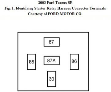

EMRDAVID
LOL. I know how to troubleshoot a relay if I know the pinout. Do you have one.
Thank a bunch.

Haha sorry about that..we never know how much knowledge a poster has :)
https://images.2carpros.com/forum/automotive_pictures/261618_Noname_466.jpg
Ok you need to measure voltage between the No. 86 terminal and ground. Do this with tranny in Park or Neutral and switch in START position. Let me know if battery voltage is present or not present.
