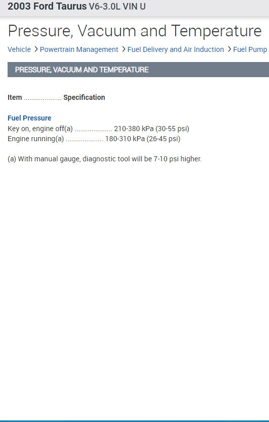

Might want to check the fuel pressure when the tank is more than half way full and when the tank is close to empty.
You should have 30-55 PSI with the key on and engine off.

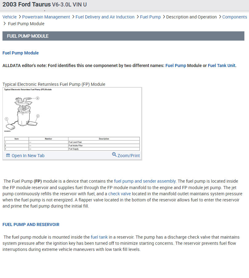

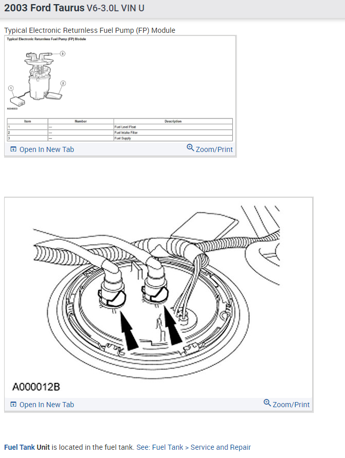

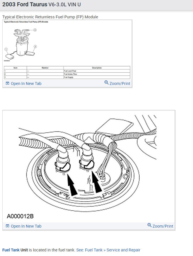

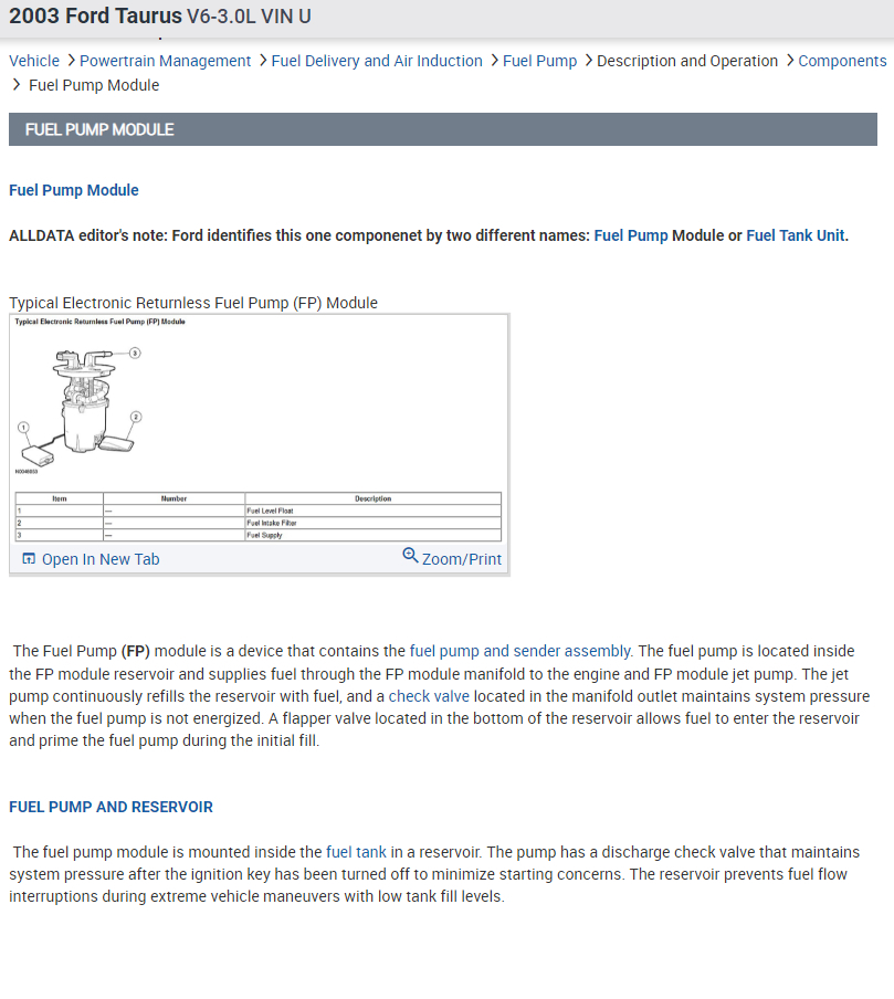

I have attached the fuel pump diagrams for your reference.
