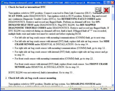

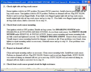

We have a a few lights on in the Ford Taurus 2003. Airbag, ABS and breaks (both). I've been told it won't pass safety if the ABS light is on. The code reader is not picking up any codes, how do I find out what's wrong with it? Could all 3 be related? The vehicle was in an accident, but the airbags have been replaced with new. I believe the sensors were also replaced. Thanks!

Most of the cheaper code readers won't read abs or air bag code's.I think maybe the abs and brake light being on are related.But i think the air bag light on is a different issue.If you could get me the code's i could get you some trouble tree's.I know actron make's a cheap abs code reader but from what i read you have to be careful to make sure it work's for your year and model because it doesn't work for every car.See what you can find out.

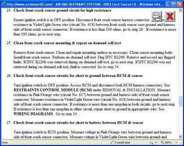

Thank you for replying! The airbag flashes a code 42.I'm trying to get some one to take a look at the codes with a professional code reader, but that may be a few days yet. Is there an electric schematic diagram available for the 2003 taurus, for airbag and ABS? That would be a great help!

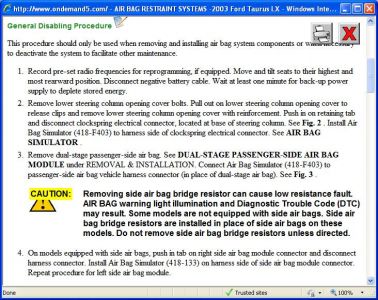

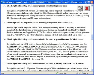

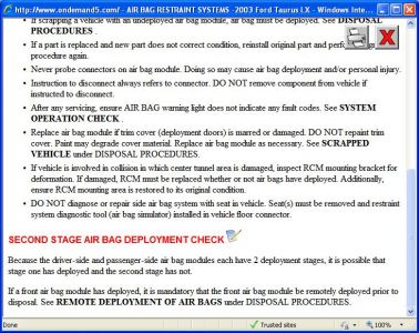

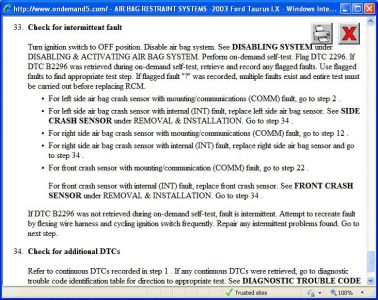

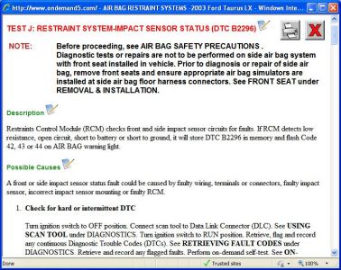

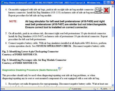

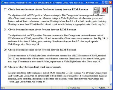

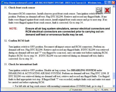

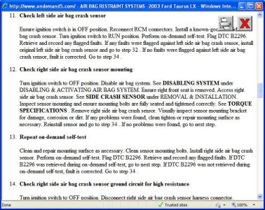

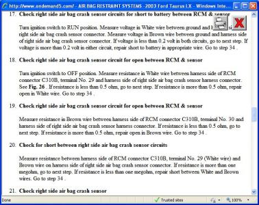

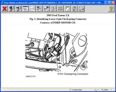

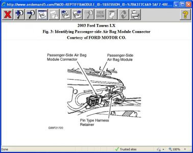

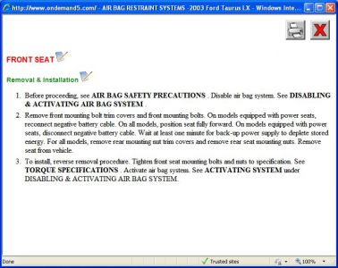

https://images.2carpros.com/forum/automotive_pictures/416332_2003_ford_taurus_airbag_code_b229642_part1_1.jpg
https://images.2carpros.com/forum/automotive_pictures/416332_2003_ford_taurus_airbag_code_b229642_part2_1.jpg
https://images.2carpros.com/forum/automotive_pictures/416332_2003_ford_taurus_airbag_code_b229642_part3_1.jpg
https://images.2carpros.com/forum/automotive_pictures/416332_2003_ford_taurus_airbag_code_b229642_part4_1.jpg
https://images.2carpros.com/forum/automotive_pictures/416332_2003_ford_taurus_airbag_code_b229642_part5_1.jpg
https://images.2carpros.com/forum/automotive_pictures/416332_2003_ford_taurus_airbag_code_b229642_part6_1.jpg
https://images.2carpros.com/forum/automotive_pictures/416332_2003_ford_taurus_airbag_code_b229642_part7_1.jpg
https://images.2carpros.com/forum/automotive_pictures/416332_2003_ford_taurus_airbag_code_b229642_part8_1.jpg
https://images.2carpros.com/forum/automotive_pictures/416332_2003_ford_taurus_airbag_code_b229642_part9_1.jpg
https://images.2carpros.com/forum/automotive_pictures/416332_2003_ford_taurus_airbag_code_b229642_part10_1.jpg
https://images.2carpros.com/forum/automotive_pictures/416332_2003_ford_taurus_airbag_code_b229642_part11_1.jpg
https://images.2carpros.com/forum/automotive_pictures/416332_2003_ford_taurus_airbag_code_b229642_part12_1.jpg
https://images.2carpros.com/forum/automotive_pictures/416332_2003_ford_taurus_airbag_code_b229642_part13_1.jpg
https://images.2carpros.com/forum/automotive_pictures/416332_2003_ford_taurus_airbag_code_b229642_part14_1.jpg
https://images.2carpros.com/forum/automotive_pictures/416332_2003_ford_taurus_airbag_code_b229642_part15_1.jpg
https://images.2carpros.com/forum/automotive_pictures/416332_2003_ford_taurus_airbag_code_b229642_part16_1.jpg
https://images.2carpros.com/forum/automotive_pictures/416332_2003_ford_taurus_airbag_code_b229642_part17_1.jpg
https://images.2carpros.com/forum/automotive_pictures/416332_2003_ford_taurus_airbag_code_b229642_part18_1.jpg
https://images.2carpros.com/forum/automotive_pictures/416332_2003_ford_taurus_airbag_code_b229642_part19_1.jpg
https://images.2carpros.com/forum/automotive_pictures/416332_2003_ford_taurus_airbag_code_b229642_part20_1.jpg
https://images.2carpros.com/forum/automotive_pictures/416332_2003_ford_taurus_airbag_code_b229642_part21_1.jpg

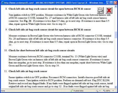

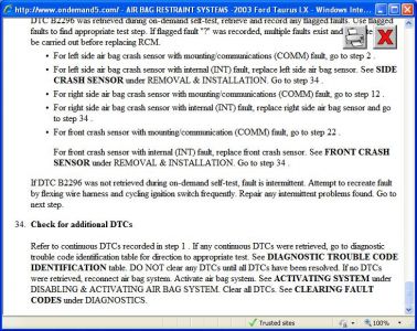

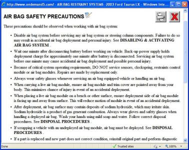

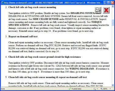

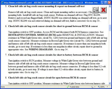

The code 42 is equal to code B2296 i posted the trouble for you let me know of any other needed info.
