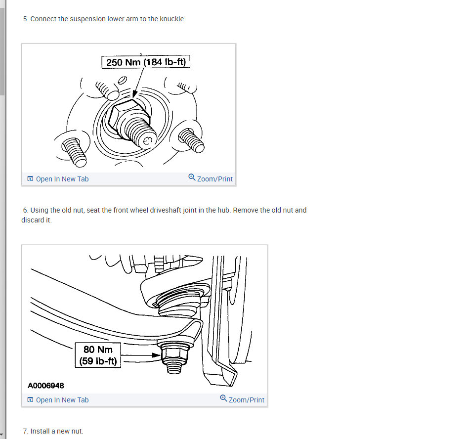

The abs light is on cleaned the sensors ?
2005 FORD TAURUS
250,000 MILES • 3.0L • 6 CYL • 2WD • AUTOMATIC
RUDY GONZALEZ

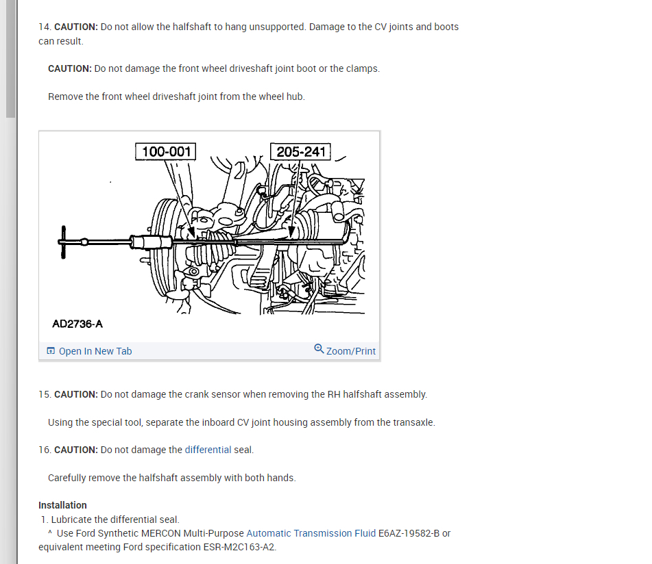

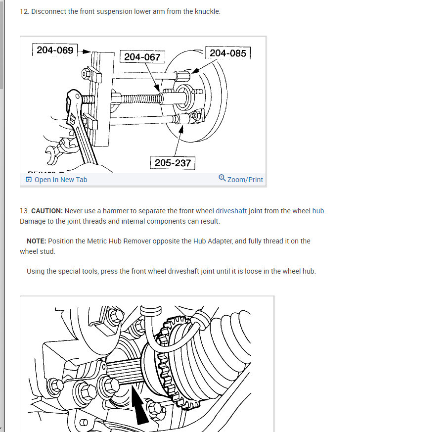

Cleaned the sensors and noticed that the teeth on one side are worn out.
Dec 1, 2016 at 6:59 AM
We need to start with checking and make sure the ABS light is on due to a wheel speed sensor.
Here are a couple guides that will help with this:
https://youtu.be/rTtAnsOlZU4
https://www.2carpros.com/articles/abs-wheel-speed-sensor-test
https://www.2carpros.com/articles/how-to-replace-an-abs-wheel-speed-sensor

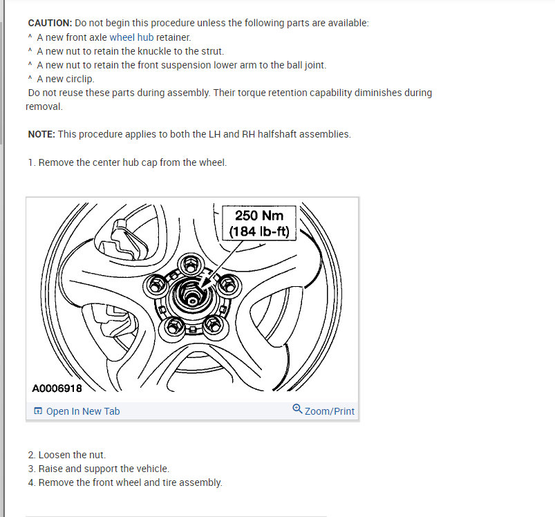

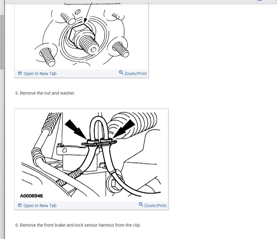

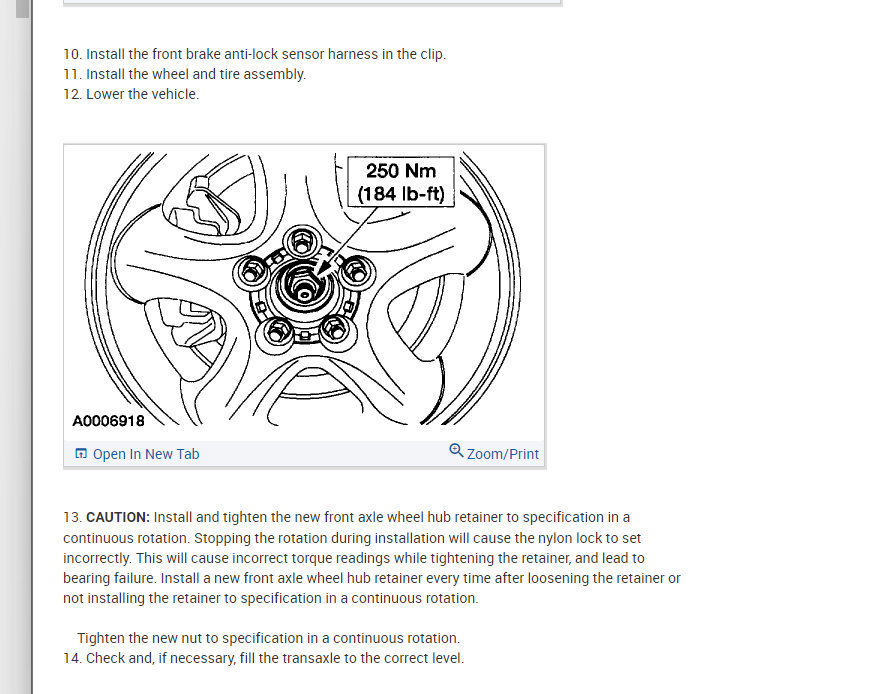

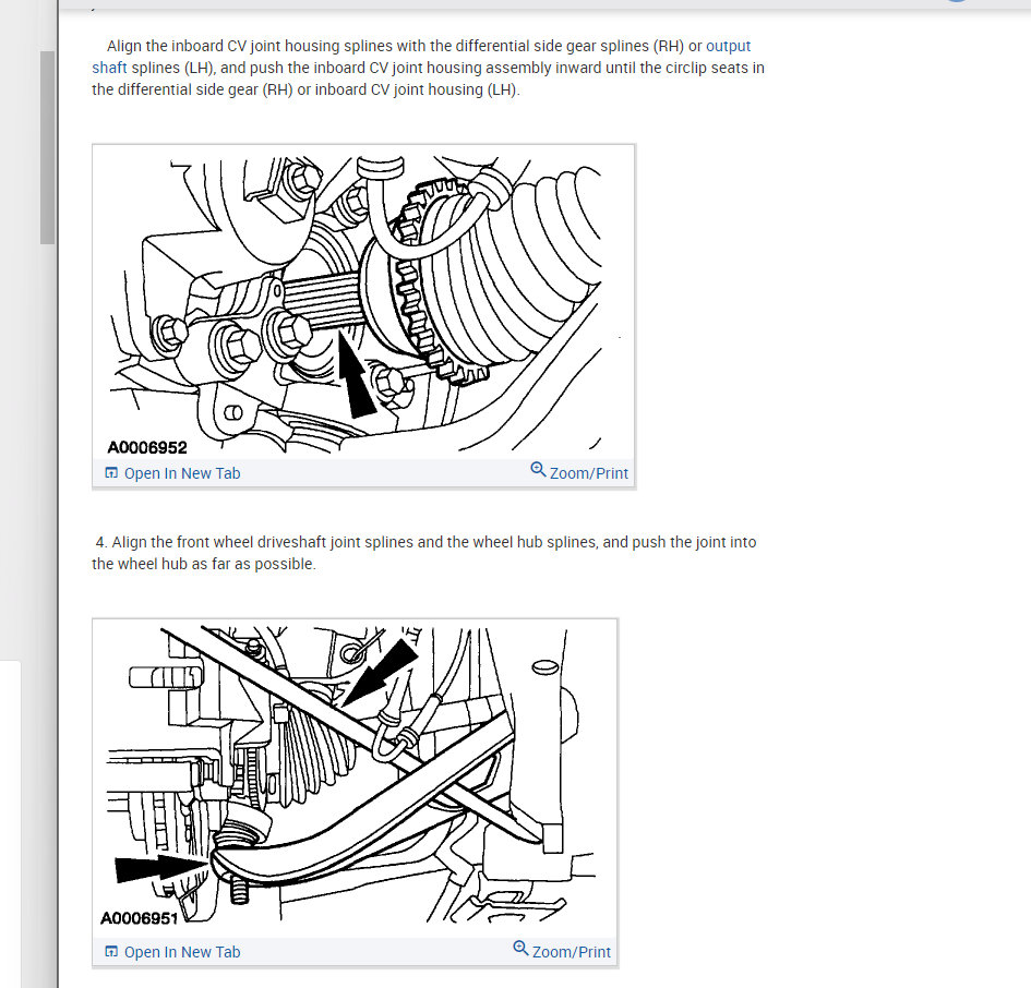

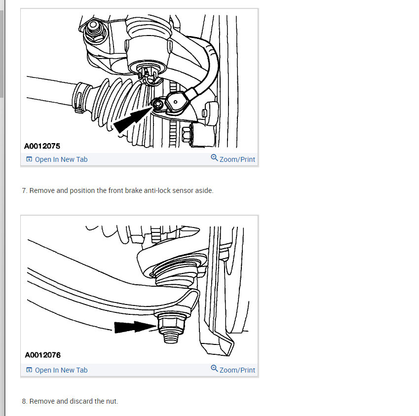

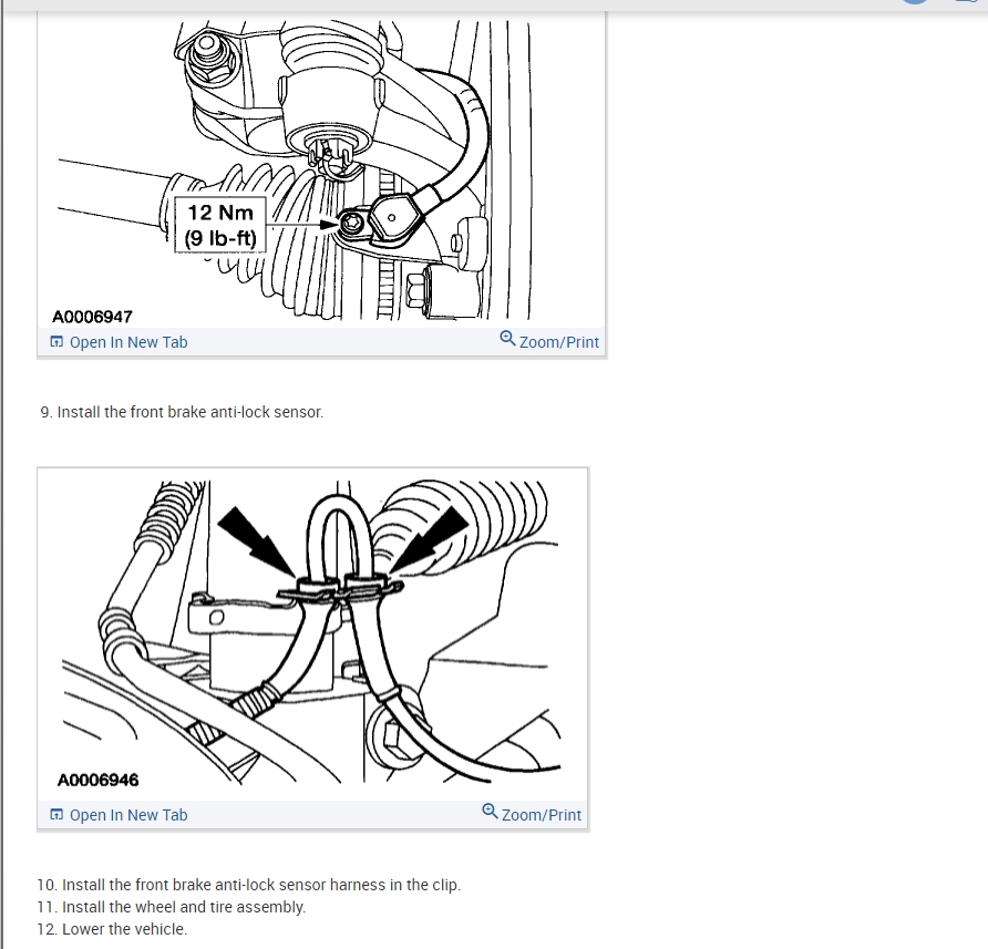

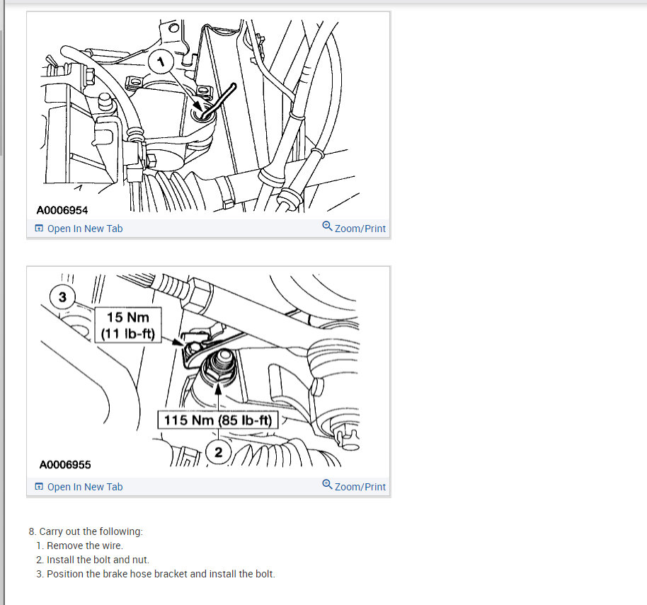

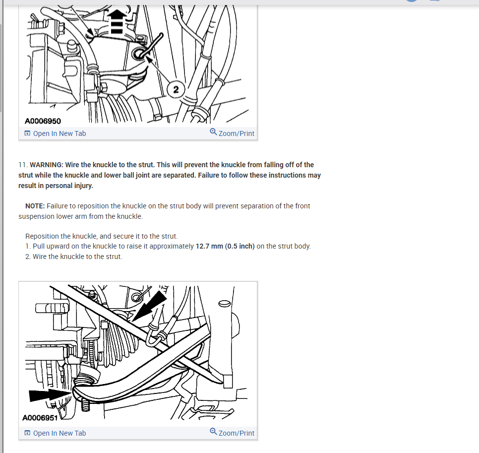

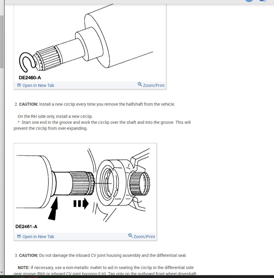

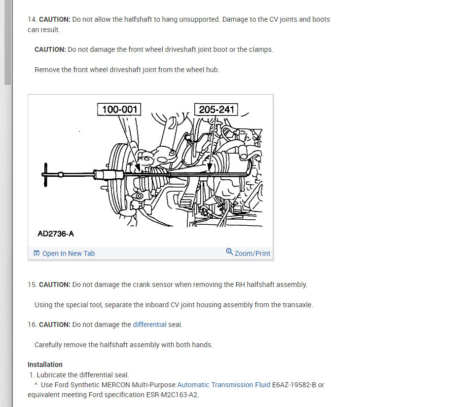

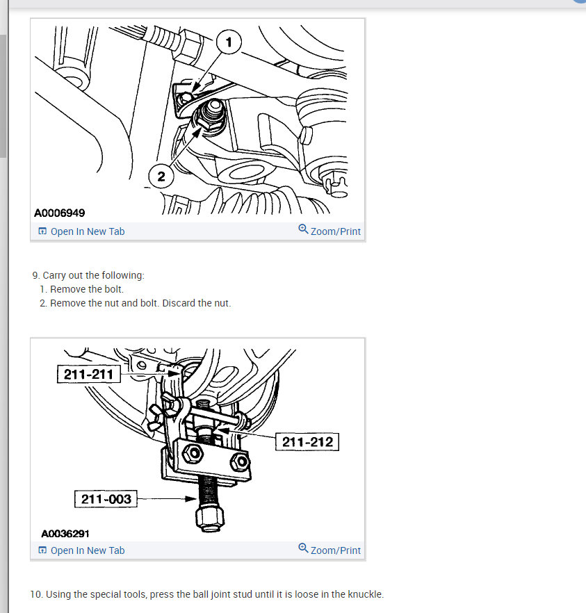

Below you will find the info on how to change the tone ring as you need to remove the axle. You can press the tone ring off and a new one on but if you are going to the point of removing it, I would just replace it.
Please run through this and let us know what you find, and we can go from there. Thanks
