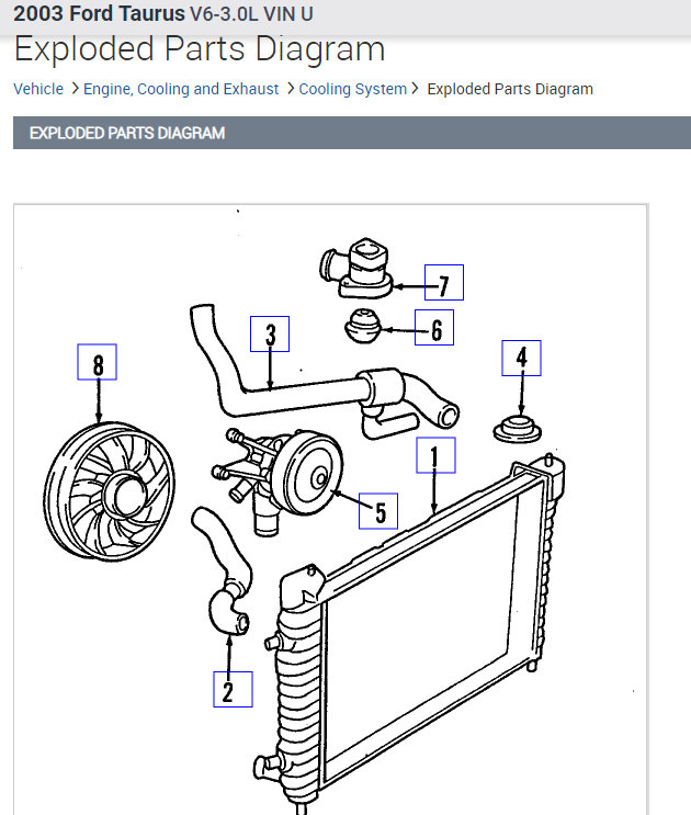

I have a 2003 ford taurus and is leaking antifreeze how do I fix it?

First you need to figure out what is leaking.
The coolant can leak form any of the hoses, water pump, thermostat housing, the radiator, radiator overflow or a gasket from the engine.
https://www.2carpros.com/articles/engine-cooling-system
https://www.2carpros.com/articles/coolant-leak-symptoms
You might be able to do a cooling system pressure test to find the leak.
The pressure test will pressurize the cooling system which will make the leak easier to find.
Be sure to do the test when the engine is cold.
There is a tool you can loan from your local parts store to do that test.
