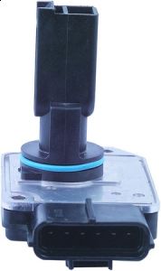

Where are the Oxygen and Map Sensors located?
Mar 28, 2009 at 6:57 AM
ZACKMAN
  • 4,202 POSTS
You have 4 oxygen sensors. Bank 1 Sensor 1: Rear of engine compartment, on exhaust manifold Bank 2 Sensor 1: Front of engine compartment, on exhaust manifold Bank 1 Sensor 2: Under the vehicle, after the catalytic converter of Bank 1 Bank 2 Sensor 2: Under the vehicle, after the catalytic converter of Bank 2 You don't have a MAP sensor, you have a Mass Air Flow Sensor in the air intake assembly.
