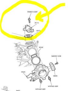

I just want to know how many hoses could be leaking antifreeze and where theyre located.

Many hoses this is some pictures
Best way to find a leak has the system pressure tested

I think its the water pump, my son who is in school for engine repair says its a water pump. Is that possible?

Yes very possible
Also common failure is the plastic tank on the passenger side inner fender
Coolant system pressure test should be done to be sure
