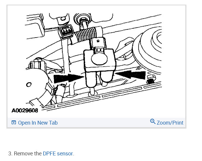

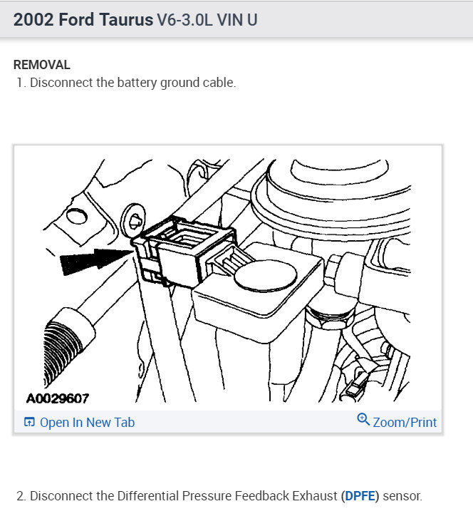

The EGR sensor is located near the EGR valve here are diagrams below to help show you the location. Check out the diagrams (Below). Disconnect the Differential Pressure Feedback Exhaust (DPFE) sensor. Please let us know if you need anything else to get the problem fixed.

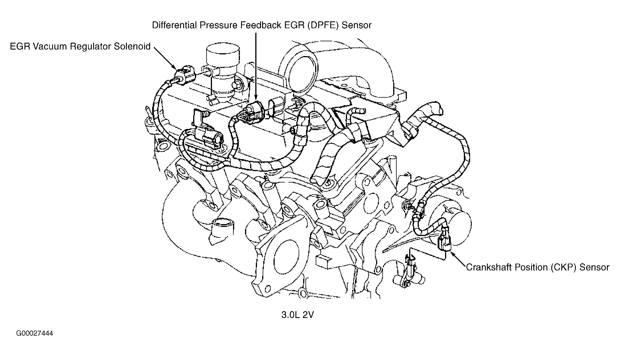

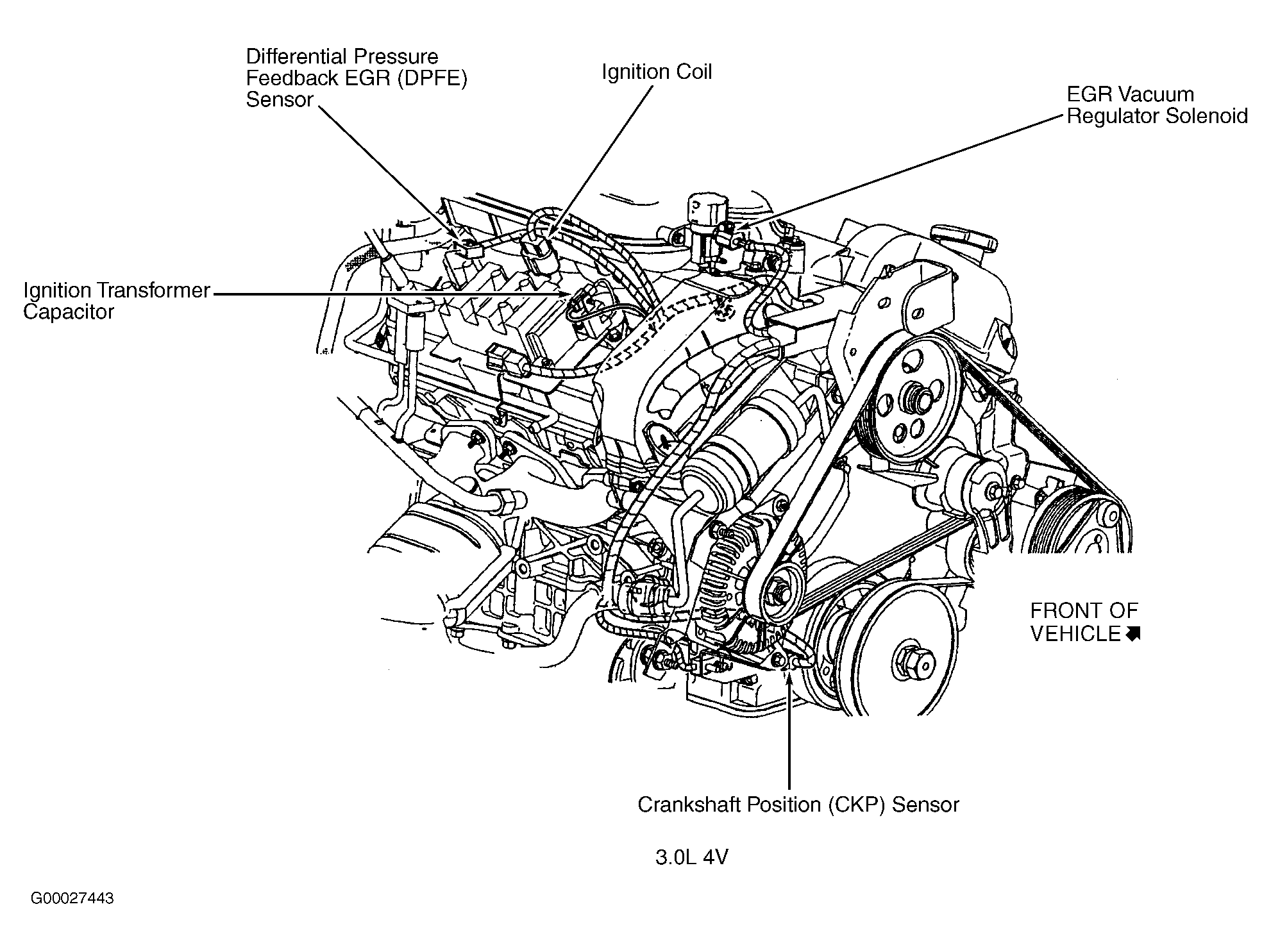

Differential Pressure Feedback EGR (DPFE) Sensor (3.0L 2V)Mounted on right front of intake manifold. See Fig. 1 .
Differential Pressure Feedback EGR (DPFE) Sensor (3.0L 2V FFV)Mounted on right front of intake manifold.
Differential Pressure Feedback EGR (DPFE) Sensor (3.0L 4V)Mounted on right side of engine. See Fig.
Here you go:
