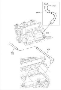

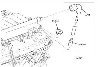

First of all I cannot find a pcv anywhere. Now it is throwing a code of p1151 . ho2s 2/1 insufficient switching lean mean. I suspect all these codes are related to one thing that is wrong. But can't seem to find the one thing.
Anyway I can get a picture of where the pcv is supposed to be at. This is the v6 DOHC.
Thanks

BMRFIXIT
  • 19,053 POSTS
Suspect a vacuum leak
that would trickier all them codes
a smoke test should reveal any vacuum leaks if any
check under the throttle body vacuum hoses
May 20, 2010 at 1:04 PM
BMRFIXIT
  • 19,053 POSTS
https://images.2carpros.com/forum/automotive_pictures/99387_7005_thumbnail_15.jpg
https://images.2carpros.com/forum/automotive_pictures/99387_7830a_thumbnail_7.jpg
sohc
