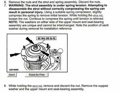

I got it checked from a Mechanic, he told me that the sound is coming from "seat-bearing of strut". So, the "Strut Mount" needs to be fixed.
He suggested me to change the Struts and Stabalizer links at $630.
The bull just have 66K miles.
How urgent is this repair, what if I dont do it for another year?
Can I live with it?
He told me that it will get louder with time, and it will cause the un-even tire wear, is that true?
The alignment is right, and the car goes straight.
It all started after I hit a pot-hole.
Thursday, June 18th, 2009 AT 11:11 PM
  • 109,747 POSTS
I don't know how bad it is, but if it isn't too bad, you should be able to wait for some time. Like he said, it will get worse with time. It shouldn't cause tire wear. As far as the struts and stabalizer links, was the car bouncing too much in the front or did you hear a ratteling sound? If not, I would only replace the strut bearing plate.

Here is the picture of the strut bearing, I got from Midas mechanic.
https://www.2carpros.com/forum/automotive_pictures/323340_untitled_3.jpg
The car is running absolutely normal, and is no bouncing, no rattling sound.
The only sound I hear is while turning the steering wheel towards left. That too only in the parking lot, as the sound is too low to hear on the road.
If I dont fix it, what harm can it do, apart from making some noise.
Should I just ignore it, as its not affecting the driving.
The estimate I got for only repairing the bearing plate is $310.
