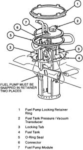

Is there a special trick to removing the fuel pump from the gas tank?

Relieve the fuel system pressure.
Drain the fuel tank.
Remove or disconnect the following:
Negative battery cable
Fuel lines
Fuel pump module electrical connector
Fuel tank
Fuel pump module
https://www.2carpros.com/forum/automotive_pictures/261618_0900c152801c8bde_2.jpg

The fuel pump seems like it is locked in somehow and we can't get it to come off. Do we turn it, press on something to unlock it, any special trick to getting it to release?

Should have a snap ring on it that you need to tap off with a hammer and punch

Already took it off but still cannot lift pump off.

The fuel pump module should come up if you have disconnected the wiring, fuel lines and removed the retainer ring. May just be stuck, try twisting it a little back and forth then lifting up.
