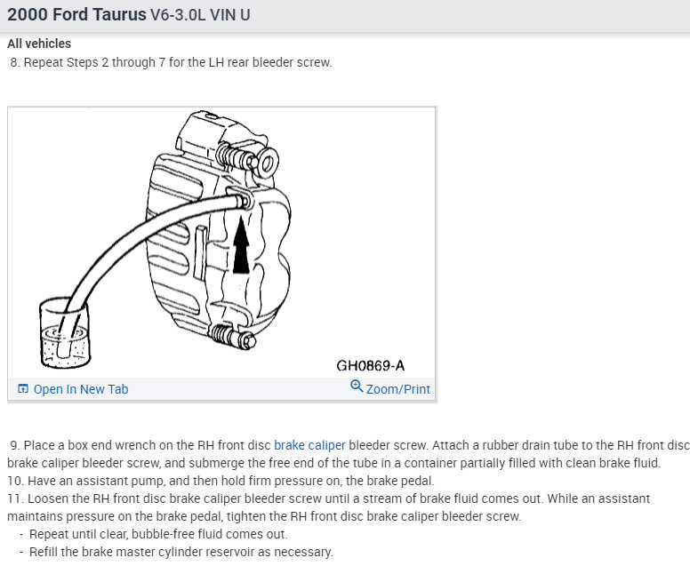

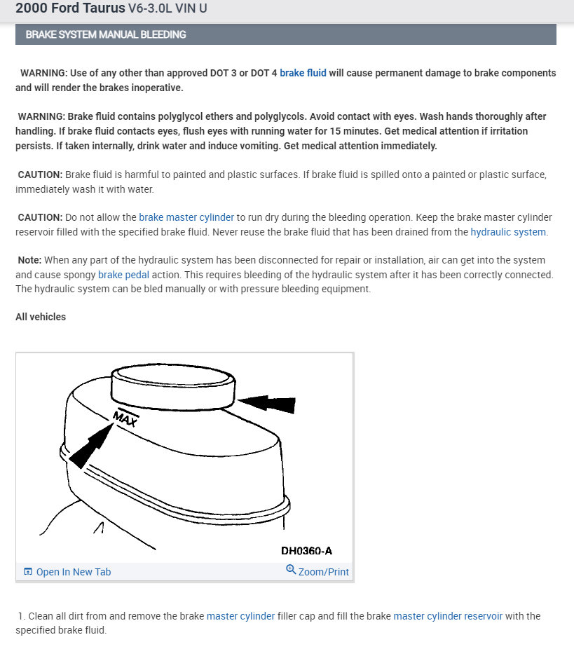

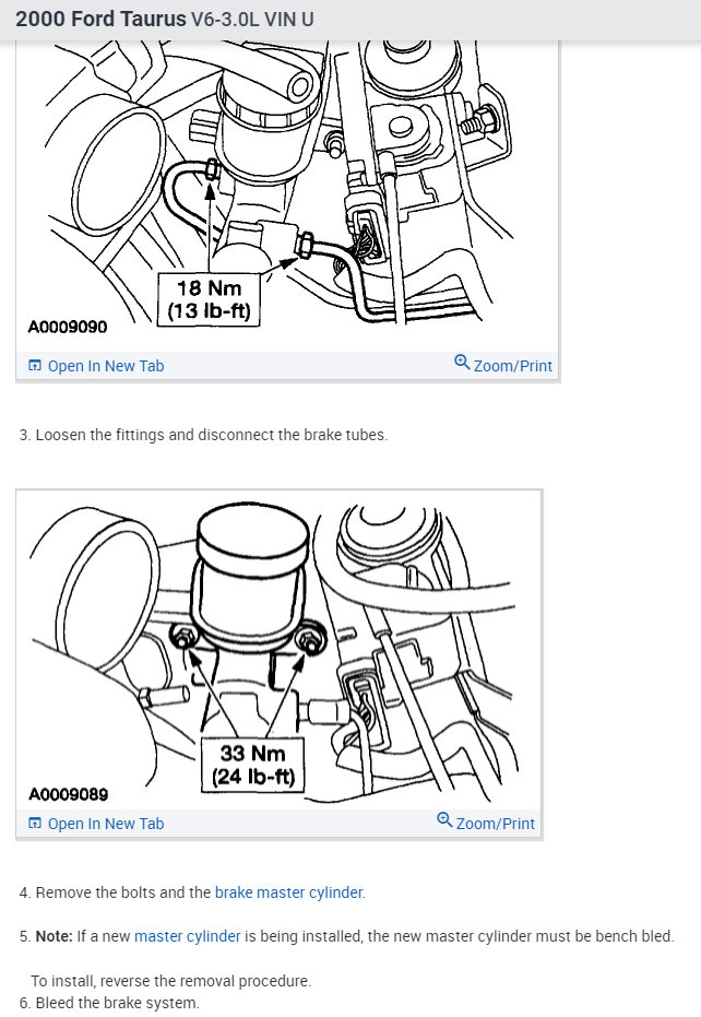

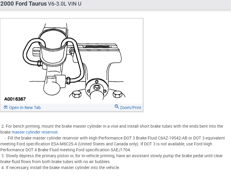

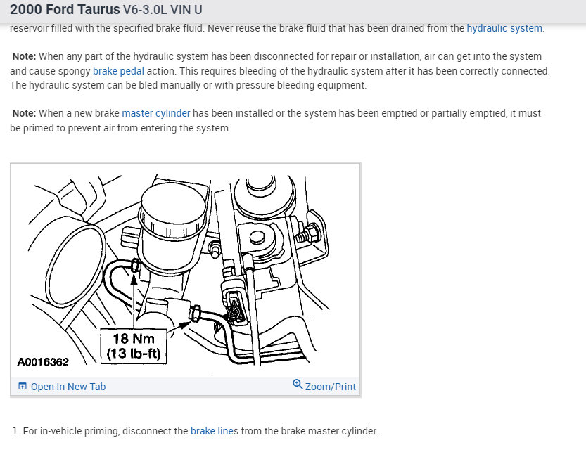

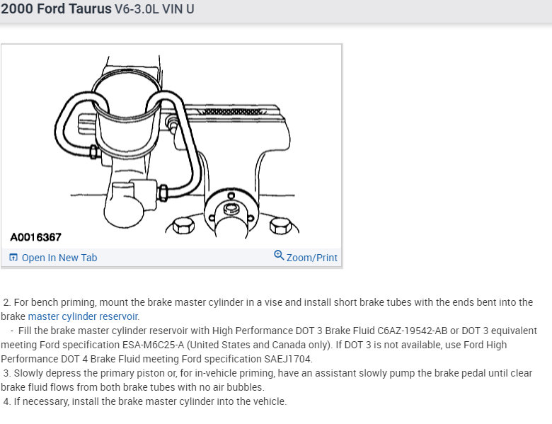

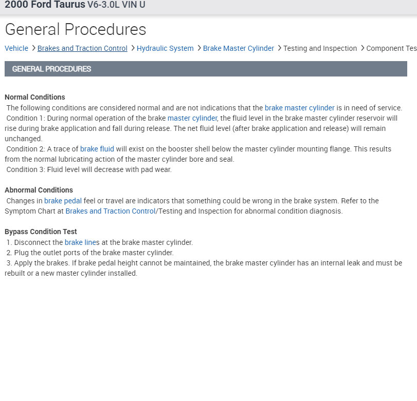

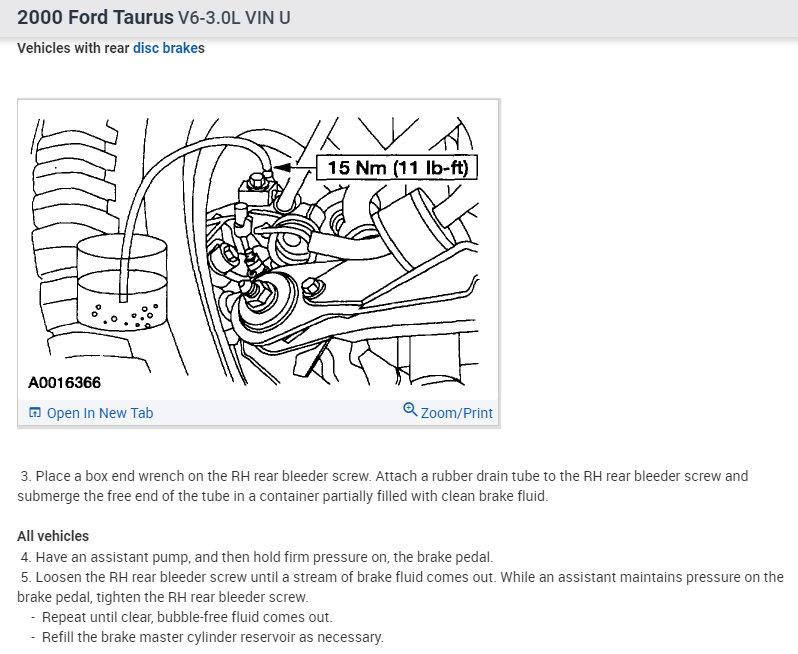

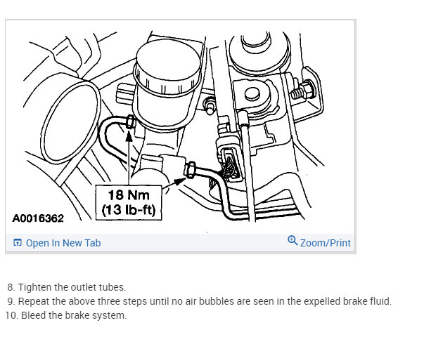

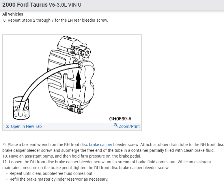

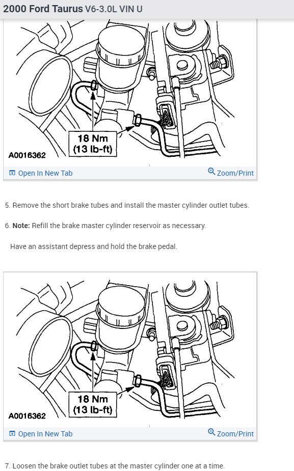

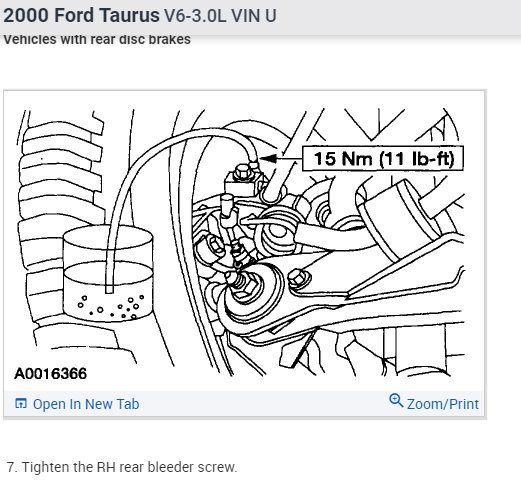

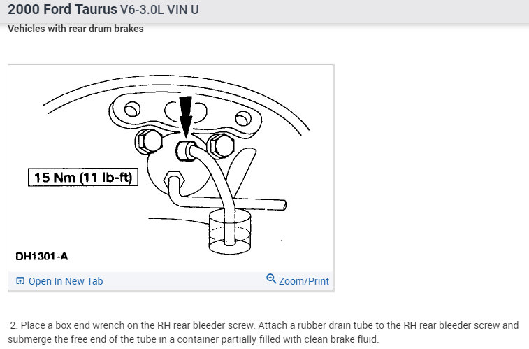

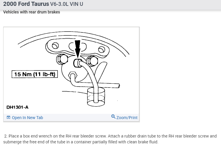

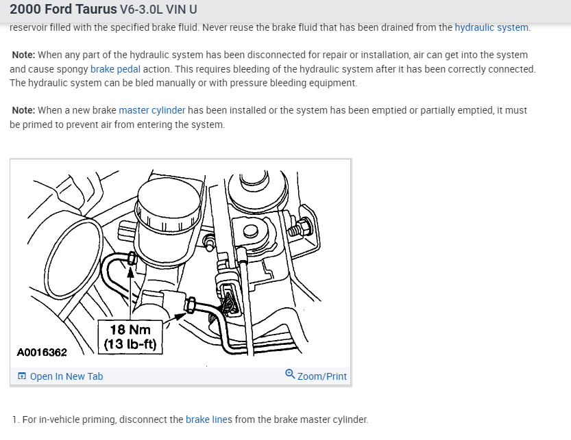

A petroleum-based fluid like power steering fluid can do some serious damage to the brake system. Especially the master cylinder. It usually makes the seals go bad inside the master cylinder. It can also damage the rubber brake hoses.

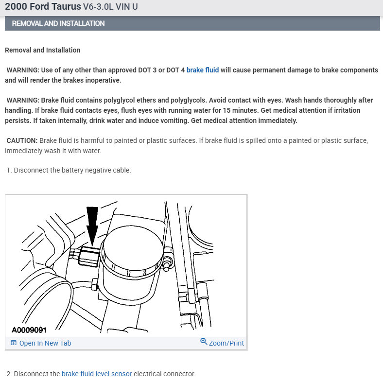

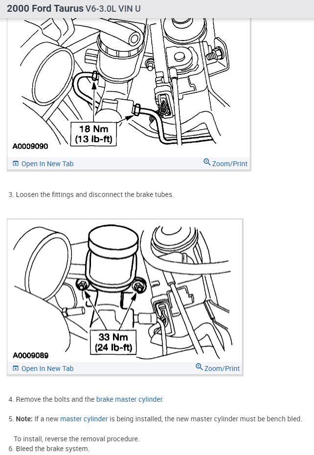

https://www.2carpros.com/articles/how-to-replace-a-brake-master-cylinder

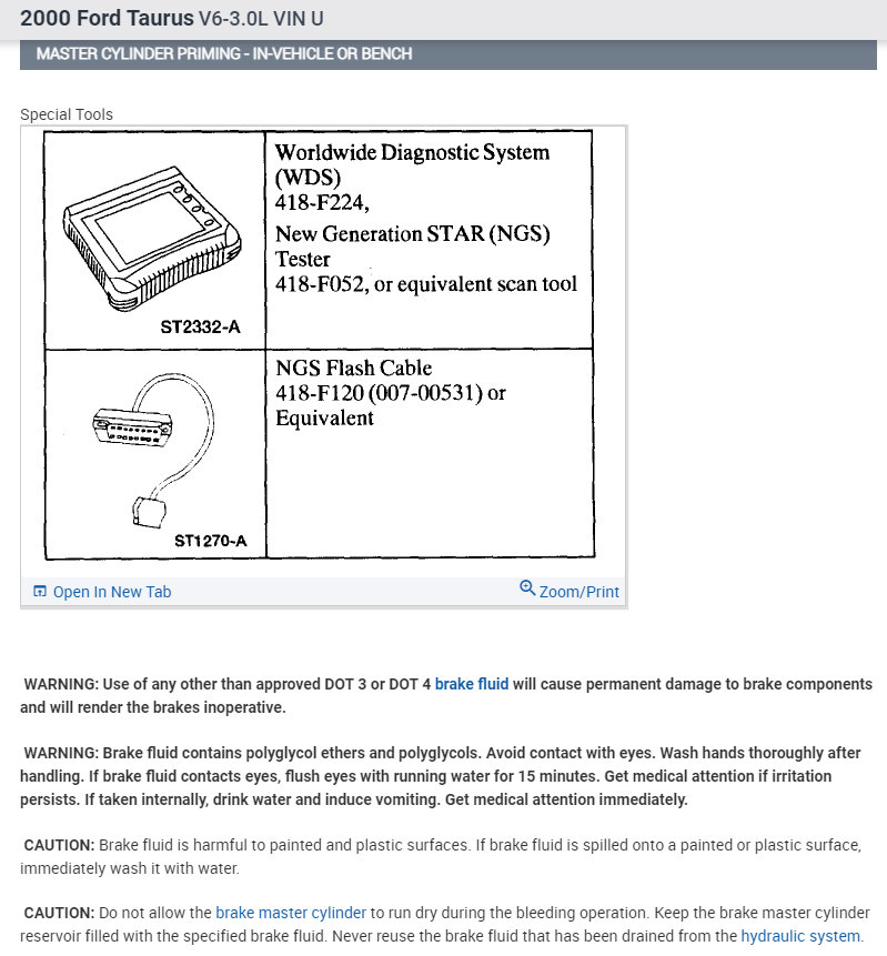

I have attached the master cylinder replacement procedure below, for anyone else who might be looking for that instruction.

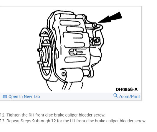

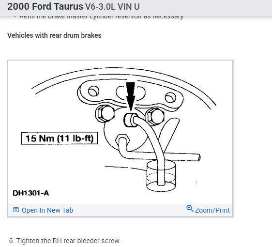

Keep in mind that changing the master cylinder will require the brake bleeding.
https://www.2carpros.com/articles/how-to-bleed-or-flush-a-car-brake-system
Please let us know of any questions.
