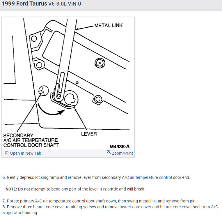

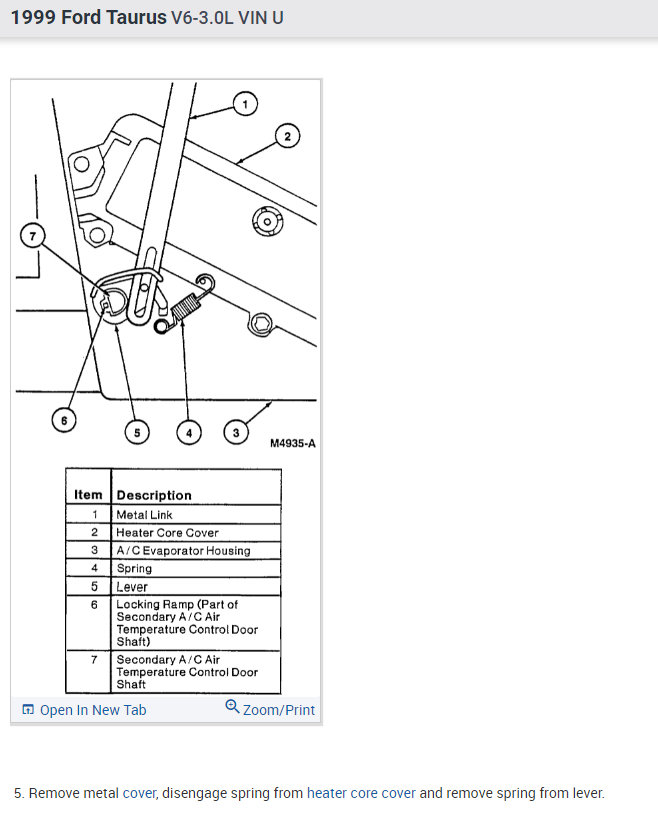

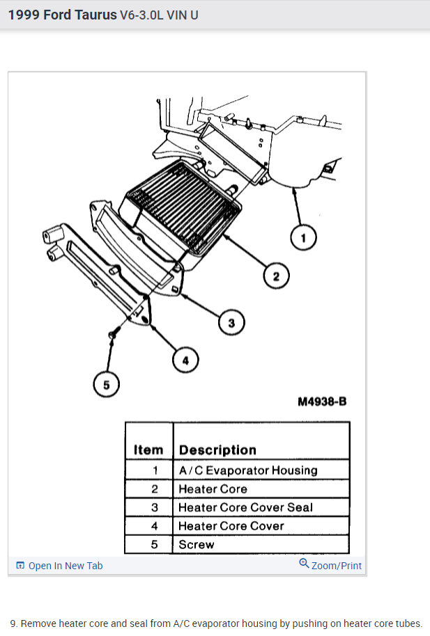

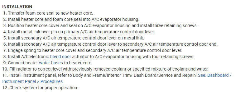

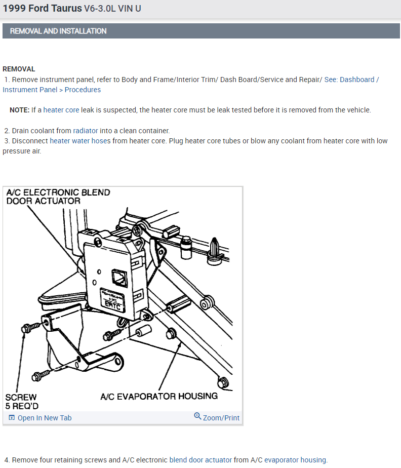

When you smell coolant after turning on the heater, it usually a leaky heater core. That should be the first item to check. Usually you will have either the heater core itself that leaks of one of the hoses that goes to the heater core. The heater core is located behind the passenger side dash.
https://www.2carpros.com/articles/how-a-car-heater-works
https://www.2carpros.com/articles/replace-heater-core
