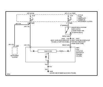

I went to leave for work car starts up fine. When I went to reverse it won't go into gear. Now if I start it in neutral I can shift gears but as soon as I put it in park it won't move? That is just the beginning. It seems to be electrical because all of my accessories are not working. Electric windows, radio, windshield wipers, trunk won't open, brake lights won't come on? We have tried replacing the GEM module and ignition switch please help

I would start by checking the fuses
check brake light switch
use a test light or volt meter check for power at the brake light switch
good luck

Thank you for responding. We have checked everything over at least 3 times. All fuses all relays brake light switch. We are just lost at this point.

Take a look at this diagram check if you have power at the fuse and at each point if not check wires
good luck
