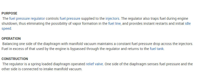

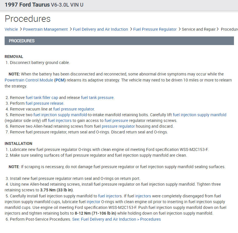

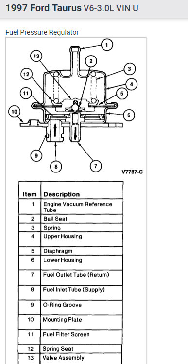

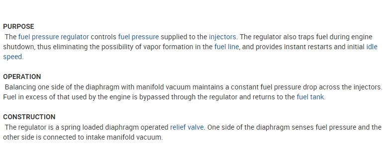

Check your fuel pressure. High fuel pressure means too much fuel getting to the engine.
Fuel pressure can be tested using fuel pressure test gauge. You can rent those tools from your local auto parts store.
With the key on and engine off you should have 37-45 PSI of fuel pressure.
