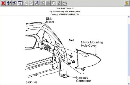

Last night as I was backing out through a tight spot I hit my passenger side mirror and it broke the holder clean off.
I bought a replacement mirror online already, how do I go about replacing the mirror holder?

Hi ssilence, Thank you for the donation. SIDE MIRROR ASSEMBLY Removal & Installation Remove door panel. Remove mirror mounting hole cover. See Fig. 1 . Disconnect mirror wiring harness connector. Remove mirror attaching nuts. Remove mirror assembly while guiding wiring and connector through hole in door. To install, reverse removal procedure. Tighten nuts to approximately 53 INCH lbs. (6 N.m).

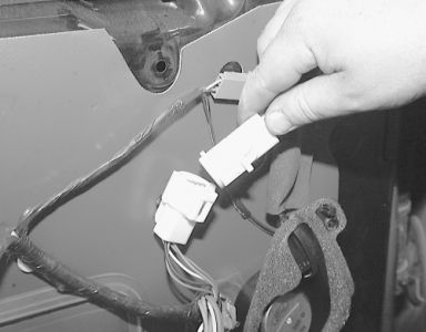

is this any better fellas?https://images.2carpros.com/forum/automotive_pictures/88091_taurus_mirror_1_2.jpg
https://images.2carpros.com/forum/automotive_pictures/88091_taurus_mirror_1_1.jpg" alt=" Fig. 1: Detach the connector for the mirror .
https://images.2carpros.com/forum/automotive_pictures/88091_taurus_mirror_1_1.jpg" /> Fig. 2: If necessary, peel back any watershields to...

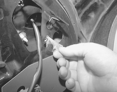

https://images.2carpros.com/forum/automotive_pictures/88091_taur_mirr2_1.jpg
Fig. 3: ... access the mirror retaining bolts and remove them

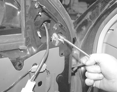

https://images.2carpros.com/forum/automotive_pictures/88091_taur_mirr3_1.jpg
Fig. 4: As the bolts are removed, carefully support the mirror assembly then remove it from the vehicle

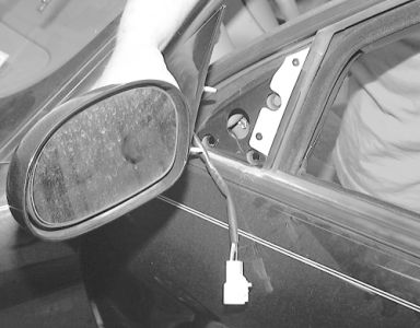

https://images.2carpros.com/forum/automotive_pictures/88091_taur_mirr4_1.jpg
Disconnect the negative battery cable. Remove the front door panel. Detach the outside rearview mirror wiring connector. Remove the wiring guides as necessary. Remove the three outside rear view mirror retaining nuts. Remove the outside rear view mirror while guiding the wiring through the hole in the door. To install: Install the outside rear view mirror by routing the wiring through the hole in the front door. Install the three retaining nuts and tighten the retaining nuts to 54-70 inch lbs.(6-8 Nm). Connect the mirror wiring. Replace the front door trim panel. Connect the negative battery cable

SSILENCE
Thanks for the help.
I was able to remove the door panel myself, and the pictures from legitimate007 will help me with the rest once the part gets here.
I don't have pictures but here is the basic procedure.
1. Remove the screw under the door handle part (where your hand goes)
2. Remove the cover behind the door handle.
3. Remove the 2 screws of the speaker next to the window.
4. Next you have about 7 or so Christmas-trees you can remove with a crowbar.
It was surprisingly similar. Except there are christmas-trees at the top as well.
