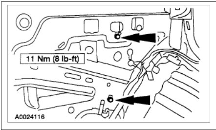

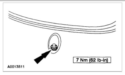

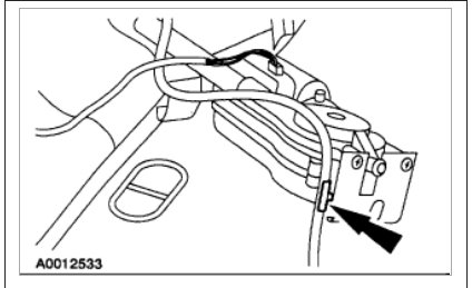

How to remove the remaining threads from where you screw in the antenna, or replace that piece completely?
Mar 22, 2010 at 1:55 PM
BLUELIGHTNIN6
  • 16,542 POSTS
Here are diagrams that show how to get the antenna out of the car so you can replace it with a new one there is no way to fix the threads once there are stripped you need to replace the whole unit.
