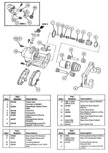

My '95 Taurus has a rear disc brake drag problem, as indicated by excessive heat and odor, smoke and/or pad/rotor wear/discoloration (and likely mileage), obvious when driven more than a few miles, right (R)side is more noticable than left (L), but both sides are similarly affected. I have seen very few posting on web about such a serious/annoying performance problem.
I have replaced the following without any effect: L&R side flexible brake lines (new), R side caliper (rebuilt), caliper bracket and slide pins (new), parking brake return spring (new), L&R rotors and pads, as well as the load sensing proportioning valve (salvaged). All with no change.
When jacked up and the road wheel removed, the rotor hub may be turned by hand with slight drag (deemed 'normal'), however if foot brake is depressed
the brakes are 'locked' (deemed 'excessive') until caliper is wriggled by hand.
What can account for this, how do I debug it and what is the cure? The car will soon be used for two new drivers about to enter the driving world so safety/reliability is a primary concern, but cost is also a consideration.

Here's gif I referenced in previous reply:
https://images.2carpros.com/forum/automotive_pictures/195089_95TaurusBrakeExplodedView_2.jpg

These will be an extra if your pins are loose! If they are too loose get new calipers, the holes have spread, and may be allowing the caliper to cock and missalign itself...

Never mind on the plastic, thats a different model, you pins slide into the mount, and altho they should move freely, they should not be loose, the mounting brackett may be worn out...

So, I've had a busy weekend. After reading a post about problems with the master cylinder [orifices being blocked], I replaced it with a rebuilt master cylinder from a local auto parts store, and while there, swapped the rebuilt right side caliper [which was still dragging] for another rebuilt one.
Upon reassembling and bleeding the system all seemed fine. Initial testing, with the rear end jacked up and road wheels off, indicated no brake drag after releasing the service brake pedal. My first road test however, was horrible. After only a five mile trip down a highway and back the smell of overheated brakes was evident, and now the LEFT wheel is the one affected, too hot to work on and visibly smoking.
So now what? Should I have the entire system flushed before proceeding further? If this were a common problem, I'm sure I would have read about it elsewhere. I'm seriously considering dumping the car, even after all this work and expense.

You still havent said if you looked at the fronts..Diagonal brake system...and if the ride hieght valve is set wrong you can get this, the is a pressure gauge used to measure the rear brake pressures, your must be too high, try re-adjusting the valve. Open the bleefer on that left caliper, does it spin? Three things back there that can cause drag, Hose, caliper, and parking brake cablee too tight, (pulling lever)And in your case, the hieght valve.

The front brakes (pads and rotors) have always looked and operated fine, no discernable heating, dragging, or abnormal wear. Despite 'diagonal' braking circuits, only the rear brakes have ever been problematic (dragging/heating), both similary affected at about the same time(?).
My latest endeavour was to replace the only items on the rear I had not; the Left Rear caliper and its bracket. This "seems" to have fixed the Left Side dragging for the time being, and I am now running cool on both sides so far.
I still do not understand the failure mechanism which affected only the rear brakes (never the front), gradually, over time - manifesting itself as heat and drag - with the only visible defects initially being the aging rear flexible brake lines (softened, outer layers cracking, but never leaking). Brake fluid, while bleeding lines throughout all this, always ran clean, never appeared to be discolored or to contain any foriegn particles of any kind.
In summary, I replaced both rear side pads, rotors, calipers, brackets, pins, flex lines, and parking brake return springs in order to "cure" this problem. In addition (and I suspect it was not absolutely necessary to), I replaced the load height proportioning valve and the master cylinder (out of frustration and desperation).
Thanks again for your input[s]... (and for keeping your fingers crossed over the next few weeks). I would still be interested how extreme, or common, the steps I took were to fix this, from someone with more experiance in these matters.
