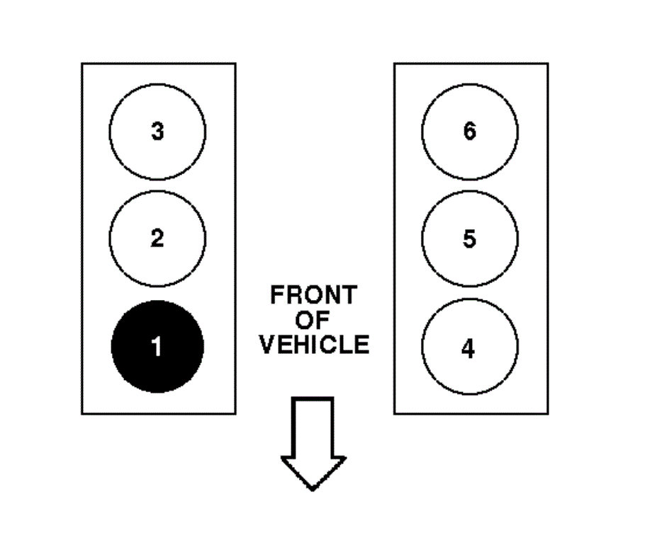

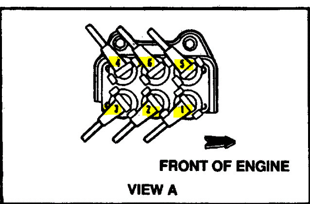

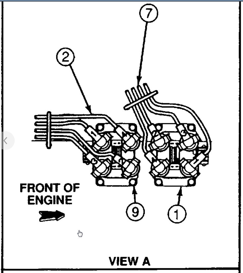

I recently took my truck to the shop to get my head gasket replaced and when I got it back it wasn't running as it use to. It is really rough and I think it might be misfiring. I also think that they put the plugs in the wrong way as in not the firing order. I would bring it back to have them do it, but I won't be able to until Saturday. Can someone help me out to see if the plugs are correct? Thank you very much.
Wednesday, June 9th, 2021 AT 1:58 PM (Merged)
  • 109,885 POSTS
Here is the firing order:
V6 Firing Order: 1 4 2 5 3 6
Picture 1 shows cylinder locations.
Pic 2 shows the coil. Note the arrow showing front of vehicle. I highlighted a number on each of the wires. Those numbers indicate which cylinder that wire should go to in the first pic I attached.

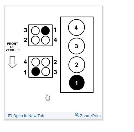

Need diagram of wires and the order they go on on the coil.

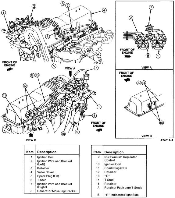

Hi Lisa,
Here is a diagram on the firing order and coil layout. Let me know if you need more information. Thanks

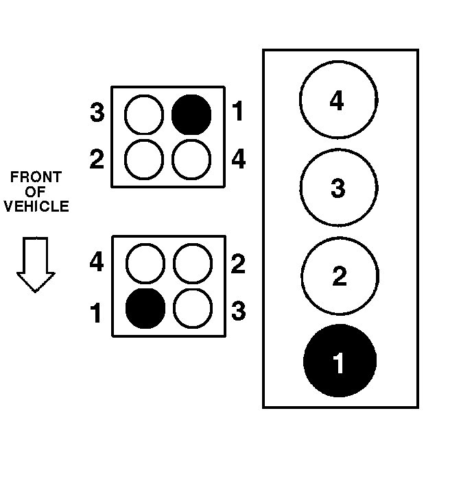

JDL
  • 16,098 POSTS
Hello, not sure if the picture answered your question? The cylinders are numbered 1234 from front to back. Check out the diagrams (Below). Please let us know if you need anything else to get the problem fixed.

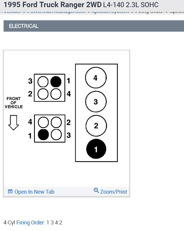

SMITTY53
  • 1994 FORD RANGER
Would like to know the firing order for a 2.3 in a "94" ford ranger extended cab and also why it stalls out when driving down the road
Wednesday, June 9th, 2021 AT 1:59 PM (Merged)
  • 75,992 POSTS
https://www.2carpros.com/forum/automotive_pictures/12900_f_8.gif
4-Cyl Firing Order: 1 3 4 2
Check the fuel pressure if it's within specs.

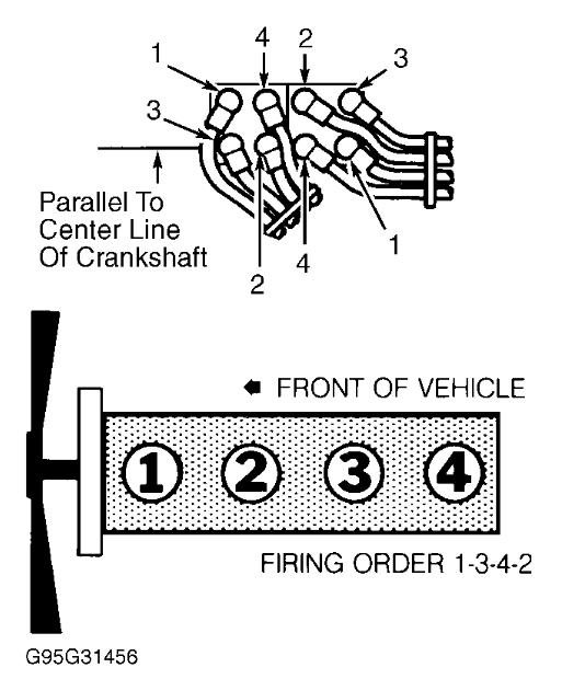

MIKEDEROUIN88
  • 137 POSTS
  • 1993 FORD RANGER
  • 180,000 MILES
I need to know the firing order and cylinder identification on a 1993 Ford ranger 2.3, I'm changing my timing belt and unsure of which cylinder to put at TDC
HMAC300
  • 48,601 POSTS
Here is firing order Number 1 is the front cylinder pica attached for timing marks. Check the diagrams below.
