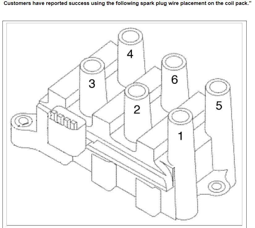

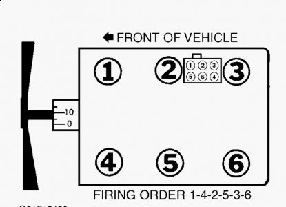

trying to figure out the firing and spark plug wire order?

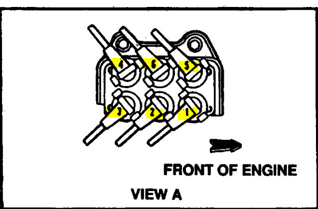

Sep 19, 2010 at 1:55 PM
  • 75,988 POSTS
"AllData Editors Note: Customers have reported success using the following spark plug wire placement on the coil pack."
https://images.2carpros.com/forum/automotive_pictures/12900_fo_154.jpg
Firing order 1-4-2-5-3-6

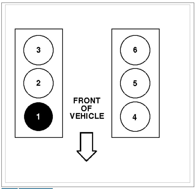

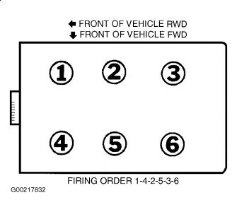

USNAVY
V6 FIRING ORDER
Jun 9, 2021 at 6:56 AM (Merged)
  • 75,988 POSTS
V6 Firing Order: 1 4 2 5 3 6

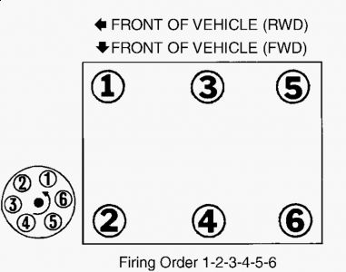

MERLIN2021
  • 17,250 POSTS
On 3.0 and 3.3 its the passengerside....02 is the first one you come to closest to the block, there is a socket made for the job, how much help it will be? They either come out easy, or they pull threads with em!
https://images.2carpros.com/forum/automotive_pictures/62217_FD3_1.jpg
Firing order for 3.3 is 1-2-3-4-5-6
https://images.2carpros.com/forum/automotive_pictures/62217_FD33_1.jpg

my husband is trying to figure out the firing order for spark plug replacment and also wires looked at a few diagrrams but could'nt make sence out of it. needless to say he is a bk yard mechanic in what particular order do the plugs and wires go????? don't know where plug # 1 goes front or back, pls help we don't have money for mechanic disabled and he can't read. any help would be greatly appreciated

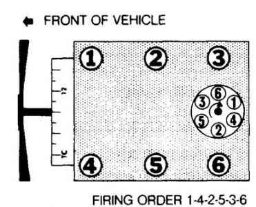

BLUELIGHTNIN6
  • 16,542 POSTS
3.0L and 4.0L Engines Firing order: 1-4-2-5-3-6 Distributorless ignition system
https://images.2carpros.com/forum/automotive_pictures/261618_0900c152801f14b7_1.jpg
Let me know if your engine size is different than 3.0L or 4.0L as this will change the firing order sequence.. Thanks for using 2CarPros.com!

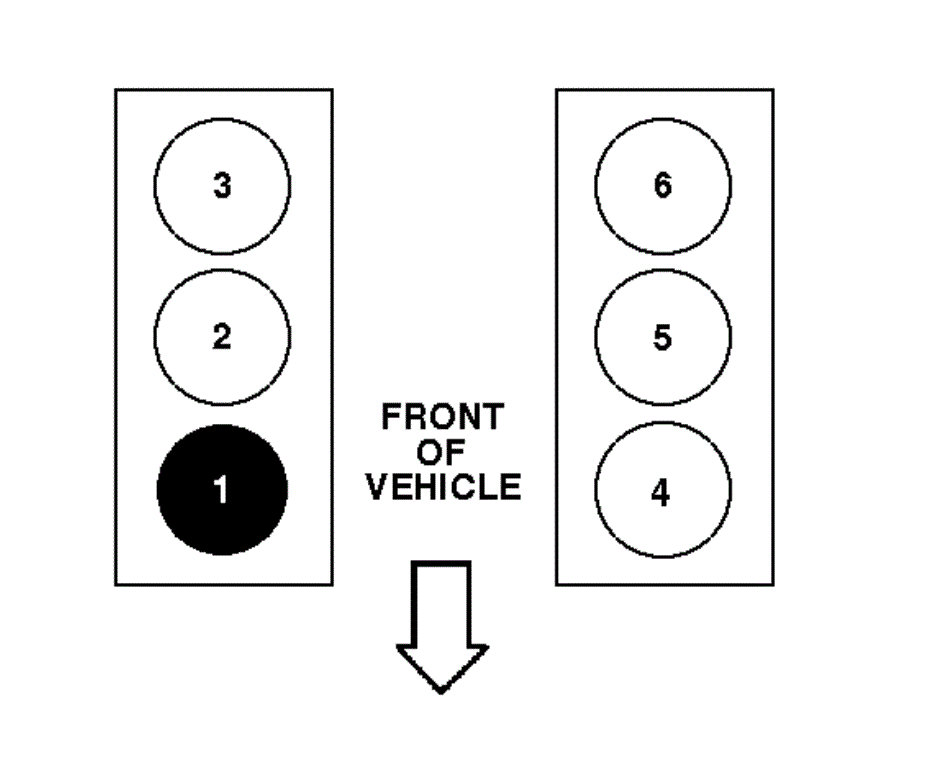

CODFISH25

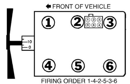

need to see firing order
  • 75,988 POSTS
https://images.2carpros.com/forum/automotive_pictures/12900_s2_56.jpg
https://images.2carpros.com/forum/automotive_pictures/12900_s1_62.jpg

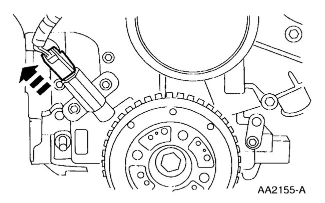

  • 110,251 POSTS
Coil pack need to be spun 180° to have the correct firing order on some models.
https://images.2carpros.com/forum/automotive_pictures/249084_5_1.gif
I was able to find this for you. Let me know if it helps. Crank sensor location is attached below, in case you need it.

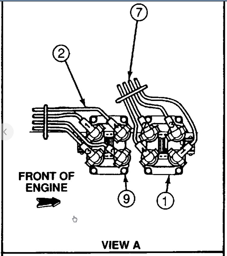

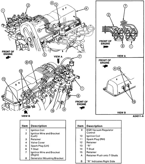

BKM97423
  • 49 POSTS
I asked you some questions last week about my truck. I ran in to high water going 55 mph and was able to drive it home but it wouldn't go over 30-40 mph. Next day it wouldn't start. I have got it started one time since then but I ran in my house to grab something and it shut off when I was in the house and wont start since. Okay, I have replaced plugs, wires, distributor cap, rotor, fuel filter, ignition coil and coil wire. I didn't put on new parts two guys did and I'm not confident in their ability so I am going to check the firing order for plug wires on distributor cap. Can you please tell me the proper firing order for my truck listed above. it only has four spark plugs not eight. Also, how do I take off throttle body to expose butterfly so I can spray starting fluid in it to try to get it to fire up? Thank you very much, Brenda Merritt.
Jun 9, 2021 at 6:57 AM (Merged)
Good morning, I attached a picture below for the wire arrangement on the coils. Roy

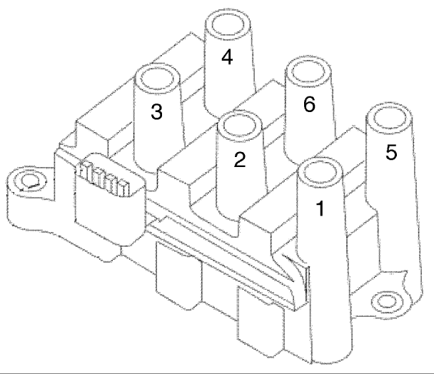

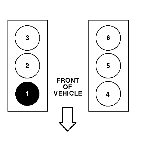

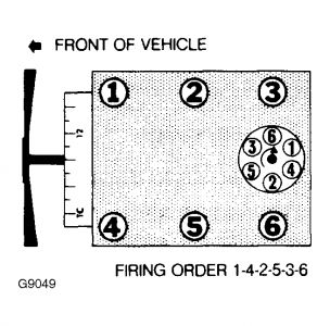

ANDREW-JOSEPH
I recently took my truck to the shop to get my head gasket replaced and when I got it back it wasn't running as it use to. it is really rough and I think it might be misfiring. I also think that they put the plugs in the wrong way as in not the firing order. I would bring it back to have them do it, but I won't be able to until Saturday. can someone help me out to see if the plugs are correct? thank you very much.
Jun 9, 2021 at 6:58 AM (Merged)

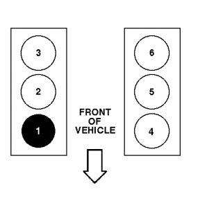

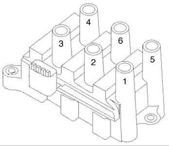

  • 110,251 POSTS
Here is the firing order:
Picture 1 shows cylinder locations.
Pic 2 shows the coil. Note the arrow showing front of vehicle. I highlighted a number on each of the wires. Those numbers indicate which cylinder that wire should go to in the first pic I attached.

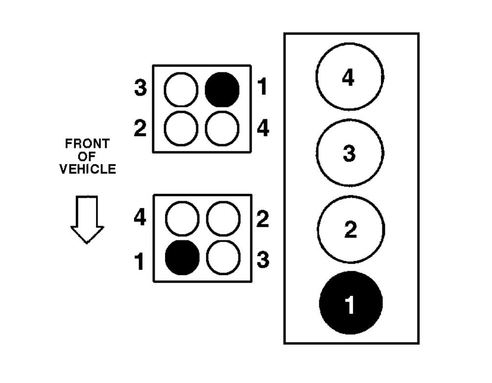

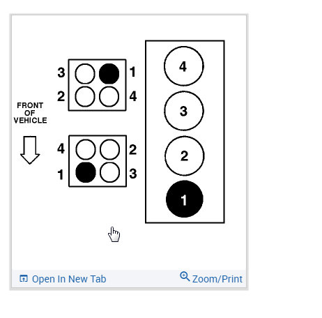

CHARLESSP7
how do i find the firing order has 8 spark plugs?
JDL
  • 16,098 POSTS
Hello, not sure if the picture answered your question? The cylinders are numbered 1234 from front to back. Check out the diagrams (Below). Please let us know if you need anything else to get the problem fixed.

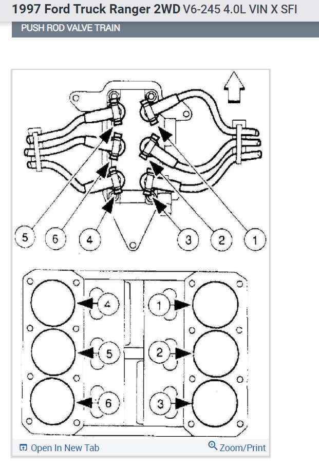

PA_HUNTER53
I need to know the proper wiring from the coil pack to the spark plugs. Bought the truck without an engine and the salvage yard engine had the wires pulled off. Would you have a diagram I could follow or directions
OBXAUTOMEDIC
  • 3,717 POSTS
Hello, Here the diagram... Firing Order for 2.9L & 3.0L
https://images.2carpros.com/forum/automotive_pictures/12900_fo_92.jpg
Firing Order for 4.0L
https://images.2carpros.com/forum/automotive_pictures/12900_fo4_2.jpg

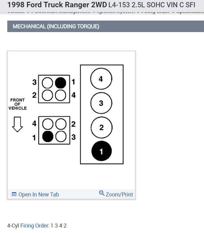

SMITTY53

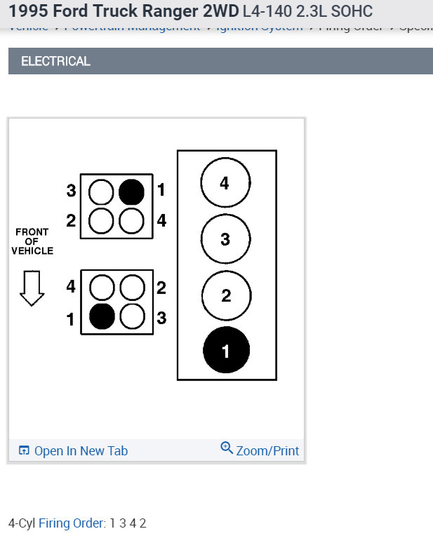

Would like to know the firing order for a 2.3 in a "94" ford ranger extended cab and also why it stalls out when driving down the road
Jun 9, 2021 at 6:59 AM (Merged)
  • 75,988 POSTS
https://images.2carpros.com/forum/automotive_pictures/12900_f_8.gif
4-Cyl Firing Order: 1 3 4 2 Check the fuel pressure if it's within specs. Key On Engine Off 35 - 45 psi Key On Engine Running 30 - 40 psi

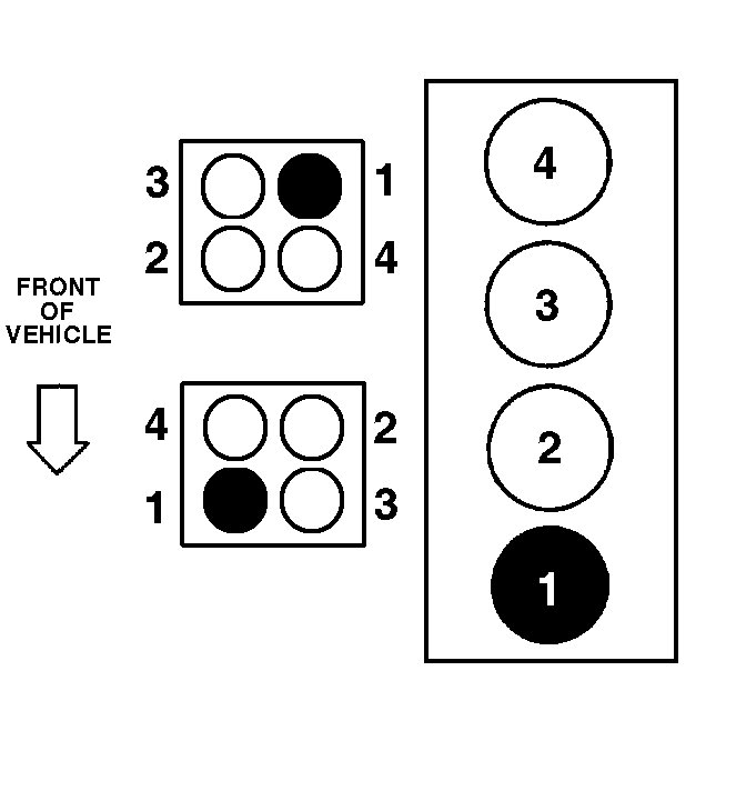

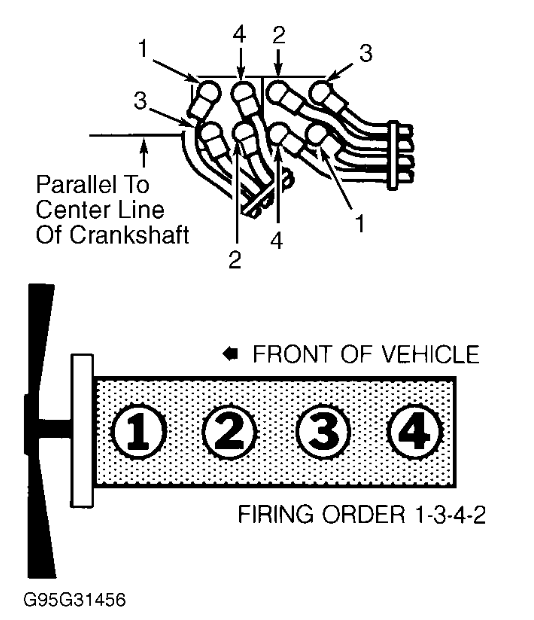

MIKEDEROUIN88
  • 137 POSTS
I need to know the firing order and cylinder identification on a 1993 Ford ranger 2.3, I'm changing my timing belt and unsure of which cylinder to put at TDC
HMAC300
  • 48,601 POSTS
here is firing order Number 1 is the front cylinder pica attached for timing marks. Check the diagrams below.
