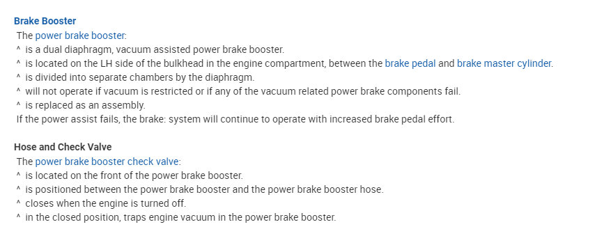

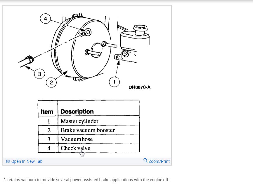

Hey guys. I have a 2003 Ford Ranger. This morning when i pressed down on my brake pedal, it initially stopped as usual about halfway to the floor, then proceeded to push all the way to the floor. The truck still stopped, but took longer. Then the brake dash light came on. I drove it straight home and parked it, but it continued to press all the way to the floor. I see no fluid loss on the driveway. After doing some research online, it appears that the culprit may be the master cylinder. Would you agree or should I try something else first before digging in and replacing it tomorrow? Any help would be appreciated. Thanks!
Apr 14, 2021 at 3:14 AM (Merged)
KTECH
  • 57 POSTS
Your master cylinder could be a possible cause, but before you do all that work I would inspect your brakes. check how much pad you have left and if they look like there starting to wear replace them. I had a similar problem on my explorer, although the pads went that and still had some meat left on them it was still taking almost all the pedal. The rear pads do the majority of the braking. I replaced the rear pads and bled the brakes and they havent caused me a problem since.

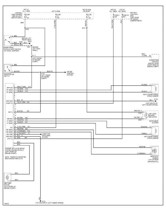

2001 Ford Ranger Intermittent loss of pedal pressure when braking. Master replaced, system checked and bled. Problem persists and getting more frequent. Told problem is probably ABS related but I can find little information on line. Actuator? If so does it require special tool to bleed after replacement? Is it possible to avoid dealer? Any on line manuals or diagrams?
Apr 14, 2021 at 3:15 AM (Merged)
  • 110,244 POSTS
As far as online manuals, I can never find them when needed. I will tell you that Mitchel online is a manual available via the internet, but you pay to use it. It is extremely informative. I believe you can access it via our home page. It is cheaper than purchasing a manual at a store and includes all makes and models.
As far as the problem, I can't see how the ABS is giving you a soft pedal. When it happens, does the ABS actuate? Have you checked the rubber brake hoses to the calipers on the front? I have seen them (when they get old) actually expand when pressure is applied to them. Thus, you get a soft pedal. Also, has everything been checked as far as the wheel cylinders and calipers for leaks? I must say this, for some reason, Fords, between 1999 and 02 seemed to have a rust problem with the underside of the vehicle. Make sure there are no steel lines with slight holes.

Chuck:
The ABS actuator can bypass as a master cylinder, but I have to admit, it doesn't happen often. If you keep steady pressure on the brake pedal, you said it doesn't drop. Usually, when you have a bad plunger / seal in a master cylinder or actuator, it will slowly drop. You most likely already know that based on everything you mentioned. I just thought I would mention it. I can understand your concern with this issue. I can't completely eliminate the actuator. It can be the problem, just an unlikely one. If everything else is good, that must be where the problem is coming from.
Chuck, I have access to Mitchel Ondemand. Let me know if there are certain diagrams you want. I will check to see if I can find them for you and upload them. They have a lot of information on there. I attached a schematic for you to review. Also, I am questioning the BPS. Have any codes been recovered from the system?

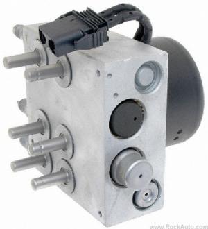

Joe, Now I am stumped. Raybestos has stopped remanufacturing the actuator and OEM suppliers are saying that Ford the part is no longer available.
Any idea where I can get a replacement? Something is wrong here and no one is talking. I am wondering if these are a bad design and no one is talking?
Chuck
  • 110,244 POSTS
I don't know of any specifics. The manufacturer is required to make replacement parts available for 10 years. That makes the end of this year 10 years. I would contact the customer service rep listed in the owner's manual and see what they have to say. Also, have your dealer search their computer to see if there is another dealer in the country that has "Dealer Old Stock" (DOS). I feel confident they could find them that way. The truck isn't that old. Also, have you checked salvage yards?

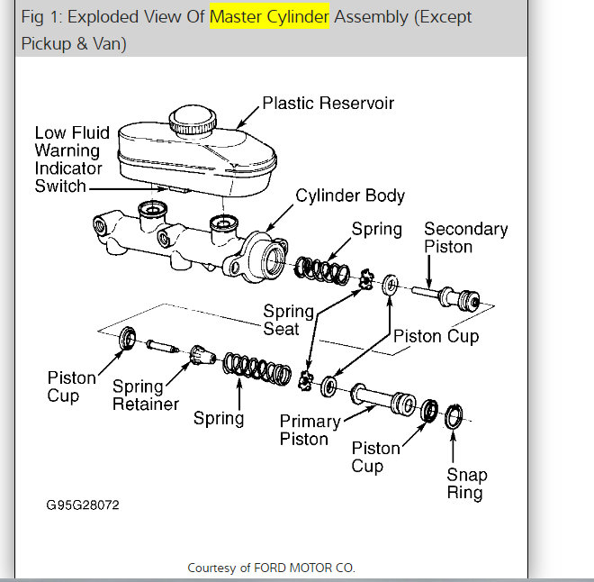

I replaced the master cylinder seals and the cylinders are not leaking any fluid. When i step on the brakes nothing is happening no brakes at all. what can be the problem?
Apr 14, 2021 at 3:16 AM (Merged)
BMDOUBLE
  • 1,139 POSTS
Either the new seals are not conforming to the bore, or the bore is not concentric or pitted, and of course the possibility of air in the lines. I've never has luck rebuilding master cylinders due to those variables. If the system has been bled thoroughly, the only thing left is the integrity of the master cylinder itself.

This could be a problem with air in your system. Did you make sure to bleed the air out of the system? Here is a link down below for you to go to explaining how to do this:
https://www.2carpros.com/articles/how-to-bleed-or-flush-a-car-brake-system

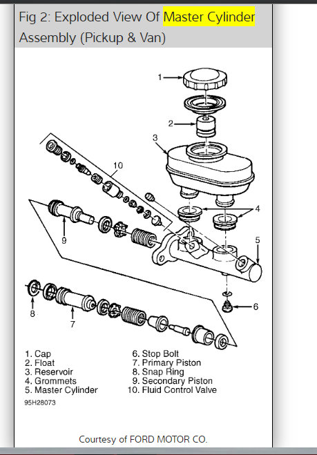

I have also included exploded diagrams of both brake master cylinders that are used on your vehicle as well as a factory troubleshooting guide for the master cylinder in the diagrams down below for you. Please go through these guides and get back to us with what you are able find out.

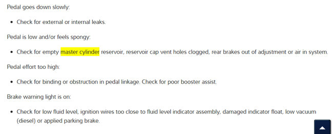

TMORRISON80

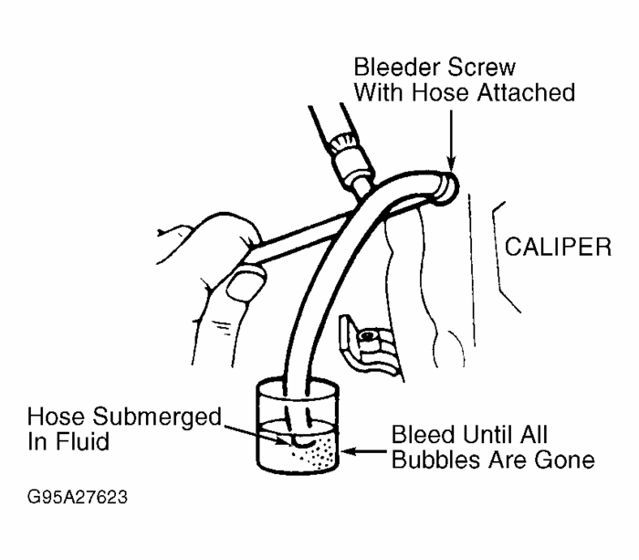

Hello, i had to replace the front to back brake line from it rusting in two, i also had to replace the front right caliper. After doing so I filled the master, bled the brakes multiple times, starting RR, LR, RF, LF. And still the pedal does not get very hard and when I start the truck now the ABS light is on and the pedal goes right to the floor when running and the brakes wont work at all, but while bleeding the pedal will get stiff and as long as I'm holding pressure on it, it stays stiff but as soon as I let off the pedal for a few seconds when I push it again it goes back to the floor.
I have checked to see and there are not any leaks, I did notice that the new LF caliper has the bleeder located toward the bottom of the caliper, could it be the parts store gave me the wrong part and maybe have air trapped in the new caliper due to the bleeder being located toward the bottom of it?
I'm kind of lost as what else to do.
Thanks
  • 110,244 POSTS
Welcome to 2CarPros.

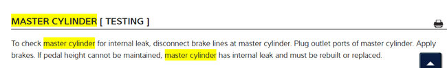

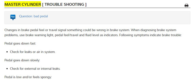

If you have bled the system and are getting no more air, I suspect the mater cylinder has failed. Often times, the plungers in the MC fail when the pedal originally goes to the floor because they travel into a portion that is old, corroded, and damage the plunger. If you have no leaks and the system is bled, you can pump the brakes up with the engine off and it goes to the floor when started, I suspect the master cylinder.
https://www.2carpros.com/articles/brake-pedal-goes-to-the-floor
https://www.2carpros.com/articles/how-to-replace-a-brake-master-cylinder
As far as the bleeder, it shouldn't be pointing down. Is it possible they sold you the caliper for the opposite side of the vehicle? That's what it sounds like.

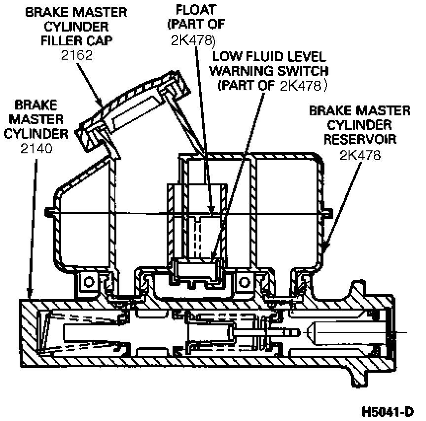

Here are the directions specific to your vehicle for master cylinder replacement:
_____________________________
1995 Ford Truck Ranger 2WD L4-140 2.3L SOHC
Removal and Installation
Vehicle Brakes and Traction Control Hydraulic System Brake Master Cylinder Service and Repair Procedures Brake Fluid Reservoir Removal and Installation
REMOVAL AND INSTALLATION
REMOVAL
1. Disconnect the brake warning lamp indicator wire from the plastic reservoir fluid level indicator socket. Drain the brake fluid from the brake master cylinder.
pic 1

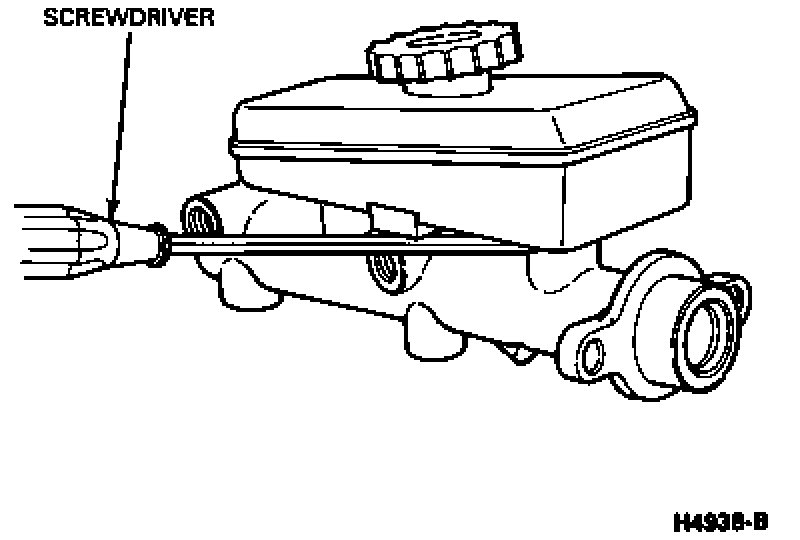

2. Using a large screwdriver, pry between the brake master cylinder reservoir and the brake master cylinder and remove the brake master cylinder reservoir.
Master Cylinder Reservoir
Pic 2
CAUTION: Whenever the brake master cylinder is replaced, the brake tube grommets (2k409) must also be replaced or leakage may occur causing brake system failure.

You know, I'm sitting here thinking about the caliper. If the bleeder is pointing downward, I don't think you could get the air from it. Is the caliper on the opposite designed the same?
TMORRISON80
Thanks for all the information on that. Yes, they did sell me the caliper for the wrong side, I needed the front right and they ordered the front left, i looked online and the part number is one digit off. The new correct caliper should be in Wednesday. So this is a dual piston caliper and the bleeder for the one I had was just above the lower piston which would have made it on top if it was installed on the drivers side. Plus when i was bleeding that caliper that ended up being the wrong one the fluid barely trickled out while the other 3 wheels bleed with a lot more pressure.
