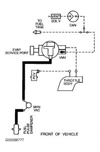

Here is a pic of the vacuum system and the pcv valve vacuum is included hope this helps with finding it. Let me know how it goes and if your problem is still there let me know and we will see what else could be wrong.
