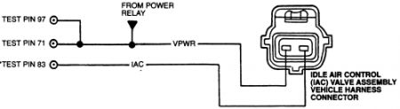

Let me explaine... The Idle Air Control (IAC) valve controls the engine idle speed. The valve is located on the side of the throttle body. This valve allows air, determined by the Powertrain Control Module (PCM) and controlled by a duty cycle signal, to bypass the throttle plate in order to maintain the proper idle speed. Here is a picture of yours.
https://www.2carpros.com/forum/automotive_pictures/249084_5_85.jpg
Does the description I listed sound like it could fix the problem you are dealing with?
Also, rather than purchasing one, you can check your own. Turn the ignition switch to the OFF position.
Disengage the wiring harness connector from the IAC valve. Using an ohmmeter, measure the resistance between the terminals of the valve. Due to the diode in the solenoid, place the ohmmeter positive lead on the VPWR terminal and the negative lead on the ISC terminal. If the resistance is not 7-13 ohms, replace the IAC valve. Here is a picture of the electrical leads.
https://www.2carpros.com/forum/automotive_pictures/249084_5_86.jpg
I hope this is helping and not confusing you. Let me know if you have other questions. Just trying to save 50 bucks if possible.

I replaced the IAC. The truck is running a little more smooth but it does still sputter and die. Only died one today. I will look into the vacume system this weekend and get back to you.
Tuesday, April 16th, 2019 AT 11:57 AM
  • 109,896 POSTS
Did the IAC test bad? One other question, have you checked the EGR to make sure it isn't plugged with carbon as well as the intake where it bolts?
