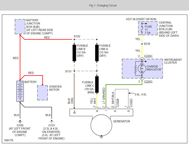

I would have the battery tested just to make sure it was good. Here is guide to help you do that.
here is a guide and wiring diagram (below) so you can do some testing.

Alright here's what you need to check next the black and orange wire to the B+ terminal on the alternator should have battery voltage to it.Also check the yellow and white wire terminal A at the alternator should have battery voltage also.Let me know what you find.

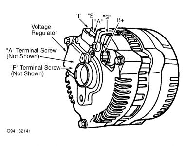

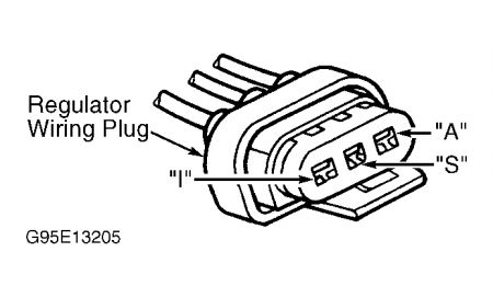

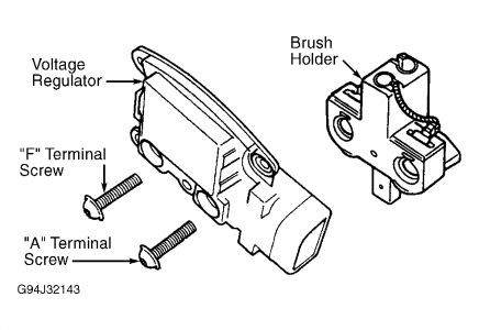

On the alternator with the battery disconnected the two S terminal's there is a white and black wire running to those two terminal's see if those two terminals are connected from post to post.
Oct 30, 2010 at 5:50 AM
EVILPUPPETMASTER
  • 16 POSTS
ok, i disconnected positive wire from the battery, There are 3 wires on the voltage regulator, yellow/red, white/black and green there is another white wire going to another terminal. Please see picture: which wires do you want me to test do you want me to test those terminals with or without cables connected thanks for your help. Alex
https://images.2carpros.com/forum/automotive_pictures/586217_alt_1.jpg

You checked the fuse link's to the alternator already.The black and orange to the B+ terminal you said had battery voltage.Also the yellow and white wire is the other fuse link to the alternator and you said it had battery voltage.If you look at the wire diagram i sent you it show's a white and black jumper wire that run's from the two S terminal's from the pic of the alternator you posted look's like that wire all by itself is that jumper wire that goes to the voltage regulator peel the tape back and see it that wire lead's to the white and black wire to the voltage regulator connector.Remove the battery cable first then use the low ohm's setting to see if the black and white wire is connected to the wire off by itself with all the wire's discounted.Let me know what you find.

Ok, black and white wire is connected to the wire off by itself. There is a continuity between those two.

This is crazy you have everything your supposed to according to the diagram.You have the two power feed's and the jumper wire the only one let is the charge light wire which has nothing to do with it charging.So with all the wire's hooked up and the engine running what does the B+ read for voltage?

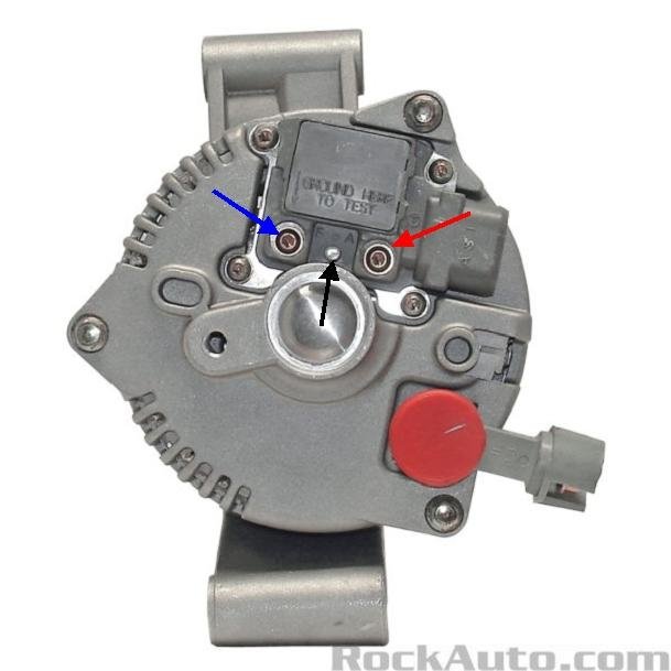

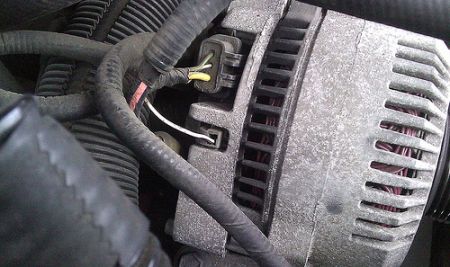

Starting in the early 2000's, the engineers put an extra cover on the rear of their generators because they found them to be too easy to diagnose. If yours does not have that yet, look for the two test points on the back and measure those voltages. The right one with my nifty red arrow might have a gray plastic cap on it. That can be popped off or there will be a tiny hole in the center where you can fit the end of a straightened paper clip to take the reading. You should find twelve volts there all the time.
Before you move on to the next test, look at the black arrow in this photo and the silver button it is pointing to. Check if that is on your generator, or a wooden tooth pick, or piece of wire. I picked this photo because it shows the "nail" that holds the brushes retracted while the voltage regulator/brush assembly is being installed by the re-builder. They were supposed to remove that before testing the generator. If you see anything in that tiny hole, pull it out. You will hear two light clicks as the brushes extend to make contact.
Once that is removed, or if you do not find anything in that hole, you can move on to the next test. Check for voltage on the left test point, (blue arrow). If you find exactly the same as at the red arrow, the voltage regulator is defective. You can verify that by grounding the blue terminal. That will make the generator charge wide open, so do not raise engine speed. You will see battery voltage rise and/or the head lights will become brighter. You will hear the generator strain under the load too. Just ground that terminal long enough to get the results.
If you find zero volts at the blue test point, there is a break between the brushes. That is a typical failure at high mileage when the brushes are worn excessively, but not with a newly-rebuilt generator. I would be looking for a brush that got broken when an inexperienced person put it together and forgot to use the tooth pick to hold the brushes retracted until they were installed.
Under normal operation with the engine running, you can expect to find between roughly four and eleven volts on the blue terminal. The lower the voltage regulator pulls that down, the bigger is the difference between the two test points, the stronger is the magnetic field, and the more output current will be developed.
Tell me the voltages you find.

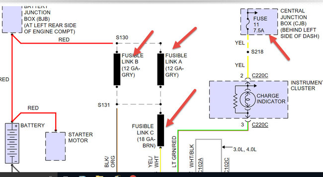

check fuse and fusible links one may be burnt out that is not supplying power to activate it. See picture these are available at auto parts and must be the same gauge.

I would try to use a small mirror to look at the back of the generator to see if that tooth pick is still in there. Next, since you cannot get to the test terminals, consider unbolting the generator so we can do some continuity tests on the work bench.
Measure between the "ground here to test" terminal, (blue arrow in my sad photo), and the twelve volt feed terminal, (red arrow). You should find very close to 4 ohms, but be aware the brushes commonly do not make a good connection when the rotor is not spinning. You may have to turn the pulley a little to get a reading.
As long as the plug is disconnected, recheck the voltage on the large black/orange wire and the yellow/white wire, but use a test light instead of a digital voltmeter. Both of these circuits are protected by fuse link wires which are just normal wires but of a small gauge. If one of those burns open, it will leave a carbon track behind where it arced inside the insulation. That carbon is more than enough to let a tiny tickle of current through that a voltmeter can see the twelve volts, but there is no way you are going to get enough current through there to run the voltage regulator. There is also no way you will get enough current through there to run a test light. That is why the test light is more accurate for this type of test.

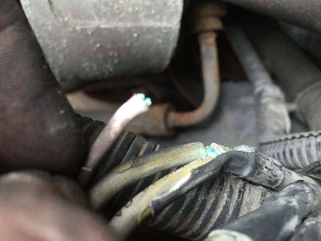

Any idea which fuse it is in the engine compartment? The fuse in the cab seems to just run the battery voltage meter. It is good.
I am checking the fuse links now.

Just green dust left in the end of the fuse links. Lol.
Thanks for the help man, I hate wiring and you saved me on this one.
How do I go about replacing these without going to a Ford dealership?

RONALD OLSTHOORN
  • 6 POSTS
I stand corrected. Both the black/orange and the yellow white, at the alternator, illuminate the test light?
Any other ideas?

you look at the diagram I sent and see what gauge it is then go to auto parts and buy one of comparable length and splice it in preferably by soldering it then shrink tube where you spliced it to protect it.

Next is to ground the "ground here to test" terminal while the engine is running. That bypasses the voltage regulator and makes the generator charge wide open. Do not raise engine speed because if the generator is working, system voltage can rise too high and do a lot of damage. I turn on the head lights so I can watch their brightness change, but you can do the same thing by watching a voltmeter or test light connected to the battery terminals. All generators are very inefficient at low speeds, but you still want to do this test just long enough to get the results, then you are done. This should only take a couple of seconds.
If the lights get brighter when you ground that terminal, the generator is working, (at least partially), and the voltage regulator is defective.
If there is no change when you ground that terminal, there is a bad connection on one or both brushes. There are other potential causes, but they are very uncommon. You will find worn or broken brushes 99.9 percent of the time.

BMRFIXIT
  • 19,053 POSTS
1.Measure voltage between ground and generator terminal B+ (Black/Orange wire)
https://images.2carpros.com/forum/automotive_pictures/99387_Graphic1_185.jpg
. If battery voltage is present, go to next step. If battery voltage is not present, repair open in Black/Orange wire between generator and battery junction box. 2.Disconnect generator 3-pin harness connector. Measure voltage between ground and generator harness connector terminal "A" (Yellow/White wire). If battery voltage is present, go to next step. If battery voltage is not present, repair circuit between battery and generator. 3.Turn ignition on. Measure voltage between ground and generator harness connector terminal "I" (Light Green/Red wire). If voltage is equal to battery voltage, go to next step. If voltage is not equal to battery voltage, repair open in Light Green/Red wire between generator connector and instrument cluster. 4.Connect generator 3-pin harness connector. Start engine and let idle. Measure voltage between positive battery terminal and generator terminal B+ (Black/Orange wire). If voltage drop is less than 0.5 volt, replace generator. If voltage drop is 0.5 volt or more, repair circuit between generator and battery.
https://images.2carpros.com/forum/automotive_pictures/99387_Graphic2_90.jpg
https://images.2carpros.com/forum/automotive_pictures/99387_Graphic3_43.jpg

RONALD OLSTHOORN
  • 6 POSTS
I cannot see which terminal it is? The alternator is mounted again and your picture is not quite in focus enough?
Thanks.
