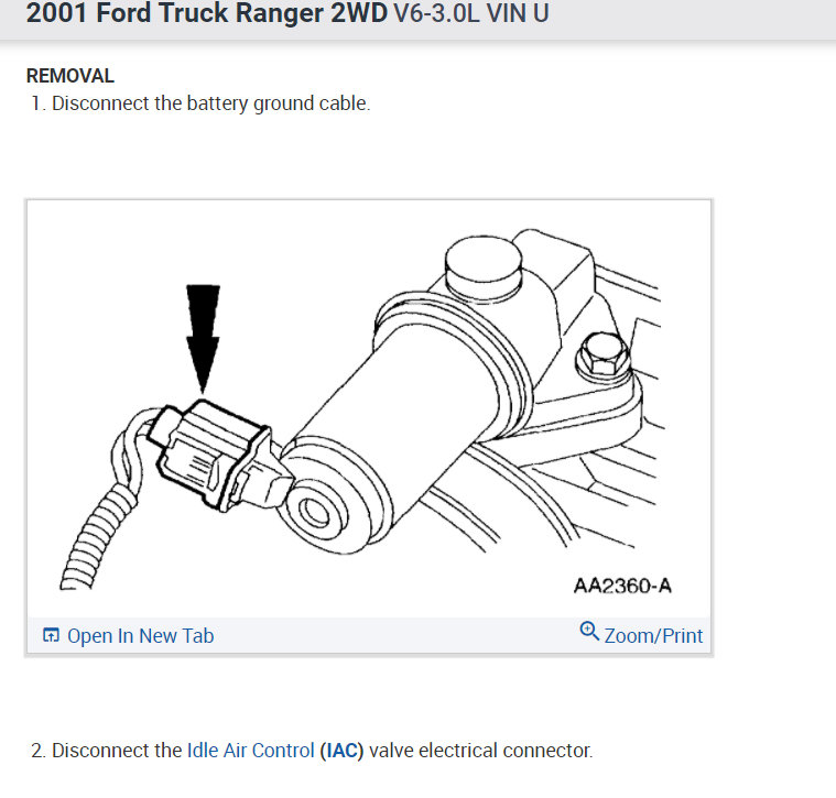

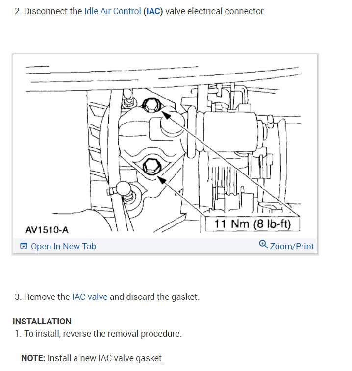

Okay, I need help. I just had a mechanic put a new/used motor in my truck. It runs smooth and quiet, but there is a problem, it won't stay running. We put a new mass air flow sensor on it and a couple other new parts that I don't think have anything to do with the problem. If you unplug the wires that go into the idle air control valve the truck will start up and idle. If you plug it in, the truck shuts off. Also, the oil pressure gage when you are starting the truck jumps erratically from 0 to mid way instead of just moving up, it jumps. My mechanic and I are both almost done, can not figure this out......Can you show me how to replace the IAC PLEASE HELP!!
Nov 22, 2009 at 8:25 AM
MERLIN2021
  • 17,250 POSTS
It does sounds like the IAC is not working correctly here is a guide to help walk you through the steps to replace it with diagrams below to show you how on your car.
https://www.2carpros.com/articles/how-to-replace-an-idle-speed-control-motor-iac
and
Nov 22, 2009 at 8:31 AM
SSCATHERINE
That fixed it! thanks for the guides they helps help this site is great.

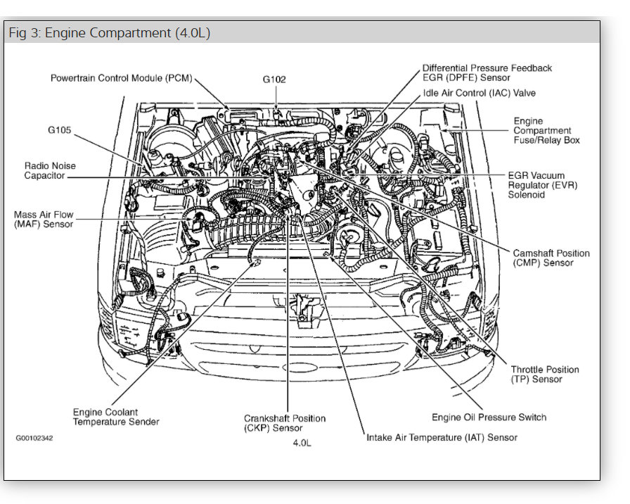

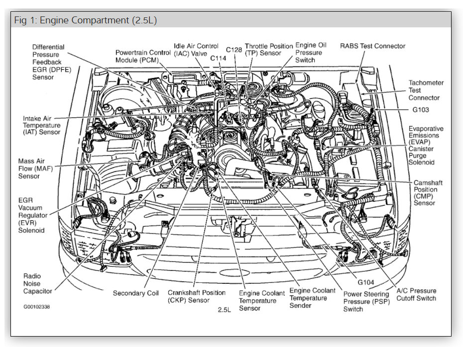

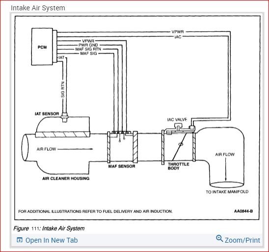

DAVID KITE
I have 1998 Ranger 2Wd, 2.5 liter engine. When I push the clutch in to coast to a stop the engine continues to race at high RPM. If I let out the clutch the engine is dragged down to appropriate speed, but if I push the clutch back in the RPMs race back up to high speed until I come almost to a complete stop. Then the RPMs drop to idle speed.
Oct 9, 2020 at 9:49 AM (Merged)

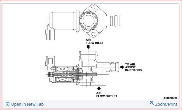

DANLESABRE
  • 230 POSTS

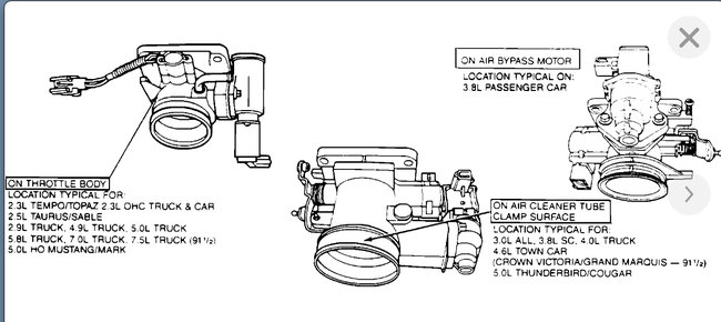

This sounds like the IAC needs to be replaced here is the location in the diagrams below. Check out the diagrams (Below). Please let us know what happens. HEre is the IAC location in all three engines that come in your truck.

DAVID KITE
The Check Engine light wasn't on until TODAY! It just came on, so I don't think that was the cause. I think that is just another symptom.
The problem seems to be worse when the A/C is running. I'm in Texas so that's just about all the time. When I push in the clutch to coast to a stop the engine races at about 3K RPM until I come almost a complete stop. Then it slows to idle speed.
Another thing...when the A/C is on and at idle, like at a stop light, the engine surges to about 1200 RPM for a few seconds then slows to about 600 RPM (pretty slow), almost slow enough to die, for the same amount of time. It alternates back and forth unto the light changes and I start up. It doesn't do that when the A/C isn't on.
Thanks for your help on this. I'm stumped.

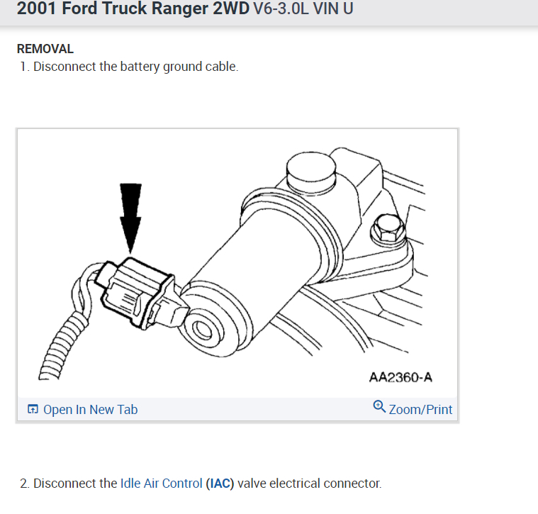

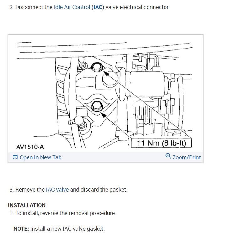

94 2.3 RNGRDNGR
Reset IAC and how to adjust AutoZone IAC it's adjustable an the factory Ford is not. I need to figure out how to reset the IAC on my truck the sequences and find out how to adjust AutoZone adjustable IAC for my 2.3. it is the $70.00 IAC.
Oct 9, 2020 at 9:50 AM (Merged)
SCGRANTURISMO
  • 4,897 POSTS
There is no reset for your vehicle's IAC Valve. It is controlled by the electrical connector which goes to the Power-train Control Module[PCM] or "computer". If the IAC Valve goes bad, it is simply replaced. Here is a link below for you to go to:
https://www.2carpros.com/articles/idle-air-control-valve-service

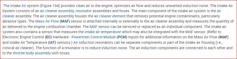

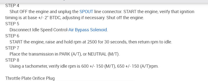

AARONWELLS1919
My car normally starts at 2,000 rpm than drops to 1,000 slowly. First time today it started at 1,000 rpm than bog down quickly to 500 rpm and continued, turned it off and over again same thing happen. Trying to run diagnostic but I'm lost and can't figure it out. Sometimes when it sits for a bit and is turned on it will start normally and will drive normally, other times it just sit there and bogs down.If the vehicle is turned off and on even minutes after it will start at a low rpm again than bog.I started my vehicle today it was a bit low on gas so I thought that was my issue, filled it up and I thought the issue was fixed. But like I said when I turn off, than on minutes later it will start at a bog.
Hi Aaron,
This could be an IAC but usually when these fail, the engine starts and shuts off quickly. However, if it feels bogged down then this could be due to a restricted air flow. The other thing it could be is the MAF itself. Sometimes these get dirty and they send incorrect readings to the PCM so it causes rough running or idle issues.
Here is a video on how to test the MAF. It is easy enough that I would start with that and go from there. Worst case you can test and replace your sensor if needed and then clean your IAC and see what happens. I included videos for both. Please understand they are not exact for your vehicle but the theory is the same.
Let me know if you have questions or what results you turn up and we can go from there. Thanks

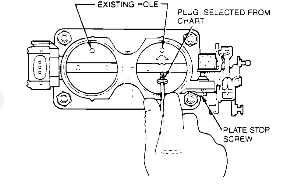

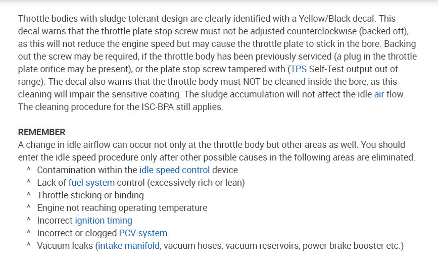

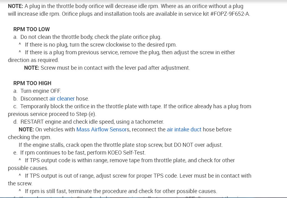

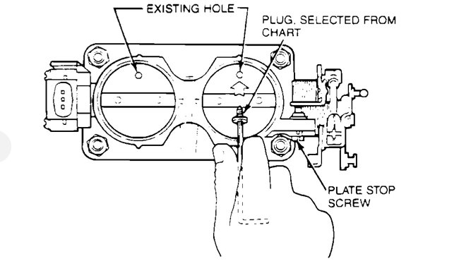

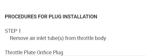

SCGRANTURISMO
  • 4,897 POSTS

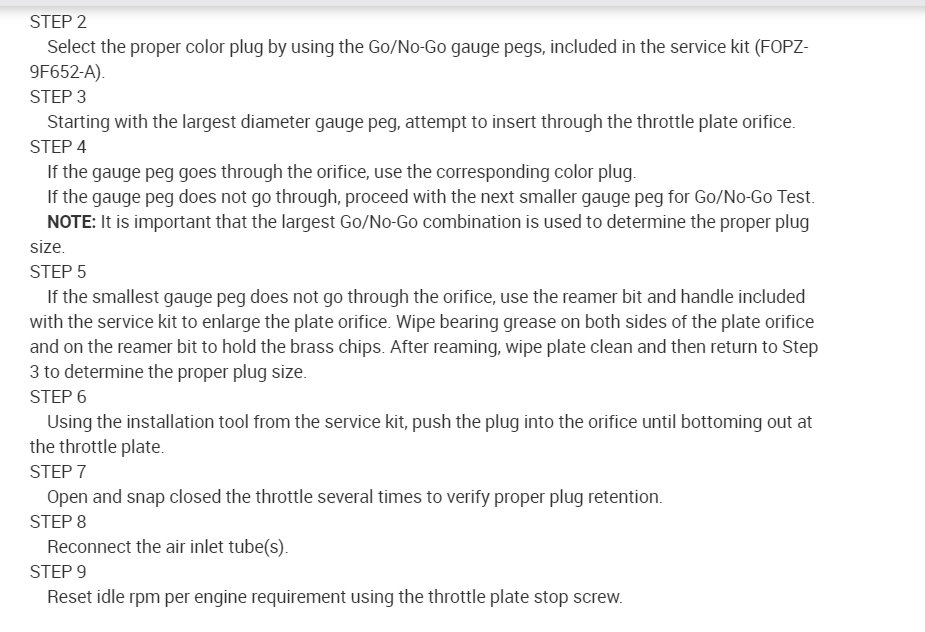

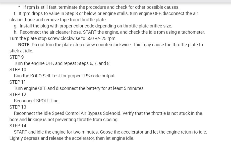

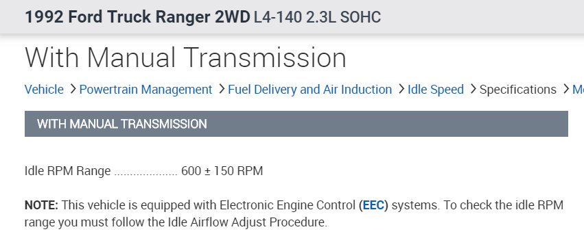

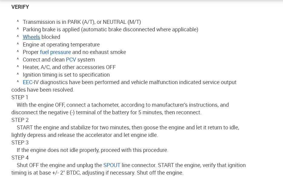

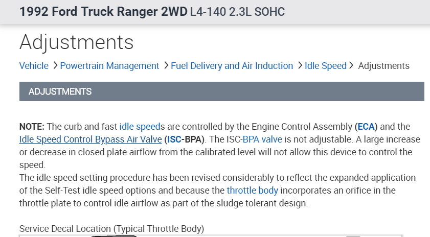

This could be a problem with your Idle Air Control Valve (IAC). I have included in the diagrams below the Ford Motor Company adjustment procedure for your vehicle's air control including what your idle speed should be set at . Please go through the guide and get back to us with what you are able to find out.
Thanks,
Alex
