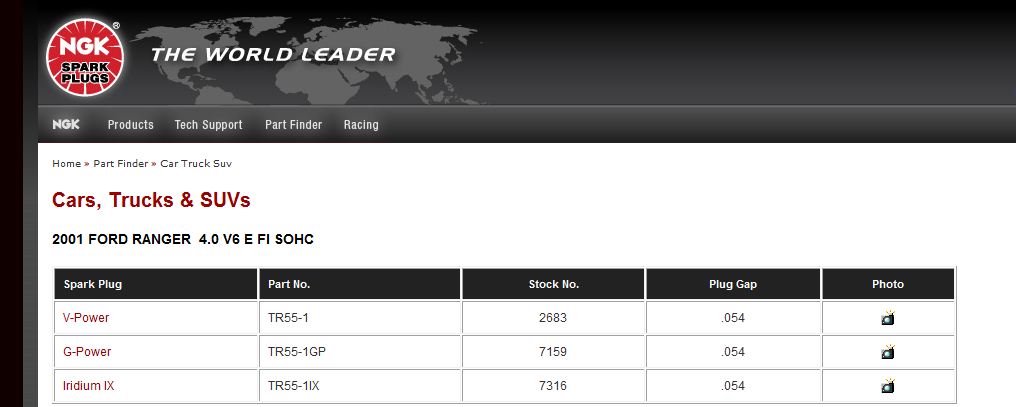

I bought some plugs for my truck and it turned out they were too long when I screwed them in it bent the tips of the plugs and I have read about the ohv and sohc use same plugs but that they don't like eachother so what plugs from napa. Will fit my truck I would like to stay with the brand autolight or ngk thanks
Jan 2, 2019 at 7:54 PM (Merged)
MHPAUTOS
  • 31,937 POSTS
See pic for application chart.

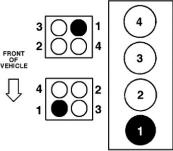

MOSMITH
sparkplug wiring sequence for 2.3 liter
May 19, 2019 at 11:10 AM (Merged)
  • 75,992 POSTS
4-Cyl Firing Order: 1 3 4 2
https://images.2carpros.com/forum/automotive_pictures/12900_fo_96.jpg
