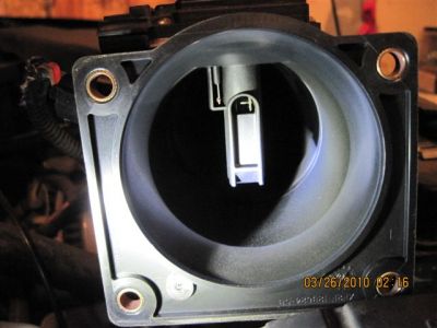

MACKISUS
  • 8 POSTS
OK racefan I sprayed the wires see pic. Reset code at neg bat terminal. The CEL usually comes on after 3 days of driving. Wait and see. Thanks.

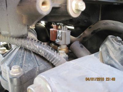

MACKISUS
  • 8 POSTS
I can't get to the sensor w/o much difficulty. Would it be the one that's gray or red? When you say to "ohm" it, I think you mean to take off the connector and take a resistance check between the two terminal ends right?
https://images.2carpros.com/forum/automotive_pictures/506220_sensors_2.jpg
Apr 2, 2010 at 12:57 PM
RACEFAN966
  • 5,029 POSTS
Ok this sensor should be next to or very close to the thermostat housing. Yes just unplug it and check resistance between terminal ends on the sensor not the wiring harness. Check pics below it also depends on the engine it may look different. Don't know if yours is 3.0 or 4.0 V6.
