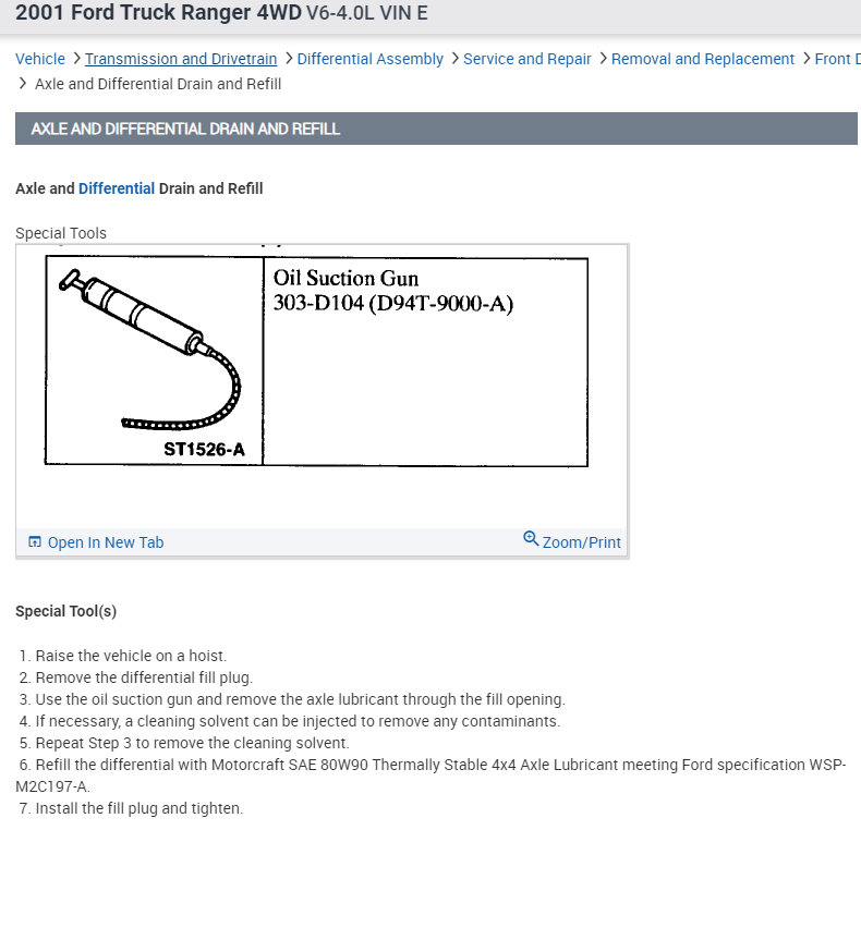

what are all the fluids for a 2001 ford ranger XLT 4X4 v6 4.0? also what is the front and rear differential?
Oct 27, 2009 at 11:47 AM
SQM
  • 6,383 POSTS
This vehicle uses 80W-90 gear oil for both of the front and rear differential.
The front differential has a capacity of 1.7 litter (1.8 quart) and the rear differential capacity is 2.4 litter (2.5 quart).
The fluid can be changed easily using a oil suction tool.
Here are couple of helpful guides:
