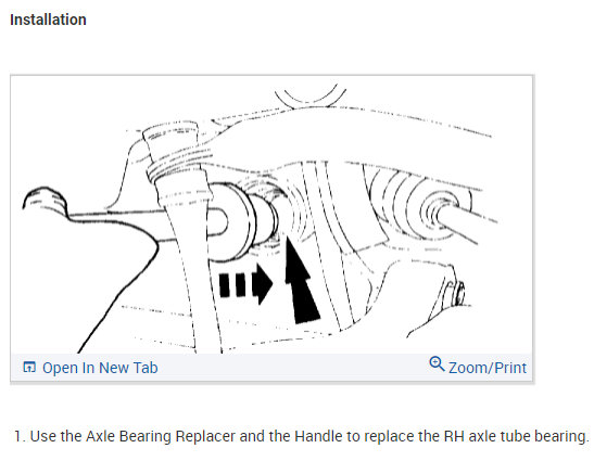

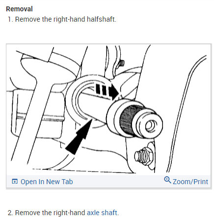

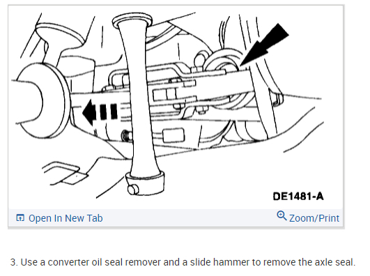

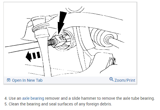

I need to replace bearings and seals on the front left side?
12,000 MILES • 6 CYL • 4WD • AUTOMATIC
ACFR0053

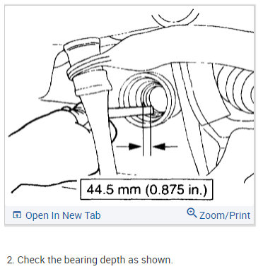

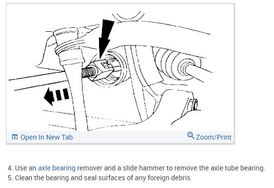

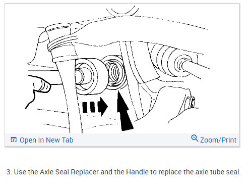

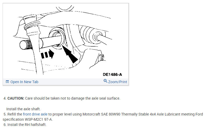

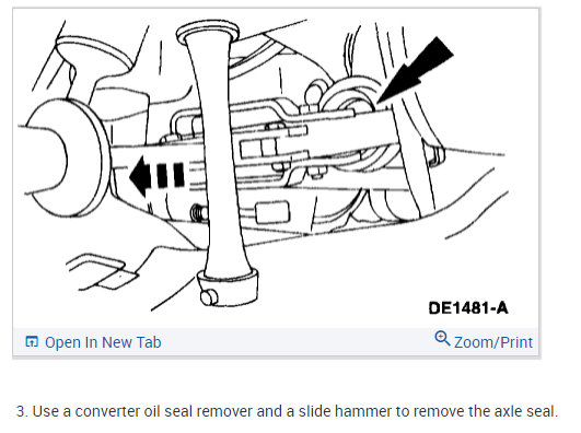

I need to replace bearings and seals on the front left side drive axle coming out of differential. How does one go about doing such?
Jan 7, 2009 at 7:03 AM
DANNY L
  • 5,648 POSTS
Hello, I'm Danny.
Here is the information you requested. You must first remove the CV axle to gain access to the differential bearings and seals. Here is a tutorial showing how to remove and replace CV axles:
https://www.2carpros.com/articles/replace-cv-axle
I've attached picture steps below on how to replace the front differential axle bearings and seals on your truck. Hope this helps and thanks for using 2CarPros.
