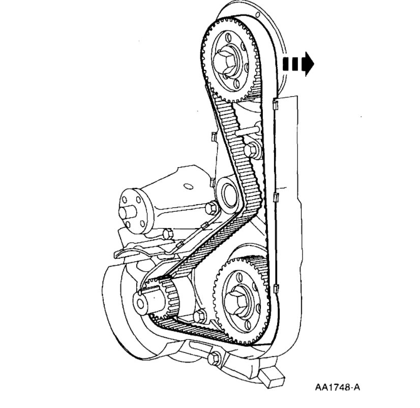

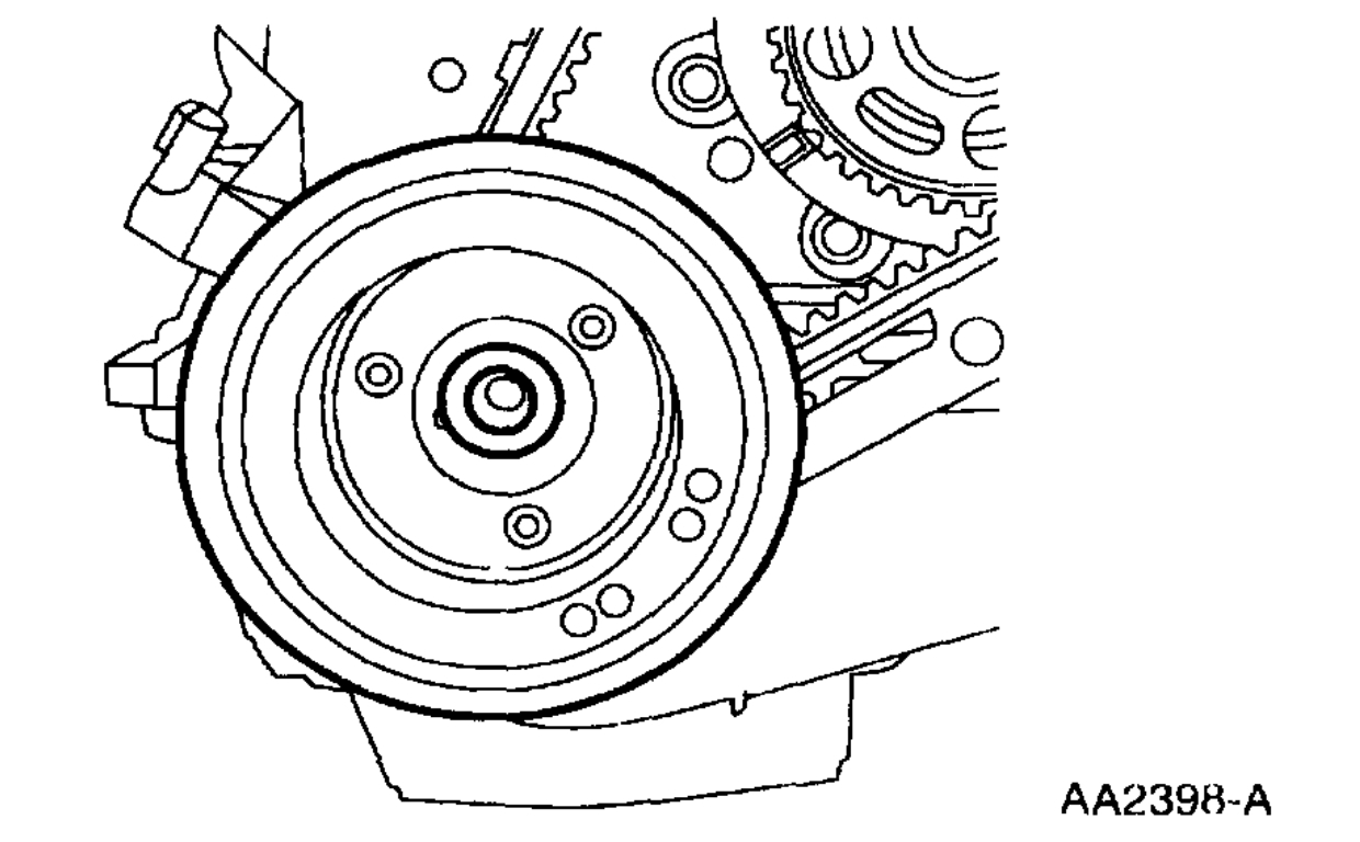

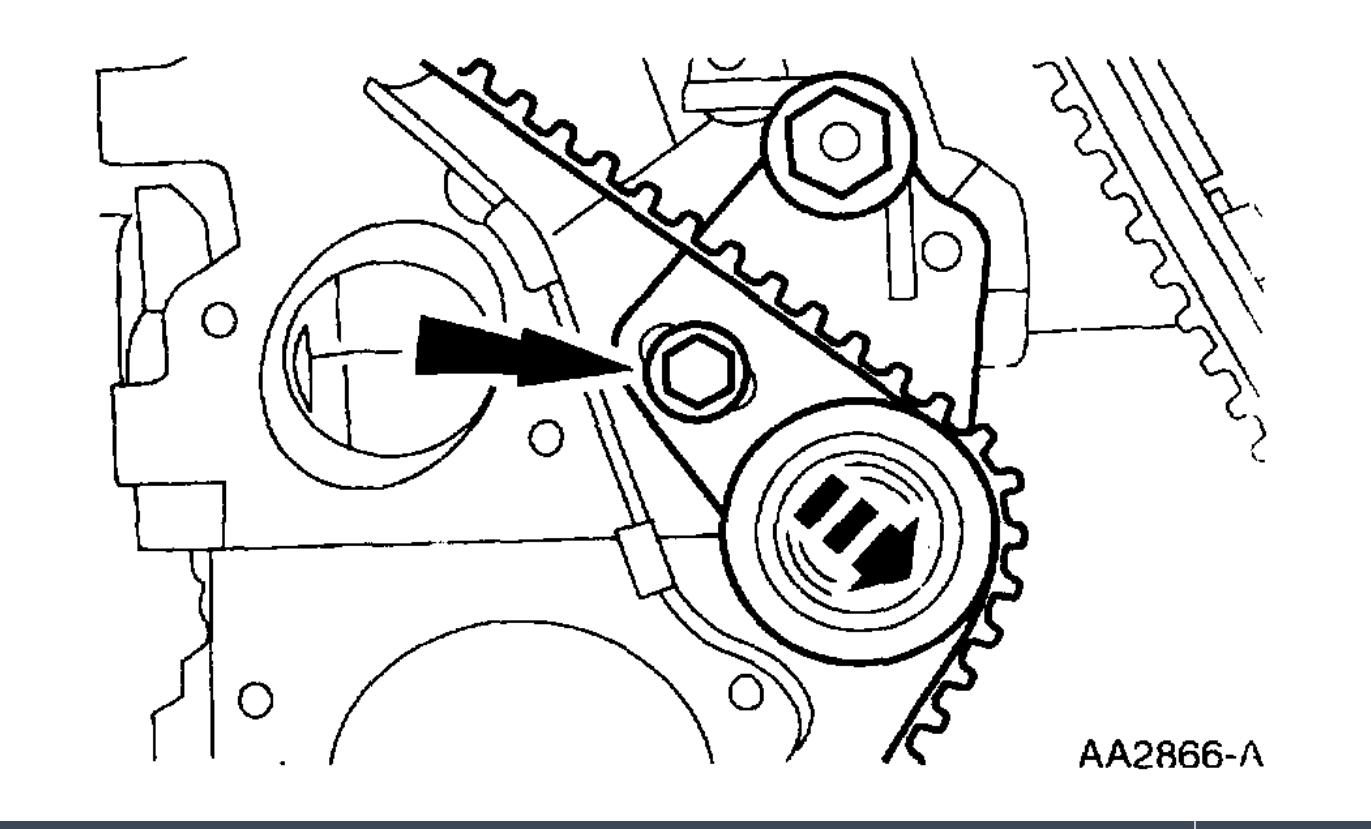

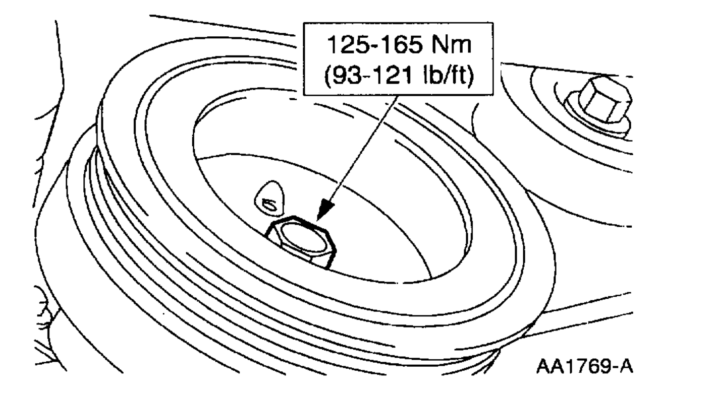

I attached the procedure for you of the replacement of the belt. Let me know if you have any other questions. Check out the diagrams (Below).
Removal
1. Disconnect the battery ground cable.
2. Remove the exhaust side spark plugs.

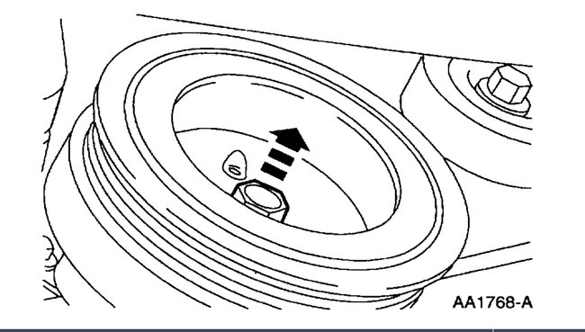

3. Remove the crankshaft pulley.
Remove the bolt.
4. Remove the outer timing belt cover.
5. Rotate the crankshaft until the number 1 piston is at Top Dead Center (TDC).

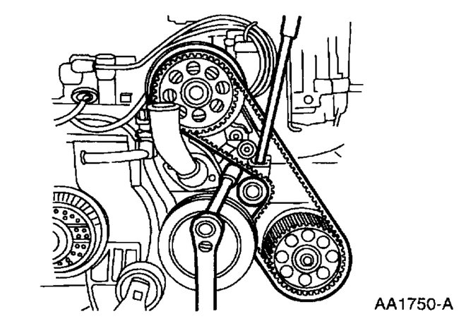

6. CAUTION: If you attempt to remove the belt without loosening both timing belt tensioner adjusting bolt and spring pivot bolt, damage to Camshaft Belt Tensioner Tool could occur when attempting to relieve belt tension.
7. Loosen the timing belt spring pivot bolt. Do not remove.
8. Loosen the adjusting bolt slowly and release spring tension.
9. Rotate tensioner with adjusting tool, against spring pressure, clockwise to the farthest position.
10. Hold in this position and tighten adjusting bolt to hold tensioner away from the belt.
11. Remove the timing chain/belt.

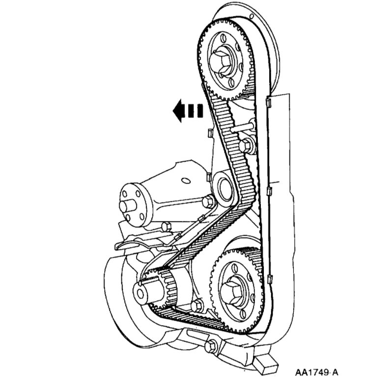

Installation

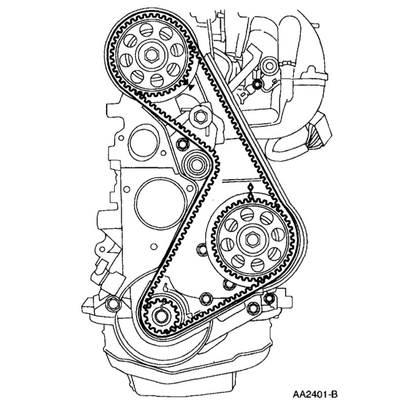

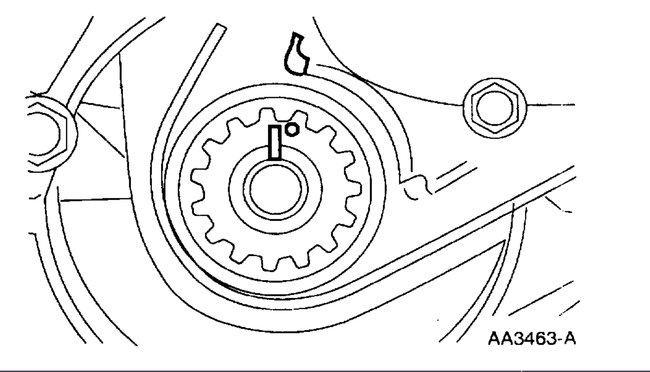

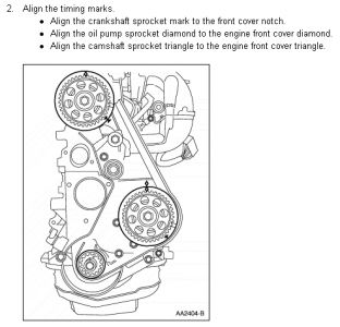

1. Make sure the crankshaft is at TDC on piston No. 1, with the crankshaft keyway pointing straight up and the circle on crankshaft sprocket aligned with notch in engine front cover.
2. Align the timing marks.
Align the crankshaft sprocket mark to the front cover notch.
Align the oil pump sprocket diamond to the engine front cover diamond.
Align the camshaft sprocket triangle to the engine front cover triangle.
3. Install the timing chain/belt over the crankshaft sprocket, proceeding counterclockwise over the oil pump sprocket and over the camshaft sprocket.
4. Loosen the bolt allowing the tensioner pulley to press against the timing chain/belt.
5. Note: The timing belt tensioner must not be tightened or belt tension will not be distributed over the entire belt.
Rotate the crankshaft two revolutions clockwise. Bring crank slowly to number one position firing position (keyway on crank facing up). The dot on the crankshaft gear is aligned with the notch on the front cover.
6. Recheck timing mark alignment. Repeat if required.
7. Tighten the bolts.

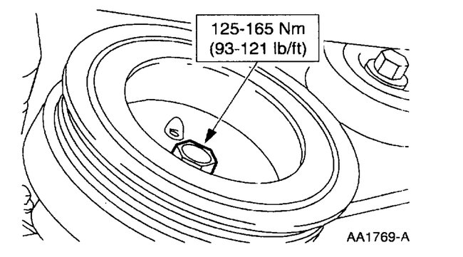

8. Install the crankshaft pulley.
9. Tighten the bolt.

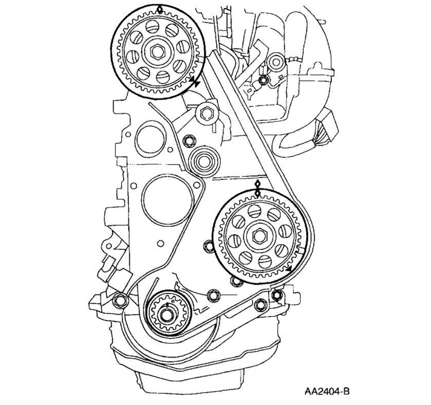

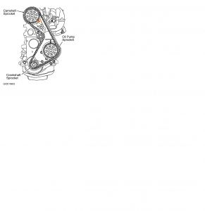

The inner cover has a triangle for cam and a diamond for the oil pump
And there is a diamond and a triangle stamped into both gears (cam and oil pump) make sure you are using the triangle for the cam and the diamond on the oil pump. Otherwise you have no compression

recheck the timing marks make sure u have the correct marks on
https://images.2carpros.com/forum/automotive_pictures/99387_ranger_98_4.jpg

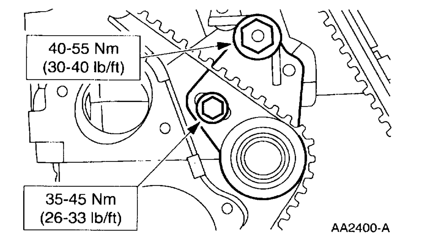

  • 41,812 POSTS
Hi Joshwissehr, Thank you for the donation. To adjust the tension of the belt, the spring for the tensioner is sufficient. However you need to turn the the engine to compression stroke to get the correct tension. After installation and everything tightened, turn the crankshaft clockwise at least one revolution to let the belt settle. Slowly turn the crankshaft until compression is felt. Loosen the tensioner and retighten when the spring tension moves the bearing.
https://images.2carpros.com/forum/automotive_pictures/192750_TimingBelt99RangerFig01_1.jpg

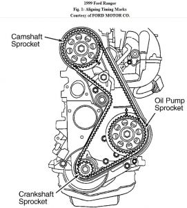

Recently the timing belt on my truck broke. Putting the new belt on I lined up the cam pulley (triangle to triangle), oil pulley (diamond to diamond), and crank to TDC. Tried several times but it is not working. Any Ideas? In addition, it is a four cylinder but has eight spark plugs, the number one access spark plug is the first on the driver side right?
Dec 7, 2020 at 12:44 AM (Merged)
DAVE H
  • 13,383 POSTS

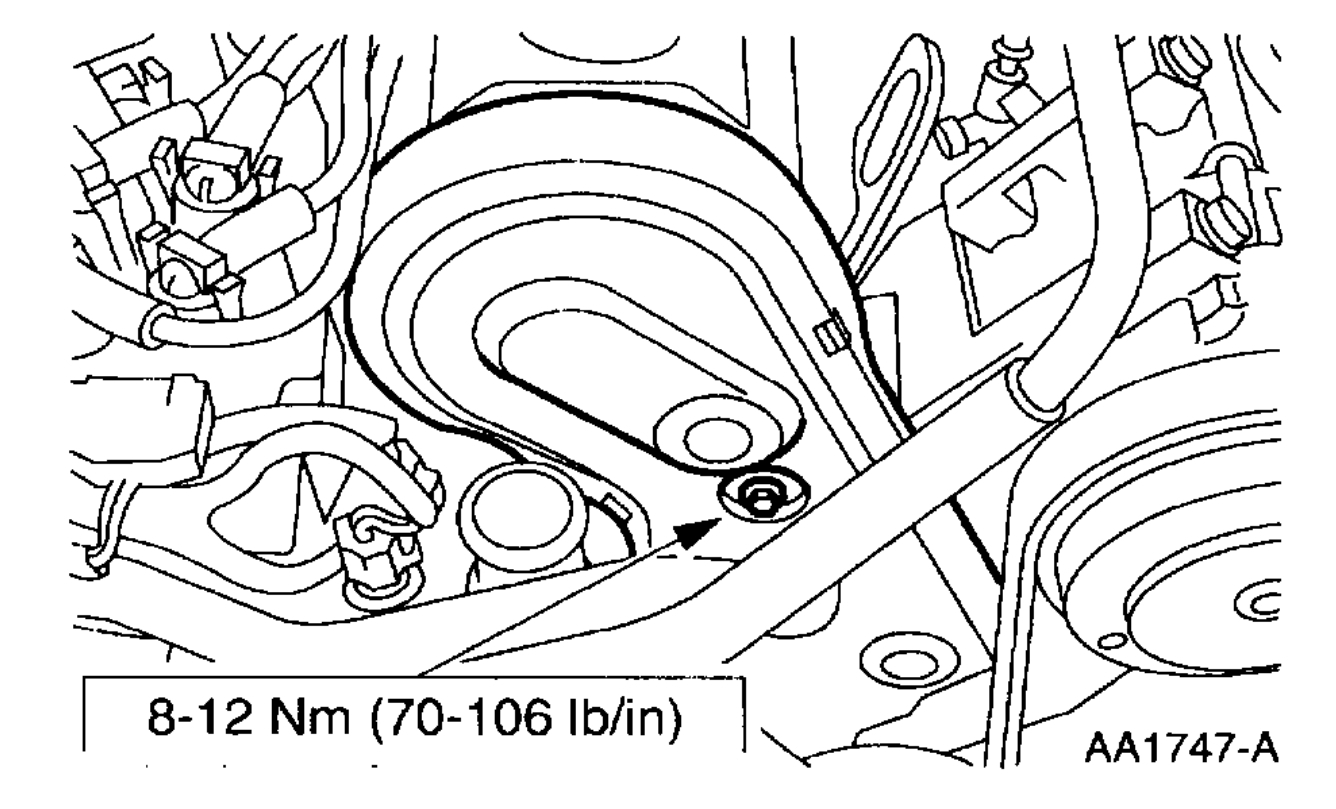

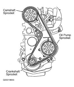

Timing belt removal: Disconnect battery ground cable. Remove exhaust side spark plugs. Remove fan shroud bolts and fan shroud, and position aside. Loosen, but do not remove, water pump pulley bolts. Remove accessory drive serpentine belt. Remove fan and clutch assembly retaining screws. Remove fan and clutch assembly. Remove fan shroud. Remove water pump pulley. On models with A/C, discharge A/C system using approved refrigerant recovery/recycling equipment. Remove A/C compressor from mounting bracket. Remove A/C compressor mounting bracket with power steering pump attached, and position aside. Remove timing belt outer cover retaining bolt. Release seven cover interlocking tabs. Remove timing belt cover. Rotate crankshaft in normal direction of rotation so that No. 1 cylinder is at TDC of compression stroke. Align camshaft, crankshaft and oil pump timing marks. See Fig. 1 crankshaft key-way should be pointing straight up, and circle on crankshaft sprocket must align with notch in engine front cover. Holding timing belt tension-er with camshaft belt tension adjuster (T74P-6254-A) or equivalent, loosen adjusting bolt and pivot bolt. Slowly release spring tension. Pry tension-er away from timing belt, and tighten bolt to hold tension-er in place. Remove timing belt.
https://images.2carpros.com/forum/automotive_pictures/266999_150_2.jpg
Installation: Ensure crankshaft is set at TDC and camshaft sprocket timing mark and oil pump sprocket timing mark are aligned with inner cover timing marks. Install timing belt on crankshaft sprocket, oil pump sprocket and then the camshaft sprocket. Loosen timing belt tension-er bolt. Allow tension-er to adjust itself against timing belt. Do not tighten belt tension-er. Slowly rotate crankshaft clockwise 2 complete turns clockwise (as viewed from front of engine) so No. 1 cylinder is at TDC of compression stroke. Recheck timing alignment marks. If timing marks are not aligned, re-position timing belt. Repeat timing belt tensioning procedure. Tighten timing belt tension-er adjusting and pivot bolts to specification. See TORQUE SPECIFICATIONS: Install crankshaft pulley. Tighten center bolt to specification. Install timing belt cover. Install exhaust side spark plugs. Install A/C compressor mounting bracket to engine. Install A/C compressor to mounting bracket. To complete installation, reverse removal procedure. Recharge A/C system, if necessary.
https://images.2carpros.com/forum/automotive_pictures/266999_1502_2.jpg

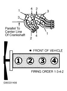

You have the timing slightly out still put a thin screwdriver into number one plug hole rotate crankshaft clockwise so that the piston is on the rocking point between up and down. it needs to be right at the top point at the end of the up stroke before it starts to go down again. here is a better picture of the timing marks. I hope this helps. let me know.
https://images.2carpros.com/forum/automotive_pictures/266999_ranger2_1.jpg
https://images.2carpros.com/forum/automotive_pictures/266999_ranger3_1.png

It does not matter which plug hole you use on number one cylinder as long as it is at TDC and all of your marks are lined up. ow battery power could be causing the rough running install the belt. i would not expect it to cause real rough running if all your mark's are set up correctly (right on the marks) then your timing is correct. check all your leads are correctly routed and seated on plugs. plugs are tight. also, check vacuum pipes . does the vehicle sit and idle now? let me know.

FORDCRUSHERDREAMS
yes funny your diamond to triangle on the cam is wrong the diamond to diamond on the oil pump and the crank at TDC compression stroke are correct, but the cam is wrong. there is a little flat lip on the cam plate line the triangle at the bottom part of the lip an the rotate the cam counter clock wise one tooth and then put the belt on. this is for a 2.5 98 ford ranger.

It sounds like its 180 degrees off be sure the no 1 cylinder is at tdc.
BMRFIXIT
  • 19,053 POSTS
https://images.2carpros.com/forum/automotive_pictures/99387_ranger_98_1.jpg
recheck timing marks do a compression test and a cylinder leak test

What it was it the cam shaft has # marks on it a notch , Diamond, and an arrow head the stupid FORD book say like up the marks and you can barely see the arrow and they ASSume You know to use the arrow.... A****** did this on purpose i had to use a $80 timing book to figure this out.. Thankx all HOPE this helps someone down the line. it sux taking the belt off 20 times :-( Anth
