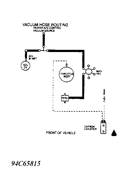

FLYDORK20
K I've only checked the fuel pressure because I started with that and when I did it seems high. I get 59-60 key on. When it's at ilde I get 68-70 supposed to be 35-45 right? Also when I disconnect the vacum line to the regulator theres no change.(I don't know if thats a problem though) Is that my problem you think? Or is it one of many? I haven't done anythiing else cause I figure I'll just fix stuff as I go that isn't correct. Thanks!

PEPPERMRJ
  • 1,158 POSTS
Have you done a vacuum test? Plugged Cat?

FLYDORK20
Vacuum check is good, and I just bought a brand new cat with an exhaust. I did that about 2 months ago hoping that would fix the problem. I've got that portion covered. What do think about the Hi fuel pressure?
